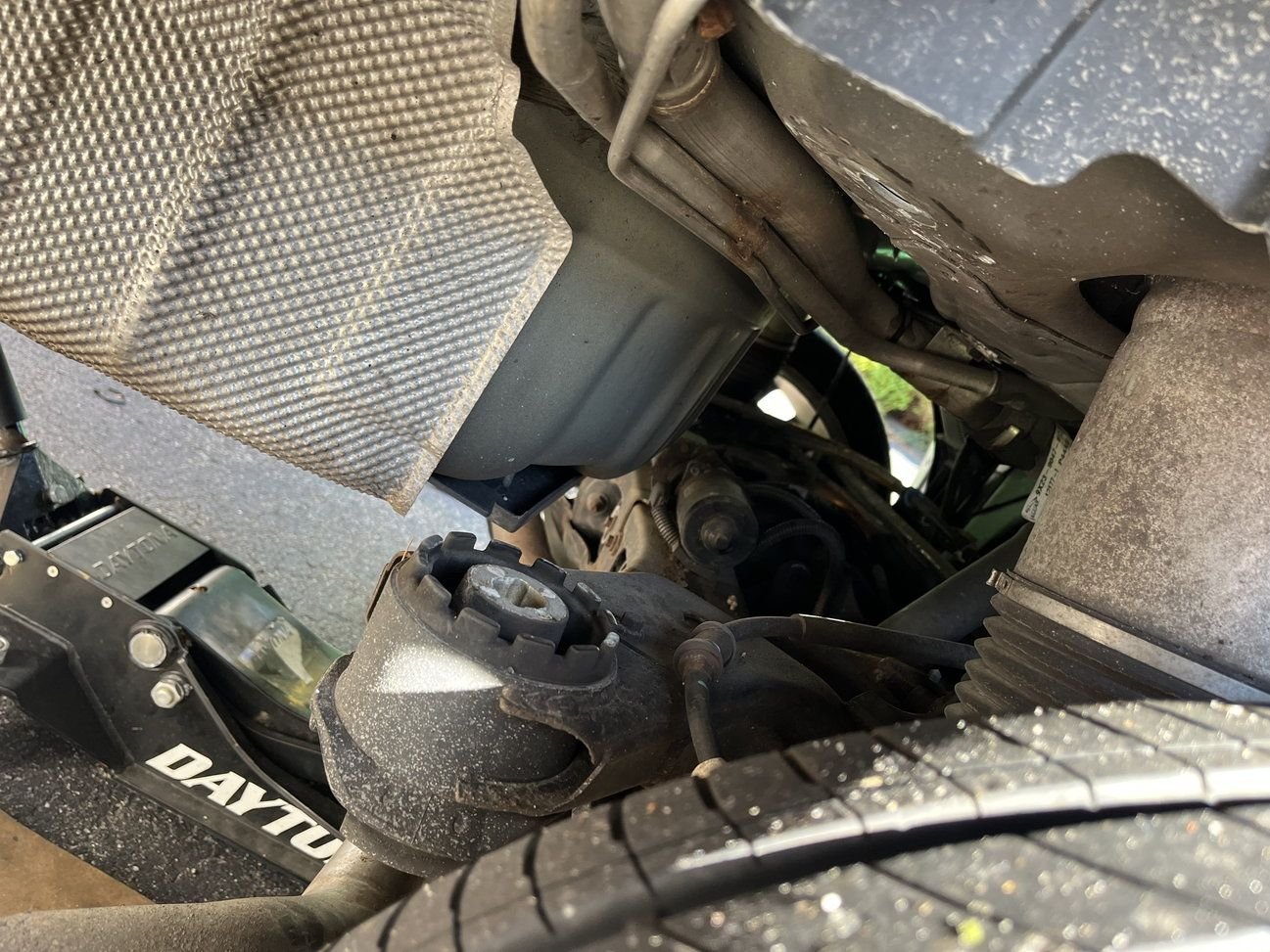

Sorry no help but your car looks great for being in the salt belt up in Mass.!
Underneath has hardly any rust on the hardware and just the threads rusted up a bit.
Oh one question? Since we saw a lot of corrosion up thread on another car. What did your plug look like? Any corrosion?
Thanks for responding I felt alone with this miserable repair haha.
There are shields that for the most part keep a lot of the rusty stuff at bay. But car did spend a few years down in Florida. It’s got 113,000 on the clock.

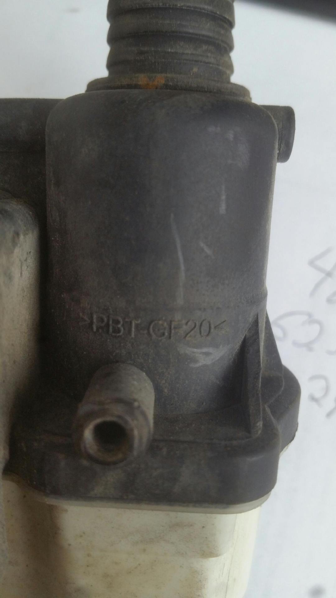

About the connector it looked fine on the pump so I reluctantly chanced it not inspecting the harness connector. Which to really inspect you much uncap it and dismantle it. Otherwise things appear ok. Hard to explain but the pic of the original posters the connector is split open so you can see the little female pin connectors, lesson learned. Luckily the state inspection doesn’t come around till august of next years. I was able to repair and clear codes and put enough miles for memory to store and pass the state smog tests. Which is making me scratch my head did the new pump fail that quickly? Defective? Not sure. Now the light comes on instantly😔. I did not replace the filler tube as suggested but if it’s a hard pipe what does it actually fail on it? I’ll need to unplug and remove the cover from the connector to inspect. Just looking for alternative ideas.
