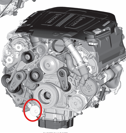

question, this is a supercharged engine, does the intake manifold create any vacuum? Maybe there is a vacuum pump?
Well technically it (the intake manifold) doesn't create a vacuum, but it wouldn't work without it.
And there is a vacuum pump, on the front of the engine just to the left (as you're looking at it) and slightly below the crank shaft pulley.
