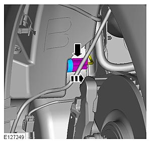

If you really do have a full washer bottle (so not a leak) then it does sound like a faulty sensor. To get to the bottle remove the RH road wheel and the wheel arch liner. all the screws are visible (plus some 10mm nuts at the rear). The pump is on the bottom and the sensor is behind the bottle about 6" up. Refer to the attached drawing for the location (pump shown removed).
If you plug the hole, or drain the bottle, you can activate the switch manually to see if your warning lamp changes. If it does it's likely the switch, if not post back and I'll look up the wiring schematic so you can test that.
The sensor is C2S4061. Same as the last XJ (X350), X-Type (X400), XF (original X250 version), and your XK. Should be stocked by most dealers at around £20. Do not buy from eBay - they are priced around 300% the dealer cost.
You can get to the level sensor without taking the wheel off - just turn the steering to full right lock, and remove the clips from the back of the wheel arch liner. You can then reach in through the small gap to the water level sensor. It's a bit fiddly, so I'd suggest doing it with the water bottle empty as you won't be able to plug the hole.
