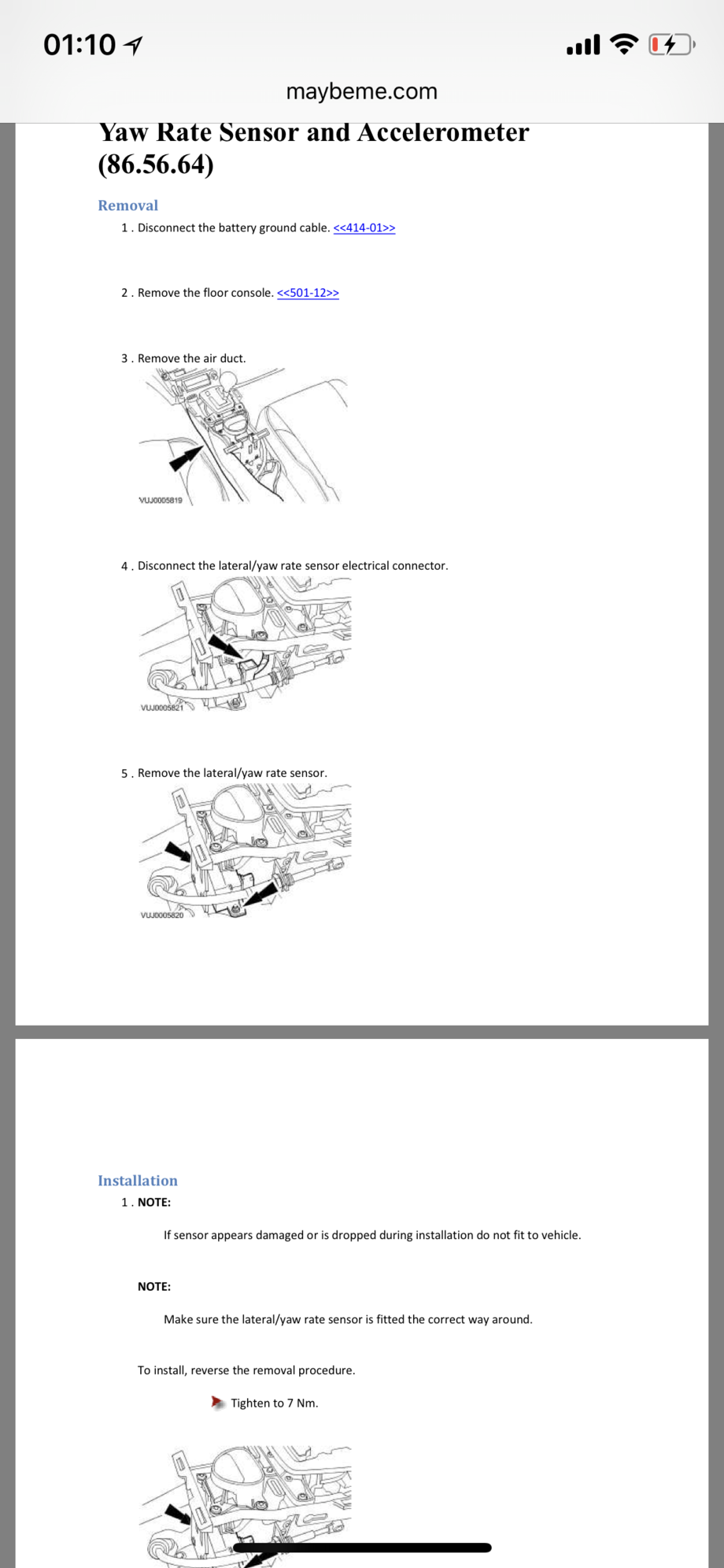

Yaw sensor location, thise often result in dsc warning light. Its under the center console.

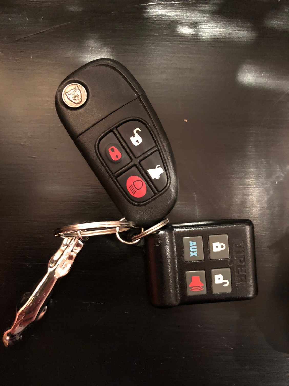

Does anybody know why there is two keys like this? Is it maby a valet key? Or what is it?
Old Sep 19, 2018 | 05:12 PM
meirion1's Avatar
Joined: Nov 2009
Posts: 3,145
Likes: 805
From: The beautiful Mornington Peninsula in OZ
It's a key for a VIPER

I found out noe that its a extra key with alarm and so on.

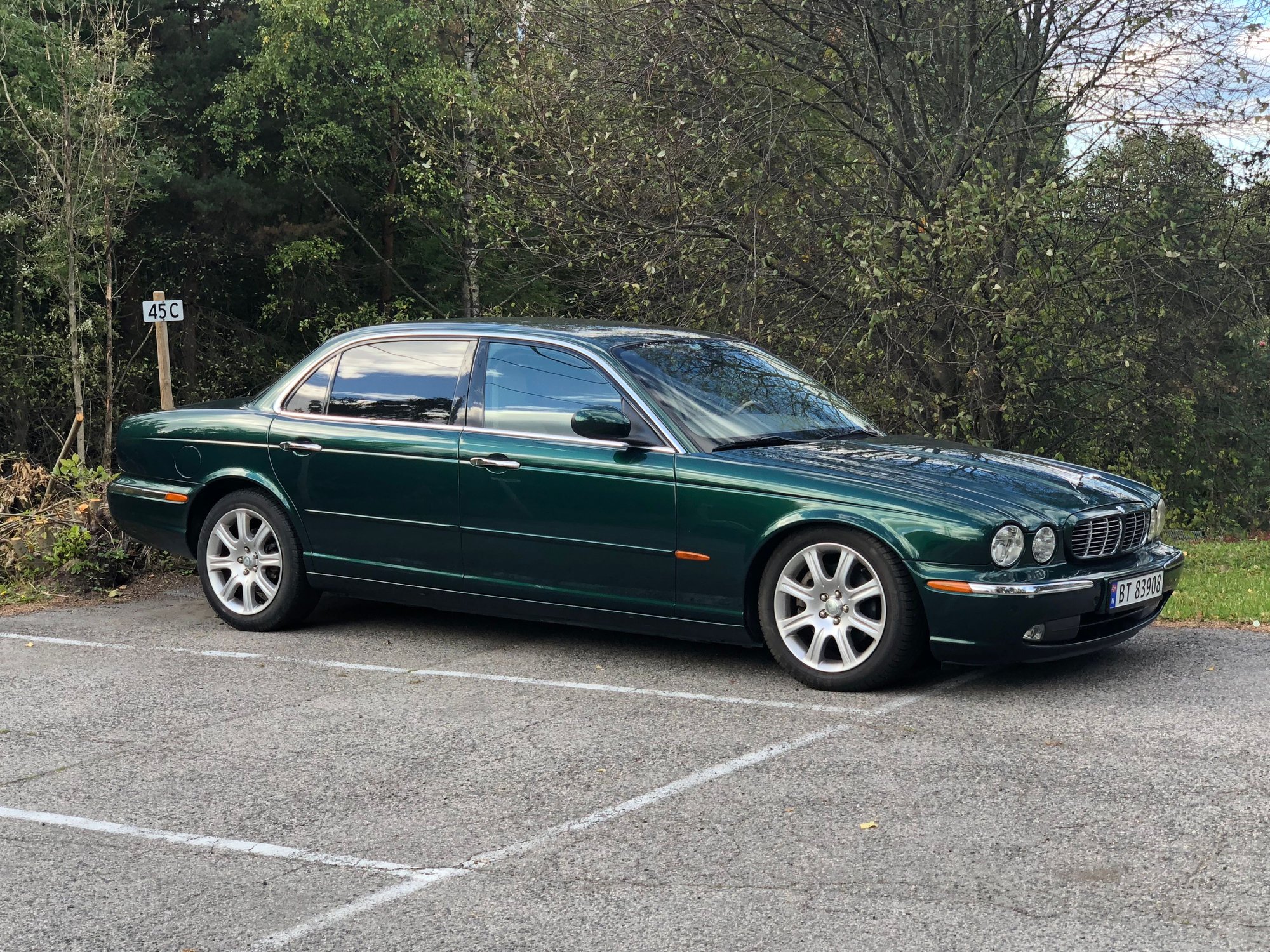

Anyway this is how the car sits after driving it yesterday, its low in the front. I sprayed the top of the suspension but did not see any leaks. Will look inside the wheel well on the rubber if its okay or broken.
i have read it might be the solenoid in the trunk near the tank, because if that leak its hard to see as the seals inside of the solenoid may be dry make a bad seal. Because my car leaks very slow.
Photo of the car today. Low at the front. So must be either solenoid valve or front struts/suspensions.
what do you think?

She is a beauty!! That is exactly how my 04 was sitting the morning after I purchased her. Surprise for me!! She would then leak down (only in the front) when left sitting for about 8-10 hours during the day and also overnight. I left it for about 2 weeks and then heard a slow leak on the passenger side one morning. I replaced just the one side with an Arnott replacement (I think it was the AS2710). I fully meant to replace the other right after, but it has been 2+ years and I still have not got to it. If I had not heard which one it was I would have gone ahead and done both. You may be able to hear the leak after you park her. I would certainly check all the fittings with soapy water.
You are right about losing the "sport" suspension if you do away with the air and I believe the setting also affects the shift points somewhat. I do not know what else happens if you do away with the air although many have and do not regret it. Also I certainly would change all 4 if that was the course I chose. (Believe me I have thought about it.)

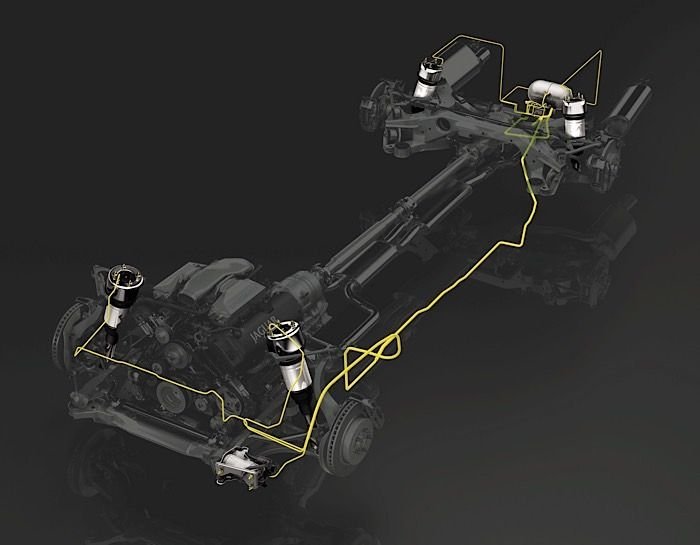

I just wonder, if the system leaks at the front. And makes the car lower at the front. Will the car detects hight difference front and rear, and adjust down the rear suspensions to have simular hight as front?
Found this diagram, good to use if you have the same problem and wonder how the system is linked together

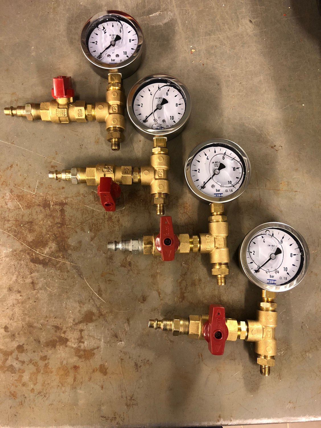

So i have made a testing set. 1/8 connection for the 4struts. Will test them and see if anyone leaking. If they leak i will see fast. If not problem is another place

Okay, so i found a leak on the front left suspension. Put the pressure up to 7:5 bars and it sunk right away down to 5 and stopped. The other side dropped to 7bar. I replaced them with RMT rebuild ones on both sides in the front. Everything was fine and i drove the car some to test and everything looked fine.
I let the car stand for two days without seeing the car had been low, so guess it was okay.
