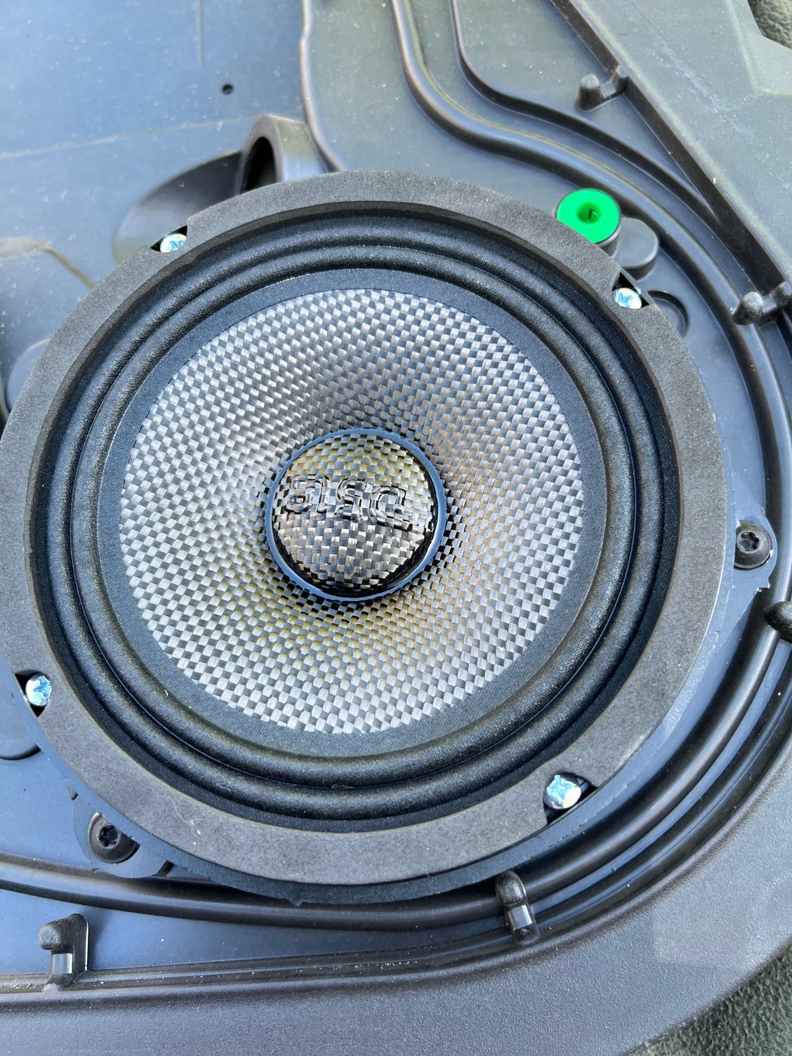

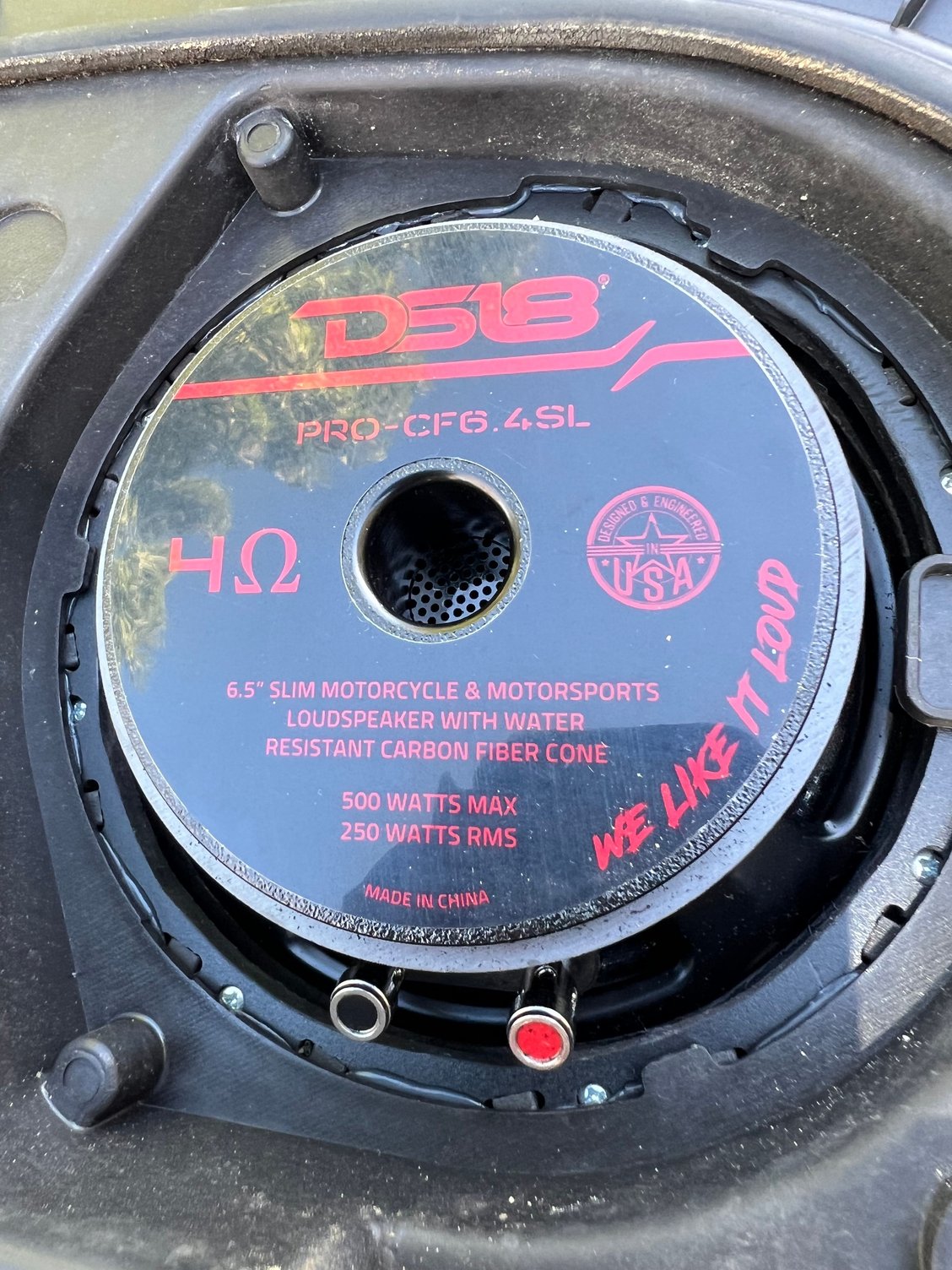

I’m currently replacing all my door lock actuators and while in there I decided to replace the standard door mid-bass speakers. The original audio system sounded awful. Likely a few of the door speakers were not fully operational. After deciding to replace them I did not spend a lot of time testing what issues they had.

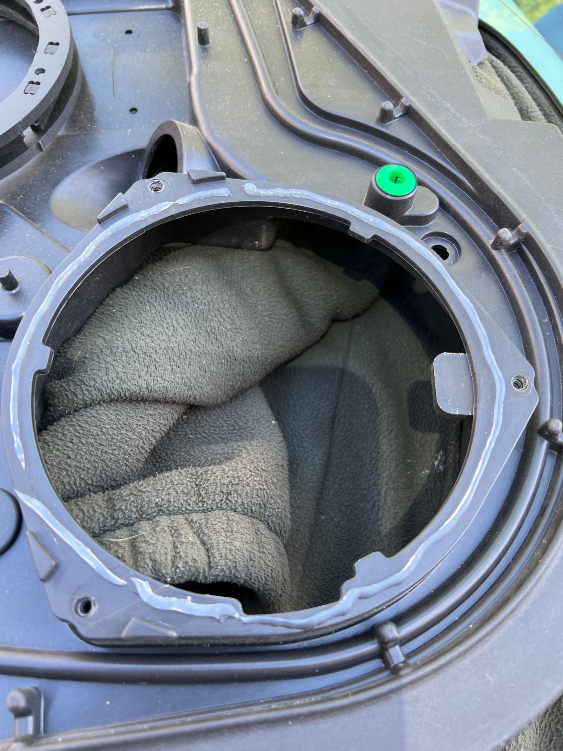

I purchased the speaker adaptors (as mentioned by other posters) but had to run a dremel around the inner lip as the new speakers were slightly to fat. The adaptors allow for this.
I ran a line of silicon before mounting the adaptors (as they recommend) and the speakers were easy to fit.
One thing I noticed was the old speakers are as light as a feather (!?) the new ones feel like almost a couple of pounds each.
I was conscious of not exceeding the size of the original speaker depth to avoid any issues so went with a set of DS18 PRO 6.5" Slim Mid-Bass 250W Speakers w/ Carbon Fiber Cone.
These cost AU$380 excluding delivery.
I was blown away by the results. Just playing a selection of tracks from various CDs in the single in-dash system the sound quality was amazing !
