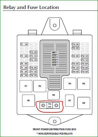

Where is large power fuse located?
thanks in advance

I use one 80A fuse in front fuse box:
One can use "mega fuses" as well, they are somewhere in vicinity of battery in the trunk.
