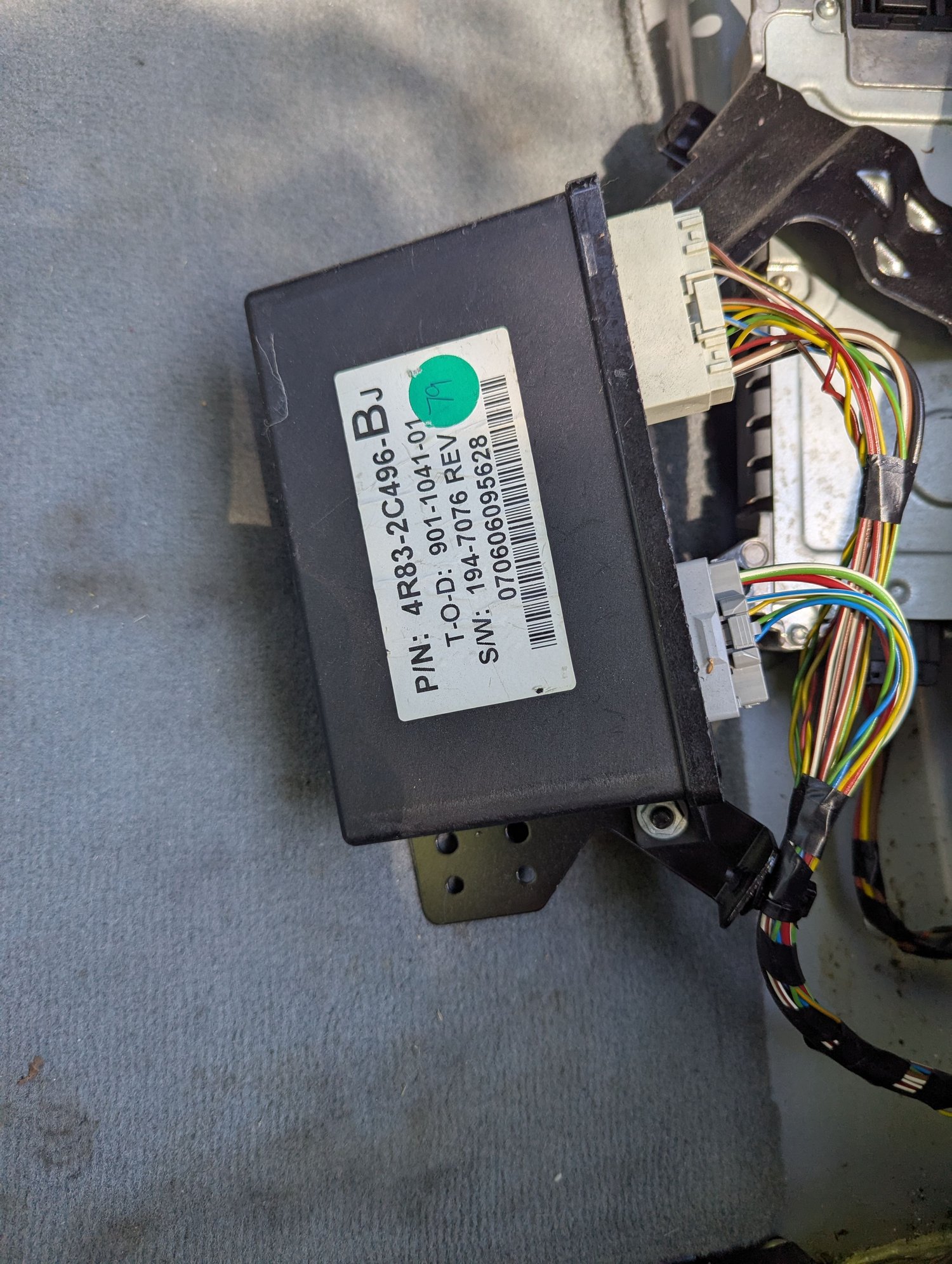

I have a constant fast chime while driving due to EPB failure..not repairable. I read a suggestion to disconnect plug from Rear Electroncs Module on right side trunk..but there are 6..one one each side and 4 on bottom. Any idea which is related to EPB?

Realize it is behind the Rear Electronics Module...Anyone know which connector might solve fast chime issue?

OK...I pulled grey connector...still dings...pulled tan connecter and threw EPB module into neighbors pool ( if you own a vintage BMW you will understand the ref)..after tan removed, no dings!!!!!!!!! But I lose cruise control, which is totally retarded in design because not even adaptive which might require EPB to slow car..but losing cruise is a price I will easily accept!
Meant to clarify, Rear Electronics Mod just needs to be romved to get to EPB mod
