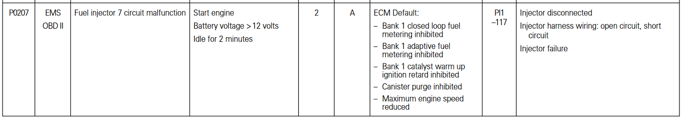

Sorry to join your thread late. P0207 indicates a problem with the cylinder 7 fuel injector electrical circuit or a failed injector. It probably does not mean that the injector is dirty. The inoperative fuel injector is probably the cause of the P0307 and P1316 misfire codes.
Here are the P0207 definition and possible causes from the DTC Summaries that Bob provided:

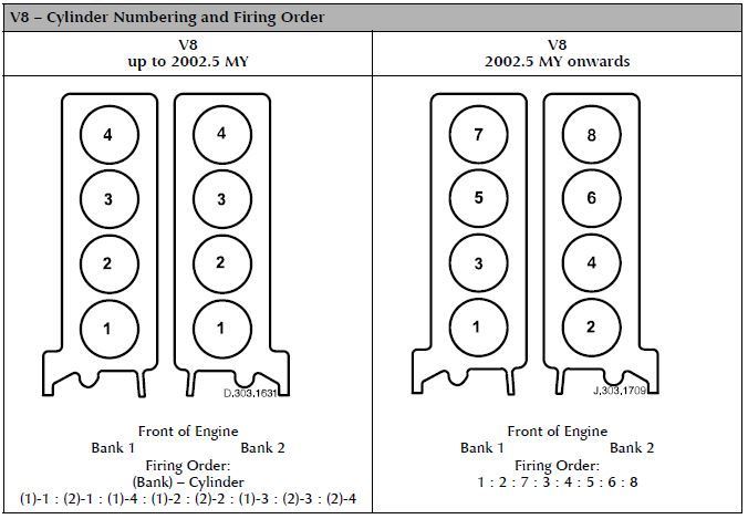

Here is the cylinder numbering diagram for your engine. Cylinder 7 is closest to the firewall/bulkhead on the right side as viewed from the driver's seat, or left side when viewed from the front of the car:
Check the wiring at the fuel injector to confirm that the electrical connector is firmly seated and the wiring is in good condition. It is not uncommon for rodents to chew the wires, or for the insulation to harden and crack with age and thermal cycling. The plastic electrical connector shells are also known to become brittle and crack.
