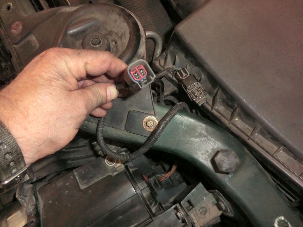

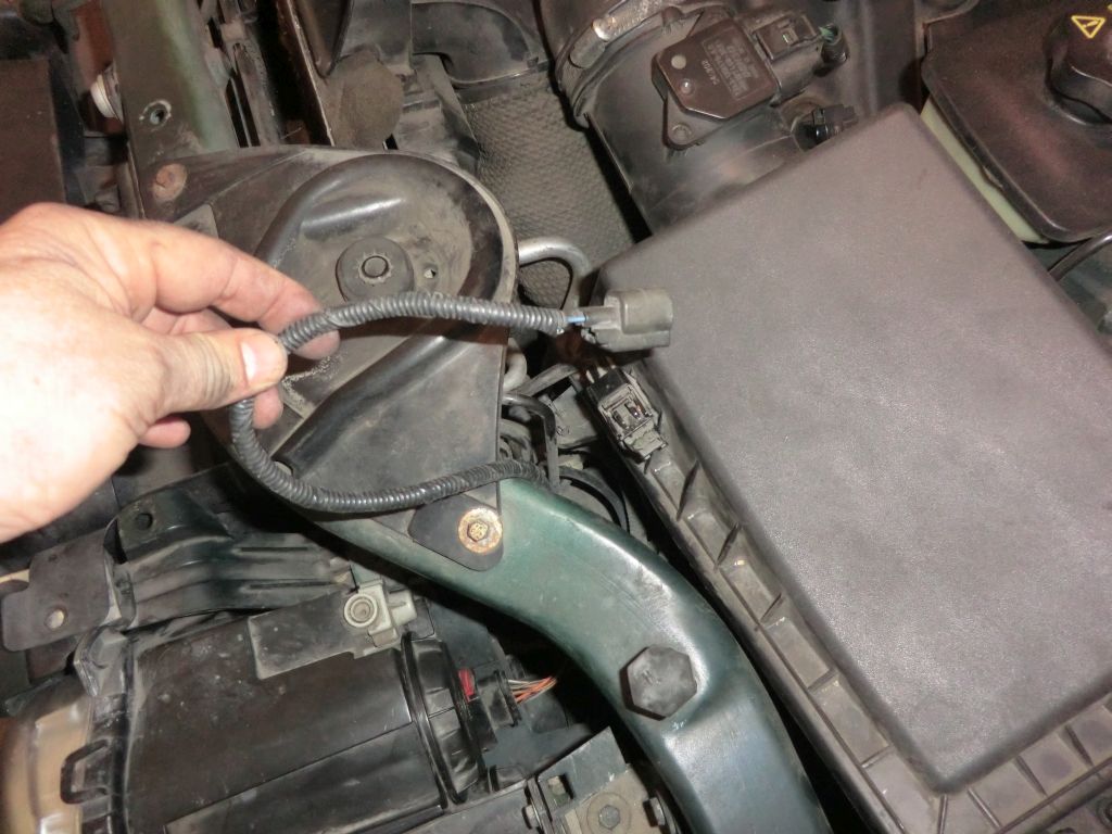

Found non connected 2 core connector by front of car.
I was changing out some bulbs in the front of the car when I came across this cable and wondered what could/should it be connected too?

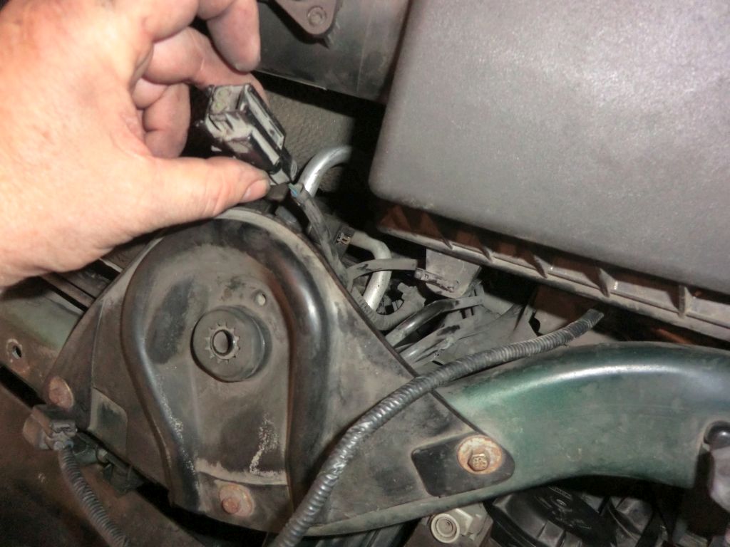

It is a 2 core cable and it doesn't have plastic cover on it (unlike this other one I found close to it). The cable colours are blue and black which are the same as the other sealed connector?

Omg.... It was the bonnet release catch indicator. Somehow I had removed it and placed it beside the airbox. Why, I have no idea, How, I have no idea?
