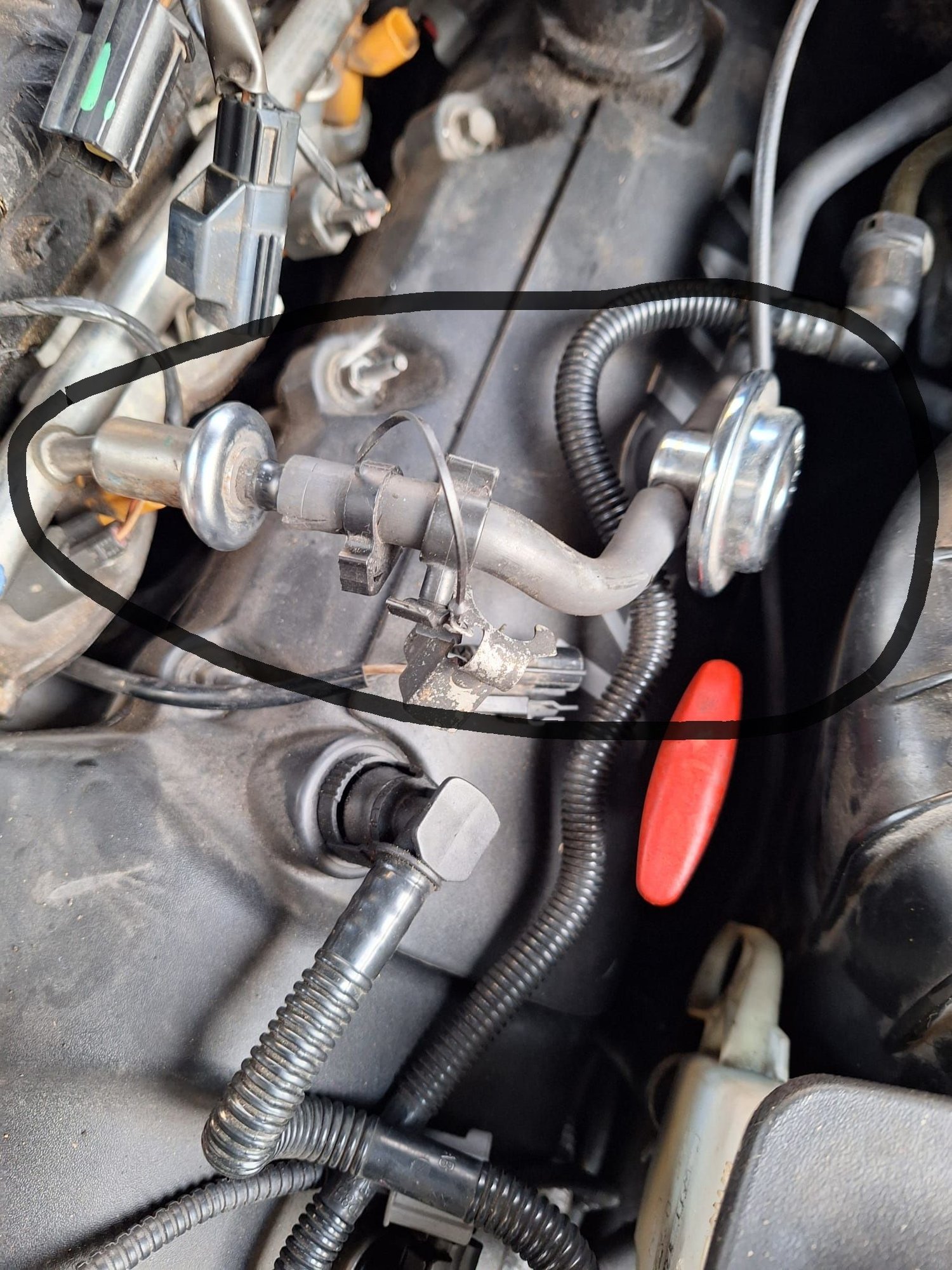

Searching for help. I'm in the process of removing the intake manifold to renew the hose underneath it. The car is a 2004 X350 4.2.The manifold is disconnected from the rest exept for the fuel line. It seems to consist of a fuel line with a regulator in the middle. I can't see how to disconnect it without breaking something. There must be a way. Any suggestions?

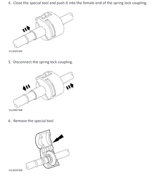

I am not sure that any fuel lines goes to intake manufold. May be lines from breather... fuel line goes to fuel rail via pressure regulator, I think
However, if you need to learn how fuel line quick connects work:

This is what I meant.

Thanks, that's the same as on my car. Appreciated.

The cylindrical piece on the left of the photo should be the spring lock. As mentioned there's a tool set used to release these connectors.
The regulator is permanently installed in the line set, you don't disconnect that or the rubber/plastic hoses.

Thanks again, I was able to cut a piece of thick plastic and wrap it around the base. Then simply pushed and I was able to disconnect the regulator.
