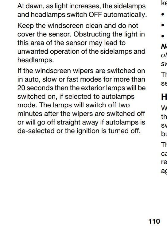

Hi Thomas,
Looking at the owner's manual, the auto lights are connected to the auto wipers.
Page 110.
Auto lights and wipers
Kind regards,
Pete M

Hi Pete,
well, I stand corrected
Why I have never noticed the function?
In the manual of my car (an early X350 SV8), it states that the exterior lights will be switched on when the wipers are in "slow" or "fast" modes only, whereas your manual also states that they will be switched on with the wipers in "auto" mode, as well. It seems that Jaguar has noticed how thoughtless it was not to include the "auto" mode of the wipers, as well, and has added it for one of the facelifts.
Also, I have never noticed the function because 20 sec. is quite a long time, and by then quite often I have already switched on the exterior lights manually when I think that the rear lights would be useful, as well. Also, I have never seen the lights symbol being switched on in the instrument cluster, which I would have expected to happen when the exterior lights are being switched on with the wipers on.

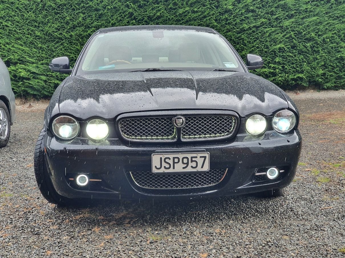

Hi Thomas,
My daytime running lights act as if the headlight switch was on in the low beam position. The tail light LEDs are illuminated.
I have converted my front HIDs to HID-compatible LED, and the high beam halogens to LED. I changed the fog lamps to LED, with 'Angel Eye' surrounds.
The park lights are LEDs and I have added LED rope around the inside of the grille. This looks quite interesting at night.
Full LED front lights

Hi Pete,
looks interesting, but they are also all mods that are not allowed here in Germany, if the parts you install (and this includes the LED bulbs, for example) do not have an official release and certification for your specific car model. And if you install parts withour this release and the appropriate certificate, you can get huge trouble, up to the point that the police grounds the car...
As these certifications are quite expensive to obtain for the manufacturer, they don't do it for cars that are quite rare.
Conclusion: my car remains standard, modifying the lights is not worth the hassle.
And yes, I have checked and my daytime running lights act the same way as the ones on your car. That was probably possible here, as well, because Jaguar used the normal headlights for this function, and not additional daytime running lights, as many car manufacturers did, because in that case only front lights were allowed by law.
