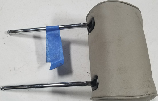

Does your headrest look like this?
Regards,
Steve

He may not know which version he has. I posted the photos since it shows X308 headrests with an obvious slot in back for adjustment.
If he replies that his do not look like that then he does NOT have an X308.

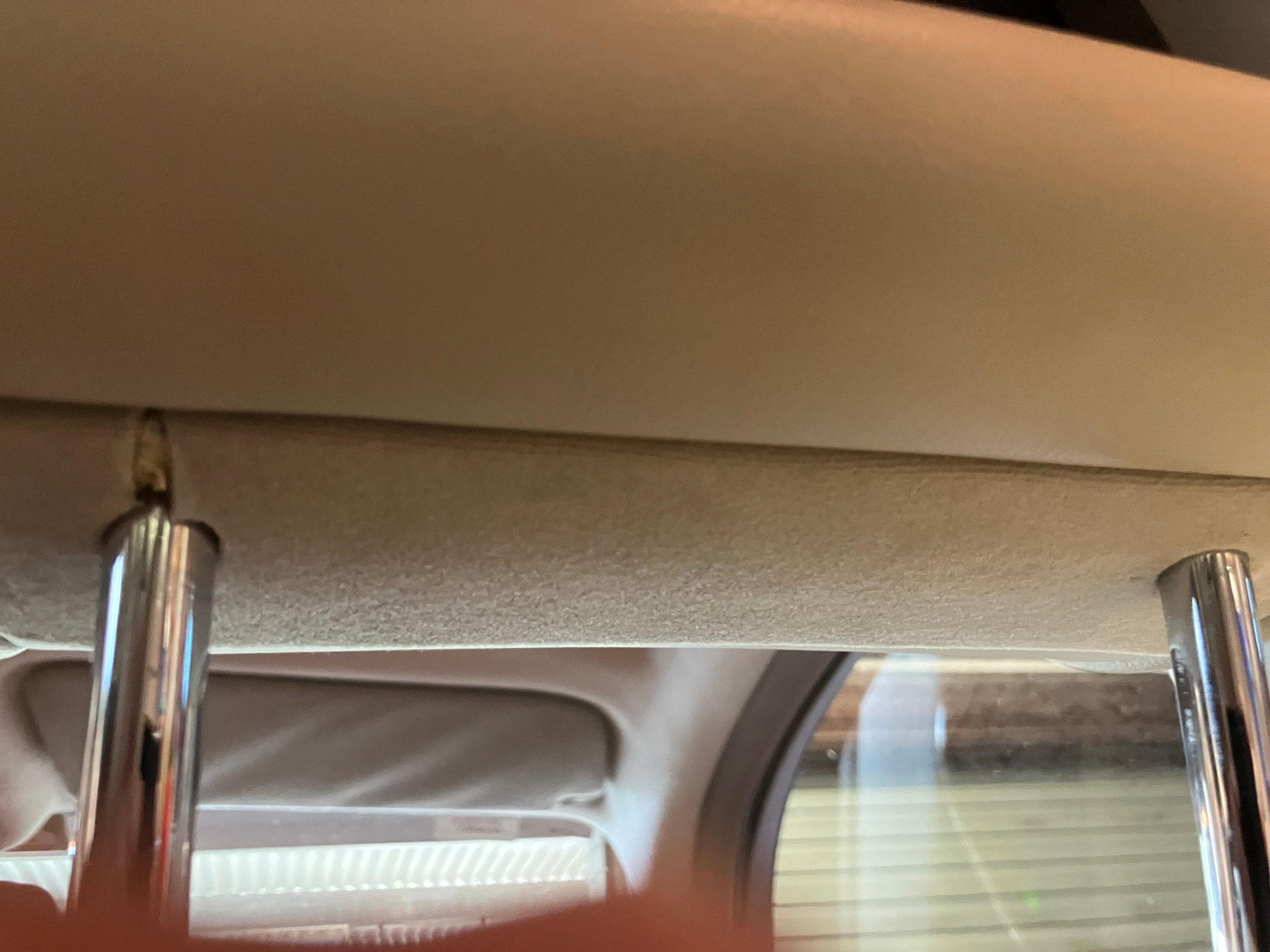

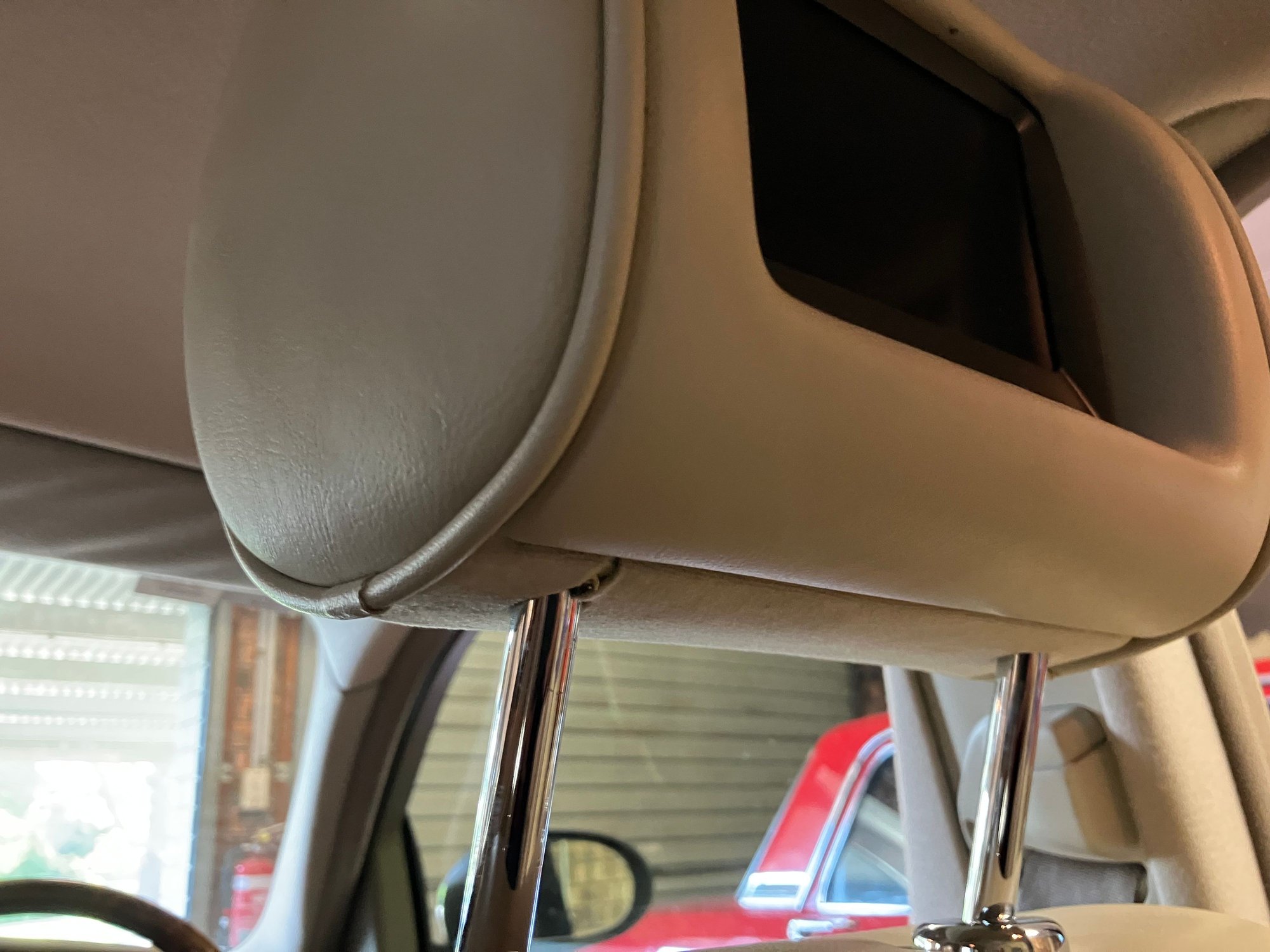

Hi Guys, Typical me 1st post and its on the wrong forum. My appologies. I can however confirm that I do have an X350 so I dont know if the moderator can
move to the appropriate one or should I just go with this thread.
Attached are some shots of my headrests and clearly there no slotting

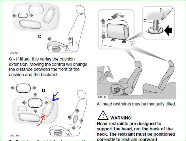

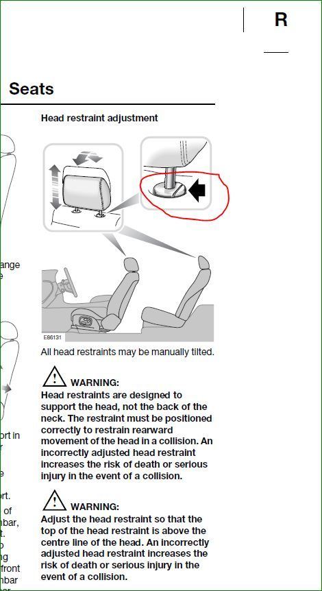

Front seat headrest pivots on it's 'legs' somewhat, it does not fixes in any position but 'default.' The front seats headrests are powered as far as HEIGHT goes and are activated by pushing indicated button up or down:
The rear headrest has a lock; The lock is only one 'leg' the outward one Does this help?
