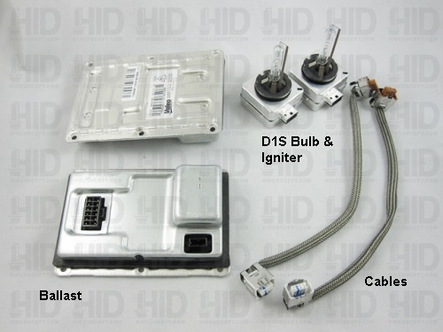

The Ballast is mounted on the underside of the headlight assembly. The square box on the bulb is the Igniter. The shielded cable runs from the ballast to the igniter. The bulb/igniter is one unit.

Ah ha, thank you very much. Makes sense now.
