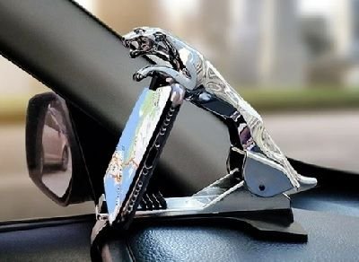

You NEED this !!!

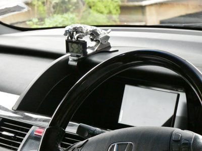

It's Not My Fault (my Honda van), but at least I can feel better about it. Who cares about a cellphone.
(Japanese Import Honda's clock is GPS-synchronised to Japan only, so I fixed that!)

I hate the tracking devices, but I use WAZE navigation to avoid traffic jams and for when the outdated Jag Nav is driving through fields. I already have a holder designed exactly like that without the cat. So, clearly I had to upgrade. Be here in a couplea weeks. Kidding aside, thanks for posting the pic.
