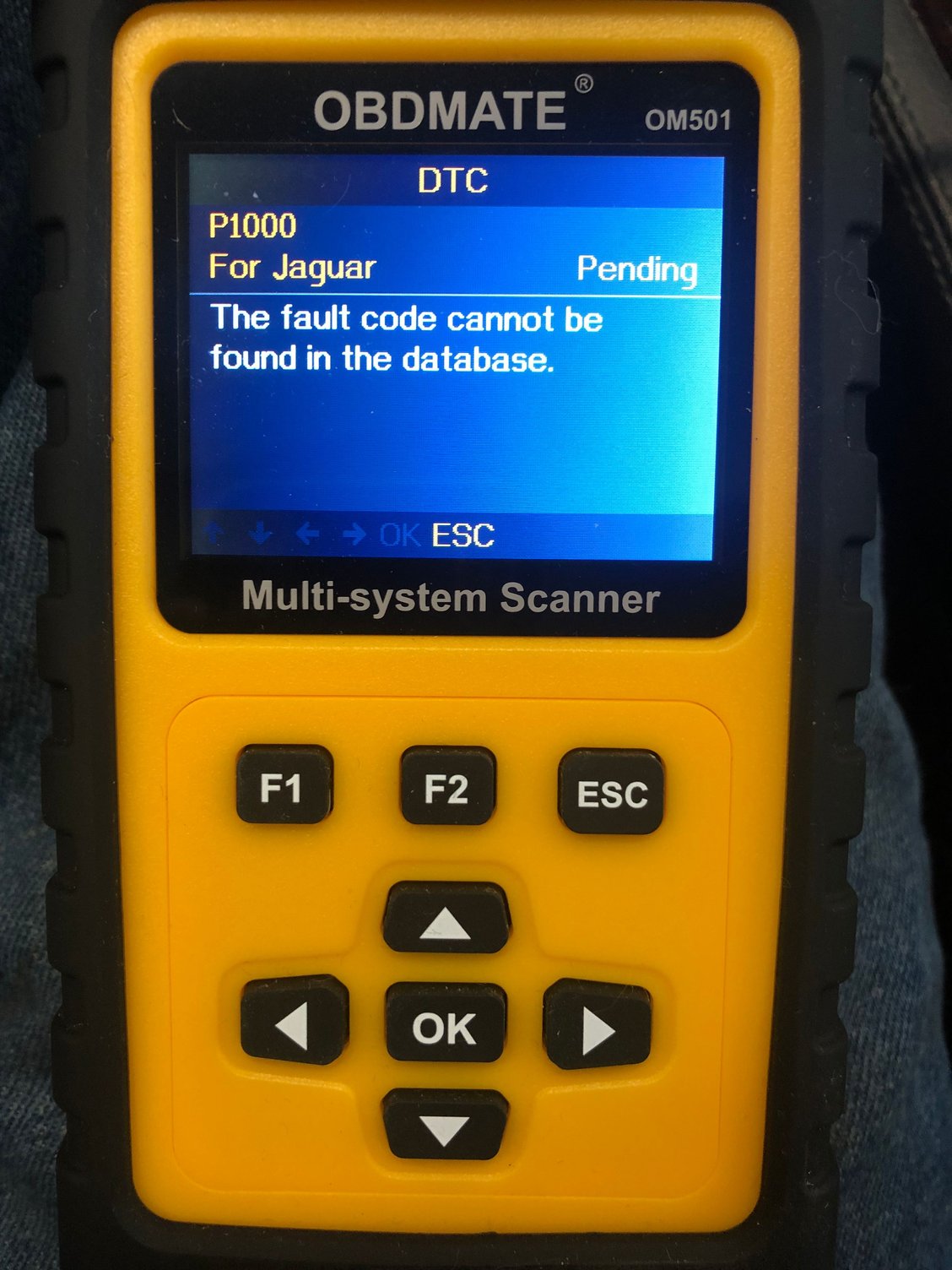

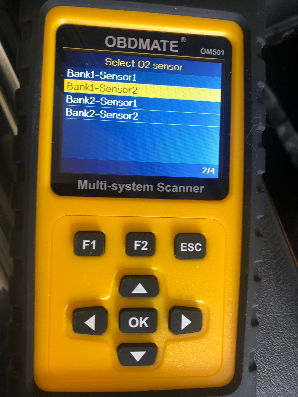

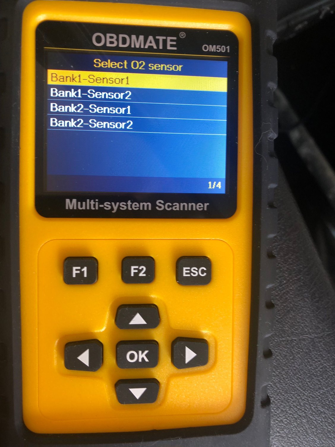

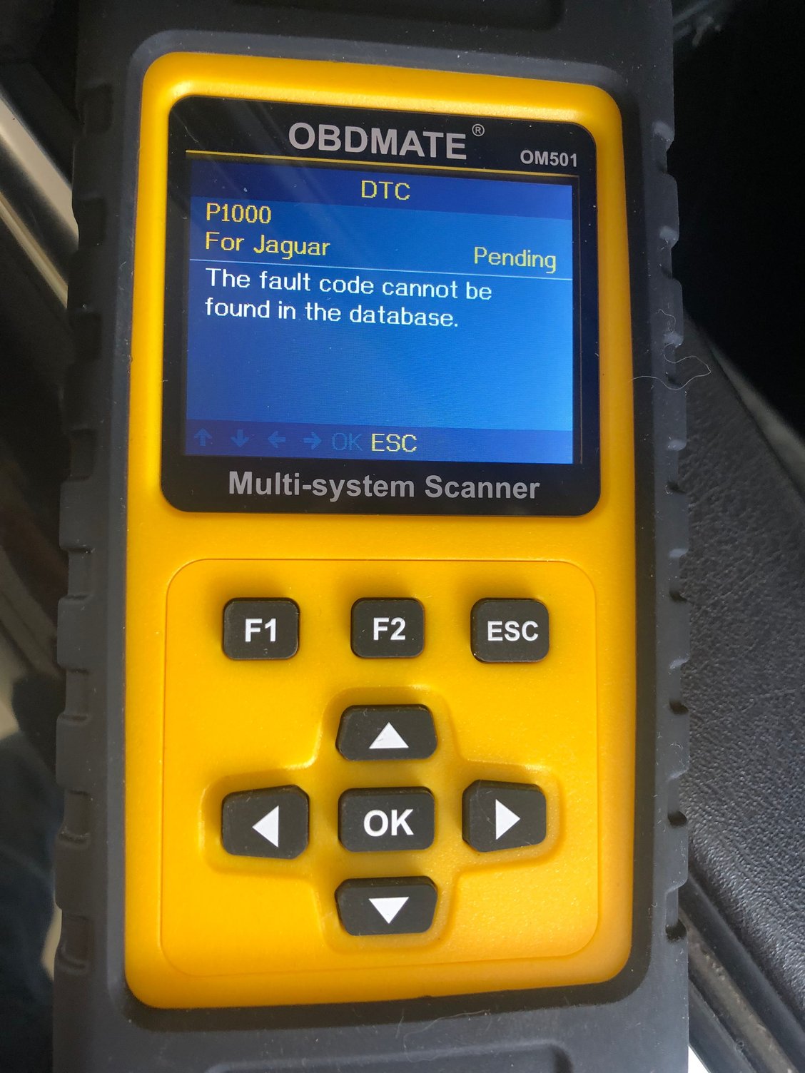

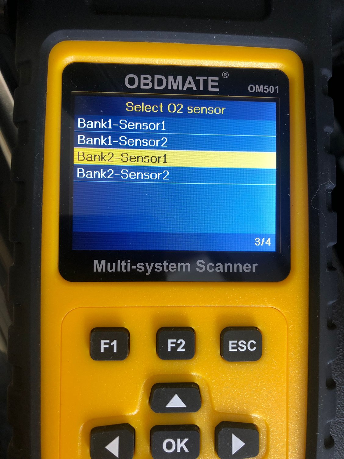

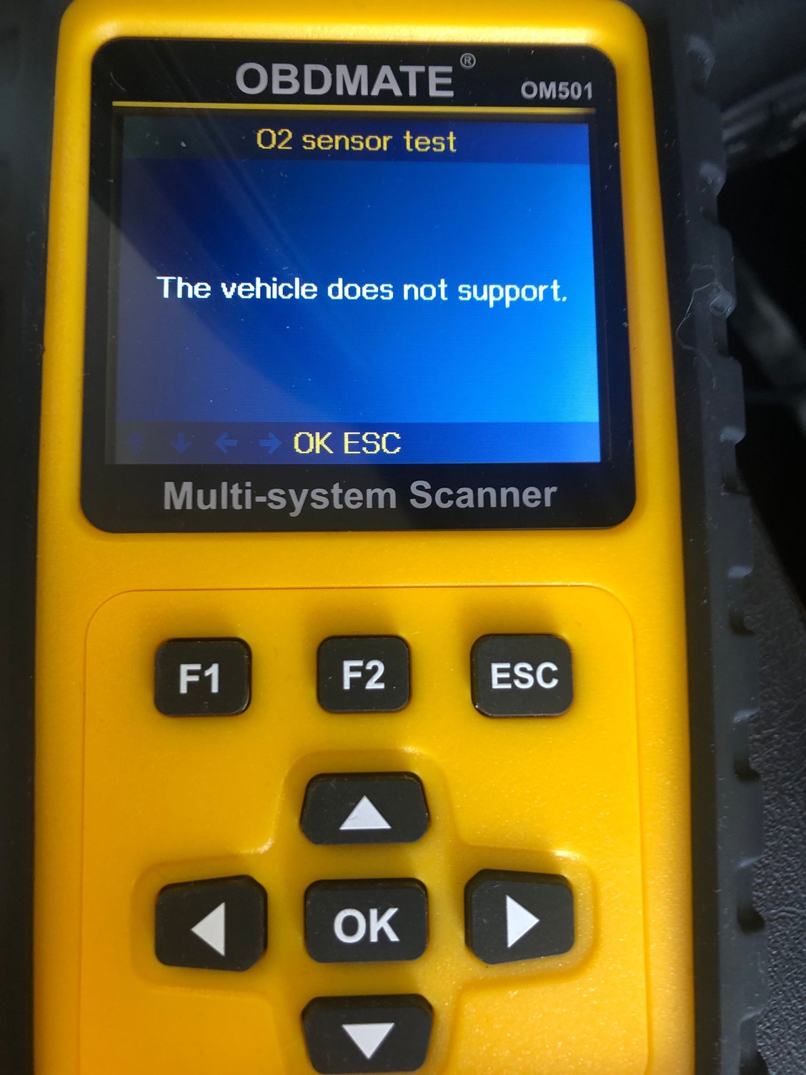

No that means whatever you are using to scan the car doesn't support testing the upstream sensors. I would suggest you get someone involved who is more experienced at this point. The car has a mechanical issue that wasn't there before you worked on it. You need to find what you did, even if it was accidental, that is causing the surge now. it won't be the O2 sensors.
Old Apr 24, 2026 | 02:45 AM
JagV8's Avatar
Posts: 27,546
Likes: 4,923
From: Yorkshire, England
It's just a crude OBD tool which doesn't understand wideband (aka linear) O2s. There are plenty of other tools/software that do.

That's why its more confusing for me, the scan tool read everything in the DTC
it just seems to have a problem with the 2 up stream sensors

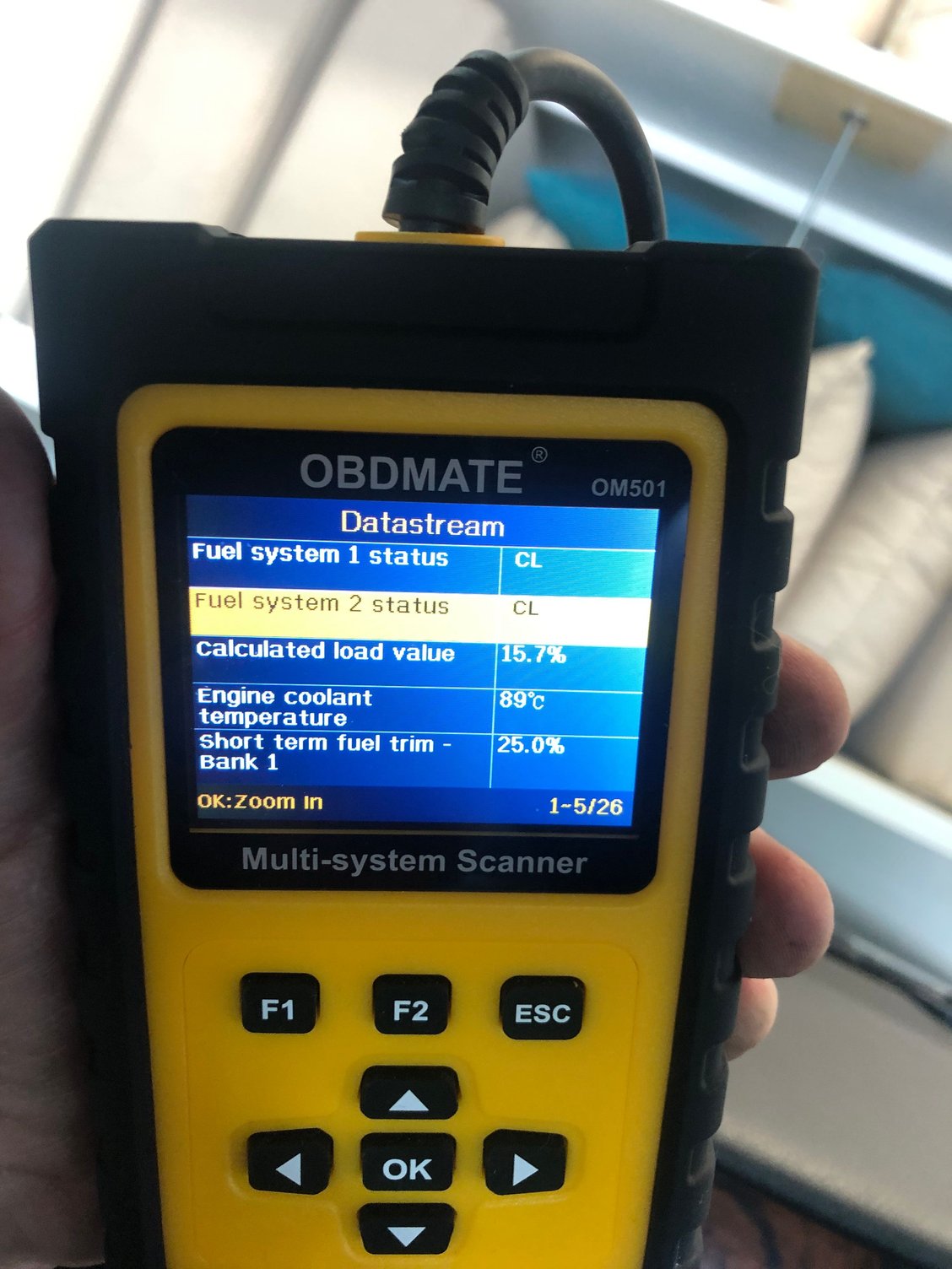

@CKMJAG you do not really know that the problem is with new O2 sensors. You just assumed it, because racing begun after you changed 4x O2 sensors. Re-reading the post I would do following:
plan to spend whole day on this:
1. TAKE CHILL PILL
2. you have at least one good upstream O2 and 2 good downstream sensors the ones you pulled from the car. I know there is a procedure how to remove coaxing from O2 sensor elements, I never used it myself nor have direct experience with it. Just so you know.
3. Lookup on the net how to diagnose O2 sensor with multimeter. Again, I know there are instructions on the net, I do not have first hand experience with those.
4. let's go back to original setup less one bad sensor.
Does engine still race?
swap remaining good O2 sensor
Did this change anything? Just playing odds that you have two bad sensors are less than getting one bad sensor.
5. Begin replacing remaining sensors one at the time.
This plan ASSUMES that you can return to initial state. If you did, then your work has not changed anything else.
Still, what I describing can go sideways at any point and this will require to adjust the plan!
Best of luck!
One other advice, it was mentioned already before: STFT and LTFT you have to display them in a graph mode. run engine at idle and see if STFT on both sides changing beyond 10% when engine racing; do same while holding throttle steady so engine runs at 2500rpm.
If you can corelate spikes in STFT you either have a vacuum leak or malfunctioning MAF sensor. I may be off a little about 10%.

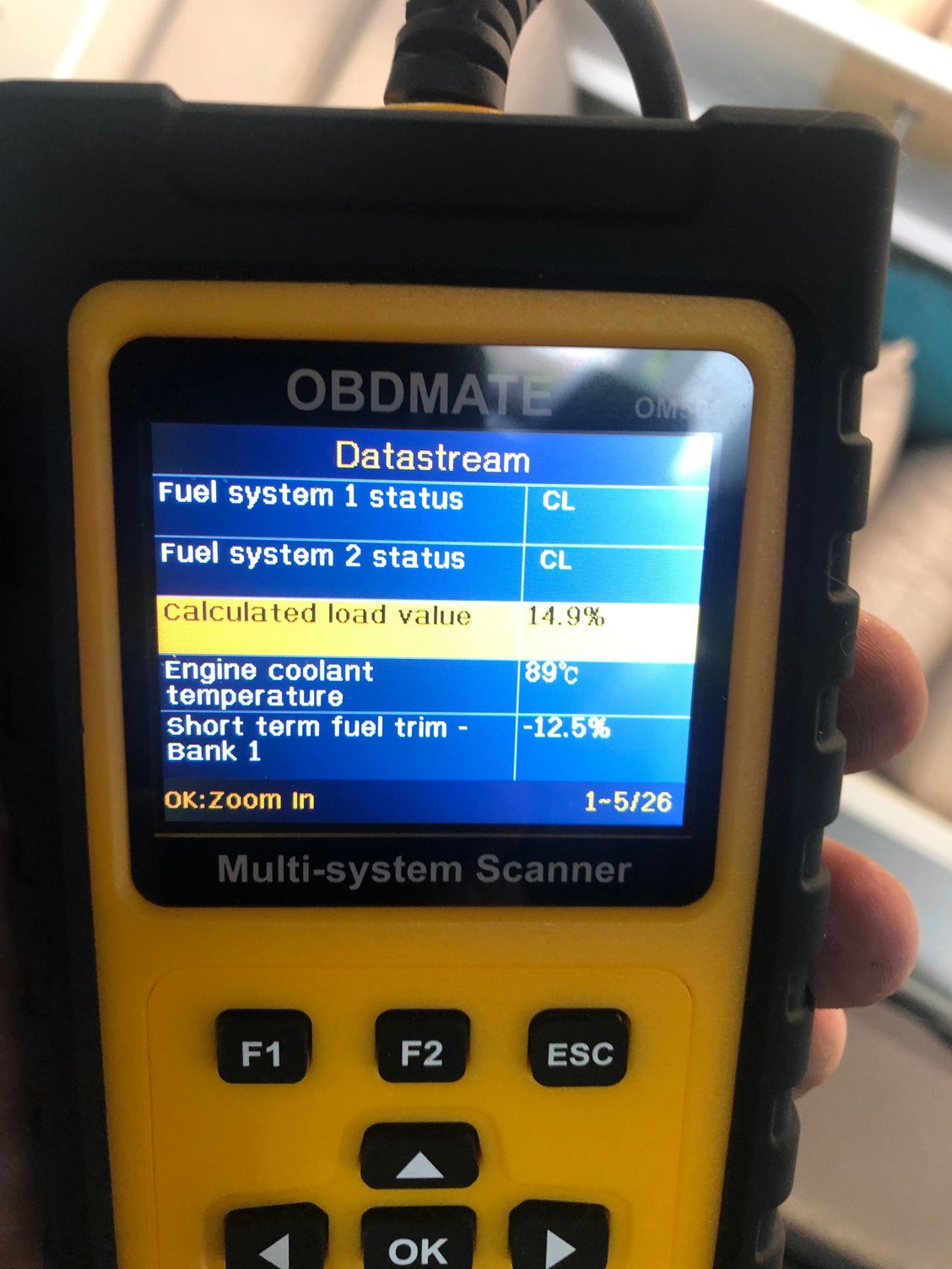

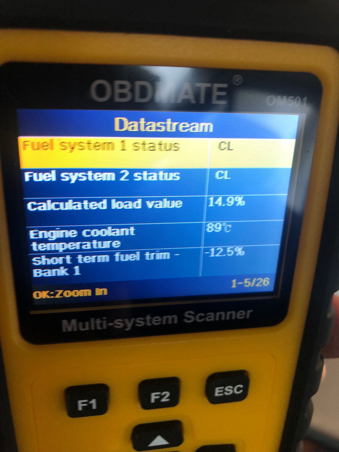

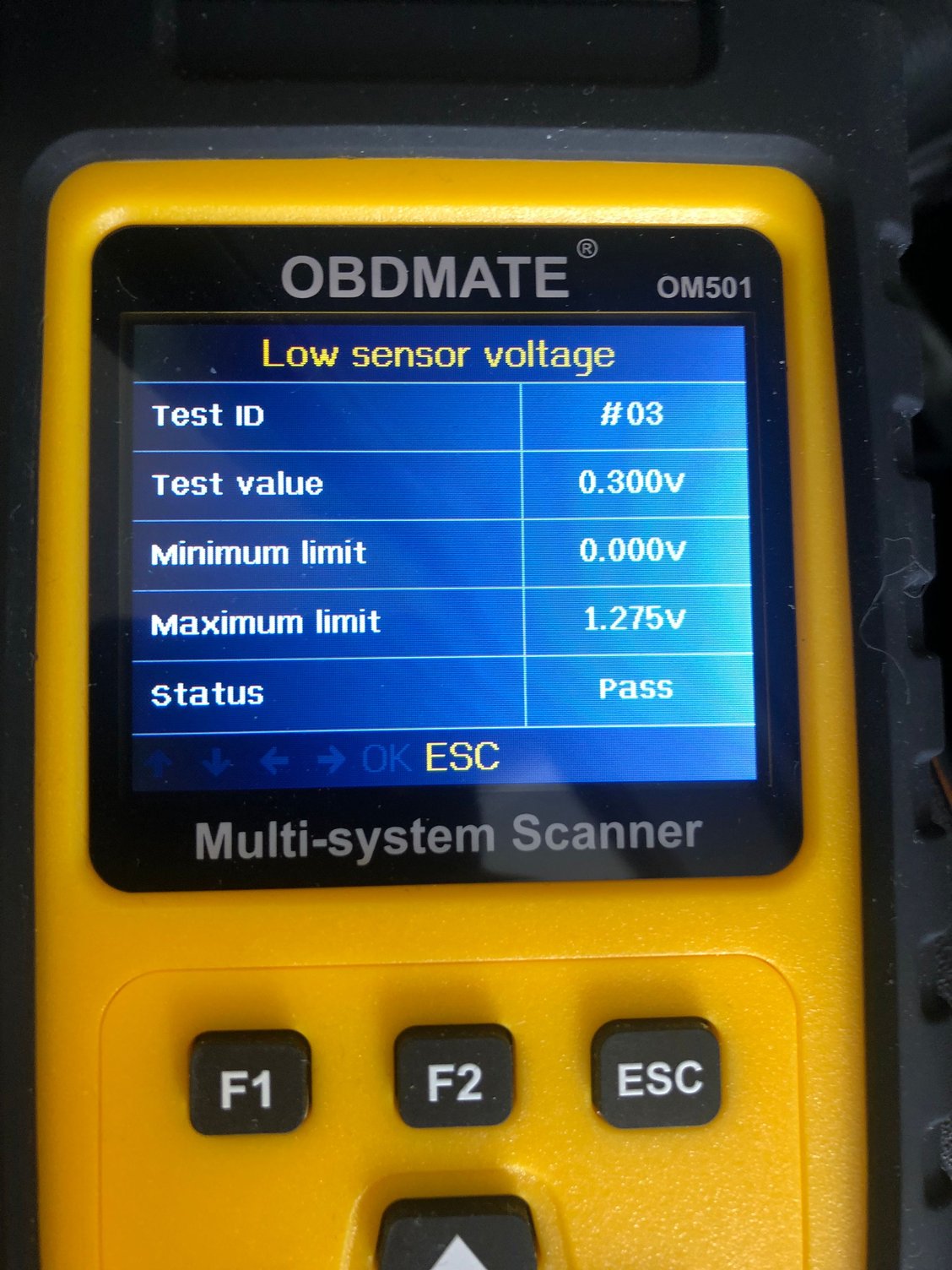

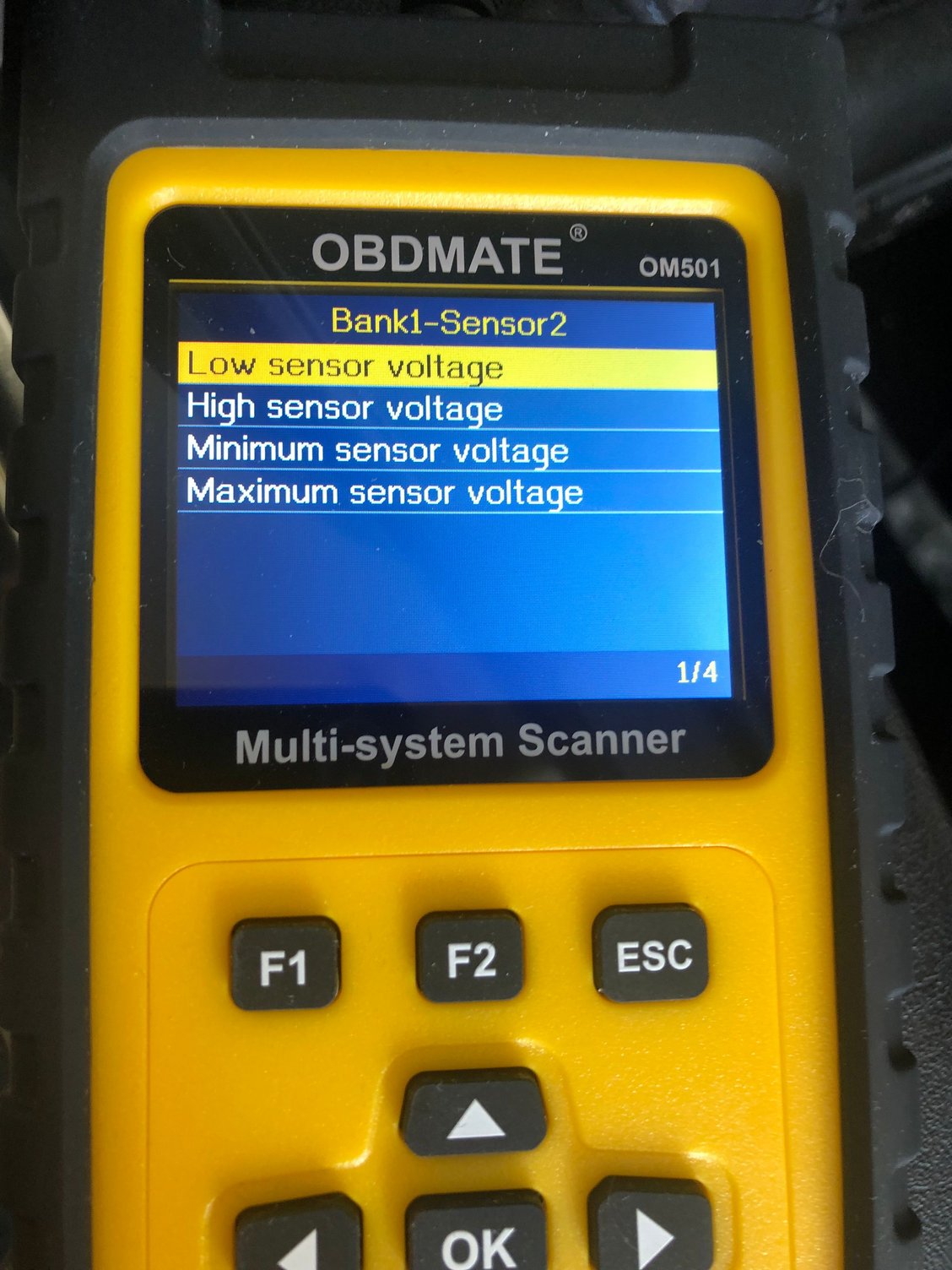

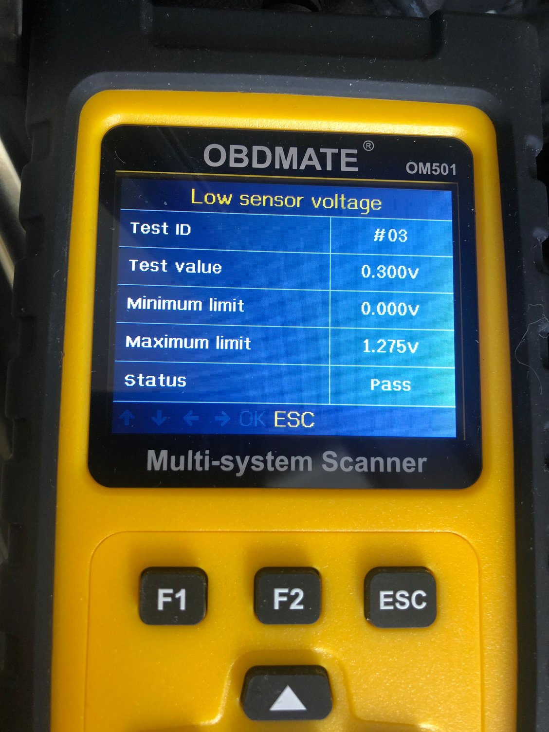

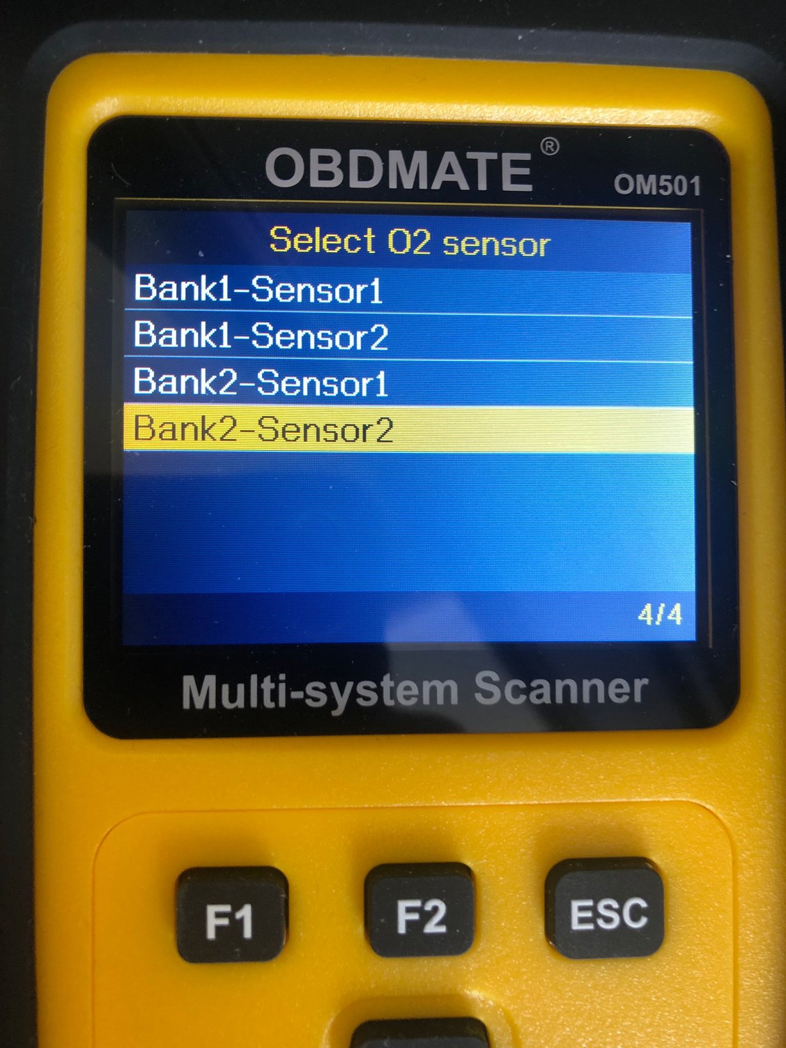

I replaced the B2 S1 sensor with the old but good sensor from the other bank, I left the remain 3 new ones in place.
It idled better and drove better but still has the surge but as bad.
It looks to me that my new Chinese O2's sure are suspect.
I took some more scan readings, see attached, as I cant really know how to interpret them
Today's readings >
Old Apr 25, 2026 | 05:24 PM
  #35
CKMJAG's Avatar
Joined: Aug 2025
Posts: 37
Likes: 9
From: Temecula ,CA
Part 2 of the scans can load here I've exceeded my MB limit
I realize the few scan pictures aren't enough info for a diagnosis of the problem but given
that the motor reacted favorable to the Good/used B2 S1 sensor now in place of the Chinese new one, would this not
indicate the problem is just bad cheep brand O2s .
I guess the next test should be to replace both S2 sensors with the original ones which were working.
If the motor responded even more favorable but still had a "tiny"surge because it still has one Chinese S1 sensor in it.
This might further point to replacing all 4 again but this time with DENSO units.
Do you think I should go this route or stop and look into the ELM327 tool ?

Hey something doesn't jive, when I had 4 Denso sensors the scan tool was able to do a scan and tell me that there is a P1647 code, which is a
bad O2 sensor at B2S1
Now with Chinese sensors the scan tool play's dumb and says (the vehicle does not support) How can this be .
