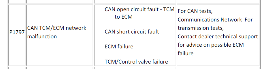

Thanks for that. I didn’t even know a 5 point Torx existed! No I didn’t remove the cowl and pollen filter housing completely as the drainage seemed perfect, but I will give that an inspection as soon as I can.

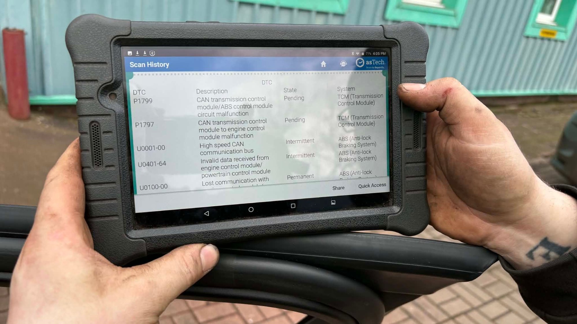

I have some less than great photos of the garage scan tool readouts taken in the heat of the moment, there were pages of them. I’ll see if I can edit them to make them more readable.

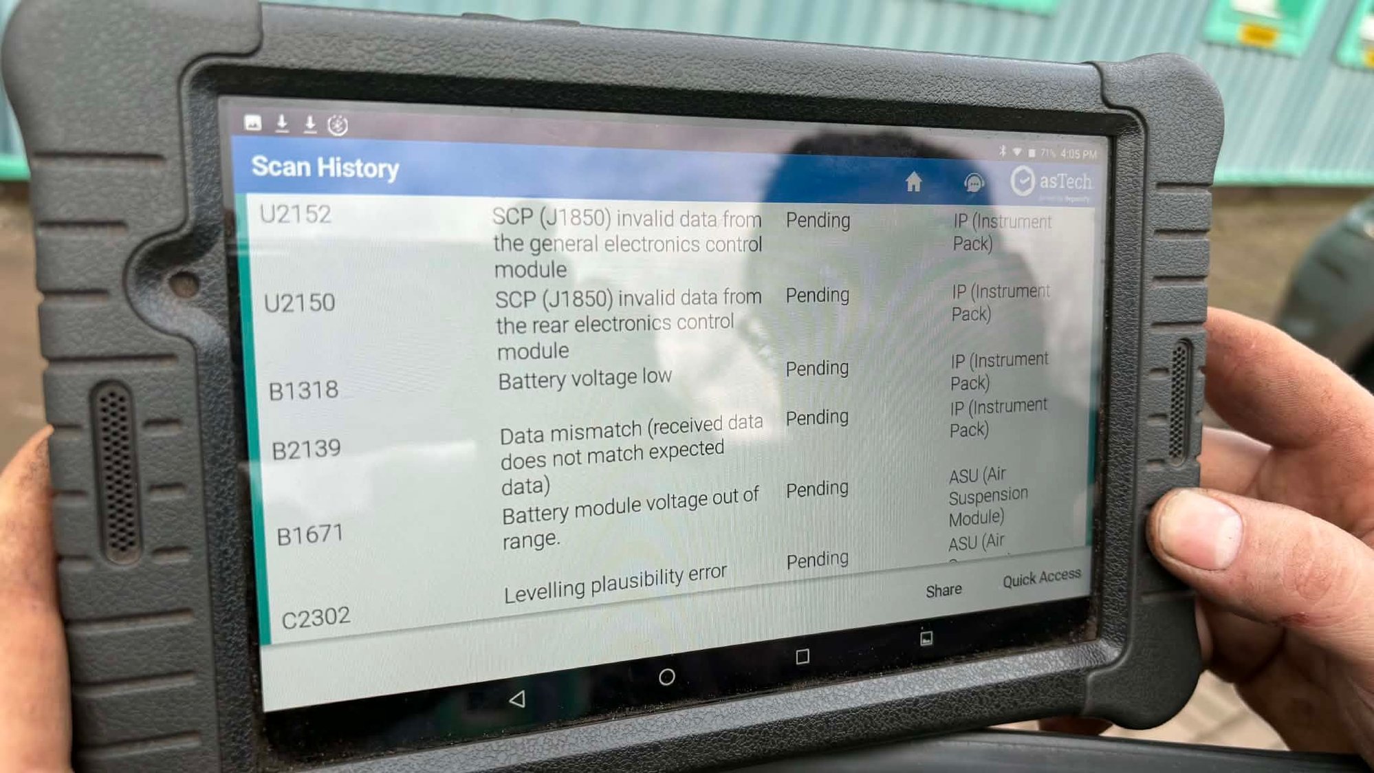

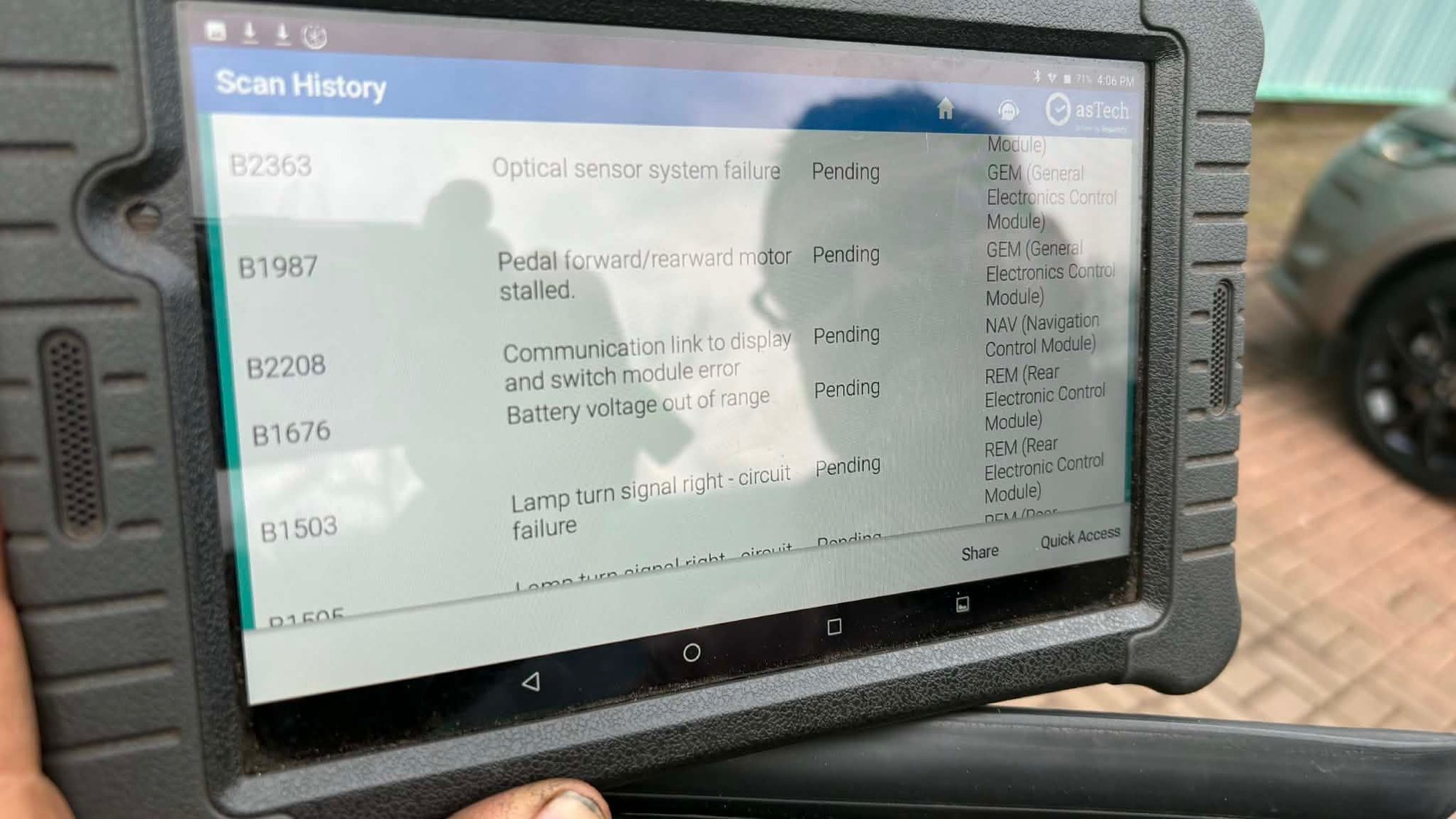

Hi there, Just found the pictures of the scan codes. They actually make a bit more sense now people have explained some. The only ?legacy? fault I had was a non functioning rear parking sensor, which went off last year during a heavy rain spell.
Does this all mean anything to anybody?

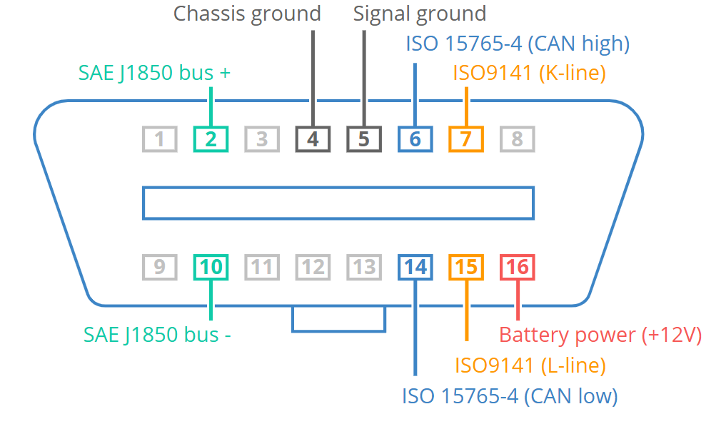

One quick check you can make on the CAN bus is for proper terminating resistance and shorts/opens.
You'll need a digital multimeter, put it on the ohms scale. Disconnect the vehicle battery so your readings are not affected by operating voltages. Check between pins 6 and 14, the result should be 60 ohms +/- 2 ohms. If you are measuring 120 ohms, open, or zero, there's an issue.
Also check from each:
  • Pin 6 to ground
  • Pin 14 to ground
  • Pin 6 to 16
  • Pin 14 to 16
Let us know the results. Maybe there's an open you can track down with basic tools.

This can't make sense to us unless you post all of the codes and definitions. Otherwise we're all trying to diagnose in the dark.

I uploaded the pictures last night but they seem to have disappeared 🤷‍♂️ will try again.

Old Mar 26, 2026 | 08:41 AM
Trophy Husband's Avatar
Joined: Mar 2026
Posts: 16
From: UK
OK reposted above, no12. Let?s hope they stay stuck!

Whenever I see that many seemingly unrelated codes, I suspect low battery voltage to the computer modules while cranking the starter. Since you now have a no-crank condition, have you checked all the fuses, including the megafuses in the boot? Is it possible something was shorted either while the shop was working on it or while you were rebuilding the air compressor?
I would try clearing all the codes and then see which codes recur when you attempt a re-start.

Most of these codes are saying the modules on the CAN bus can't talk to one another.
I would suggest checking the can bus terminating resistance as I posted in #9 above, then report back. If you find an open circuit or missing terminating resistance, then we have a path forward. Otherwise we're all just guessing. It is possible a module can lose a power or ground and cause similar symptoms, but this test will confirm whether it's a broken CAN wire or something else entirely.
Thanks for the advice and diagram. My,ultimeter is lost in the garage since moving house, I'll have to go digging in there today!
