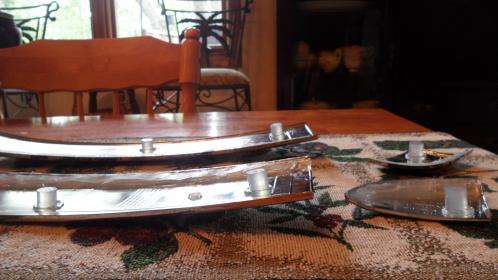

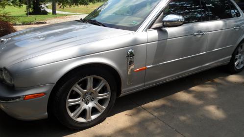

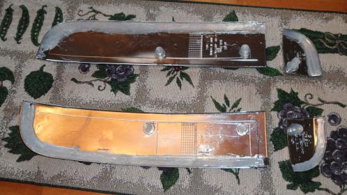

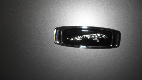

I added classic leaper fender badges. I liked it better than getting the Jaguar XJ8 trunk badge and it costs a 1/3 as much. I placed them about 3.33 inches down from the upper fender crease (for lack of a better word) and 6.25 inches forward from the door seal.
I removed the double sided tape that came with the fender vents and used the hot glue to build a foundation that would lay flush with the fender. Actually just about 1/32 of an inch under to allow the glue a seat during installation. I used the large hot glue stick slices as spacers and installed them to the fender vents. Double checking them for proper height and that they lay well on the fender. I used 7 inches as my dimension from the trailing edge of the fender vents to the door seal.
I installed the fender vents using the large hot glue gun and large sticks with a hi power setting for heavy duty applications.
I'm very happy with the installation of the fender vents although I would have done a few things different second time around, maybe.
Biggest change would be after laying out the vents temporarily with masking tape I would have decreased the actual glued area with tape and painted the underlying area with flat black to complete a "Shadowed" look under the vent when finished.
Also I might have sanded the ridge or edge of the vent on a belt sander the decrease the trailing edge height and try to achieve a more flushed look.
I might do both of those things later anyway but for now I'm jazzed with the end result, and its mine!
Does it look like the fender is cut out for the OEM vent, no.....Will anybody that's not a Jag **** retentive lug nut be able to tell its fake...I doubt it.

Very cool. Thanks for sharing the pics. As long as you like them, that is all that matters. Although, they don't look like the factory vents Jaguar uses.
Edit: Never mind, I think I see what you did. You modified them and used leaper badges instead of the thin JAGUAR logo.

Congratulations, I like it. I may not have used the Leaper Jaguar but it still looks good. Was their a reason for using the Leaper instead of the Jaguar script?
Old 07-10-2011, 08:08 AM
Radjag's Avatar
Join Date: Apr 2011
Location: Oak Ridge, MO
Posts: 20
Received 0 Likes on 0 Posts
The trunk badges are $50 each. I made a mistake and tried to order something else entirely that was the wrong plan, I do have some extra after market jag badges, might look good I my tool box. I found these leapers on ebay and because they were legacy I went for it. I've spent over $100 trying not to spend $100 (I think I get click happy on ebay) Likely by the end of summer I might buy the trunk badge with the script "Jaguar XJ8" and trim the edge of the fender vent for a more flush look as well as spray black paint under the vents before re-installation. Hind sight is 20/20. One of my favorite sayings.....experience is what you get when you didn't get what you wanted.
