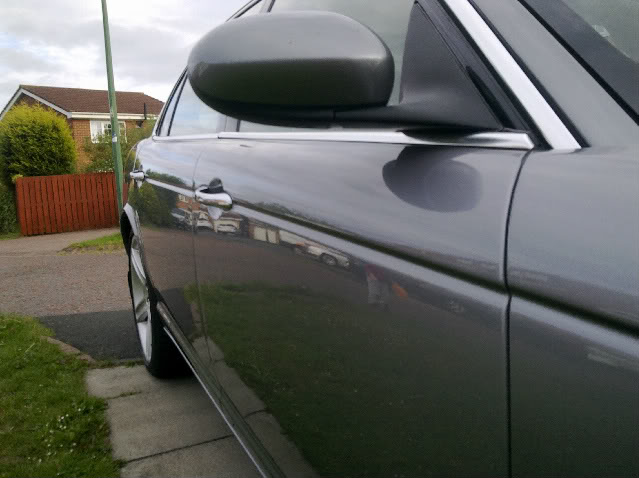

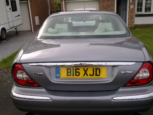

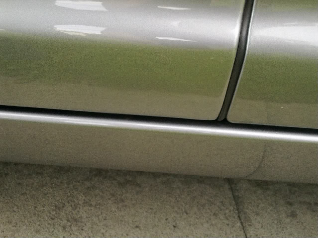

Just got my car back from the Jag approved bodyshop (in for 9 days!) to get some corrosion sorted out under Jags 6 year corrosion warranty.Total cost paid to the bodyshop by Jag was only £136 (guessing thats approx US$200?)!
The repaired area (front corner of rear door)....
Attachment 171918

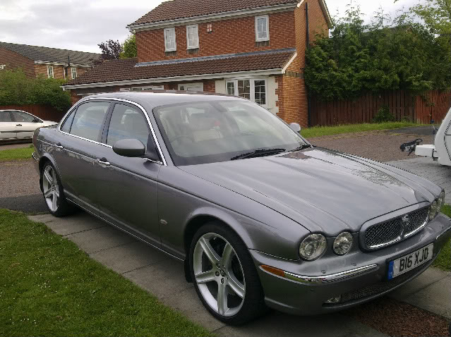

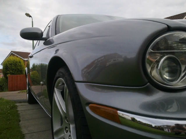

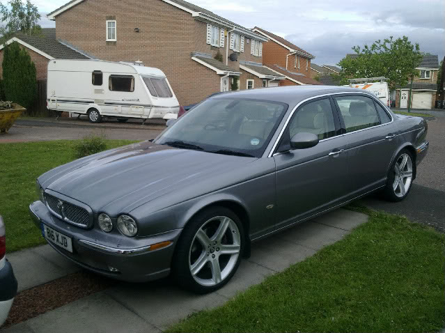

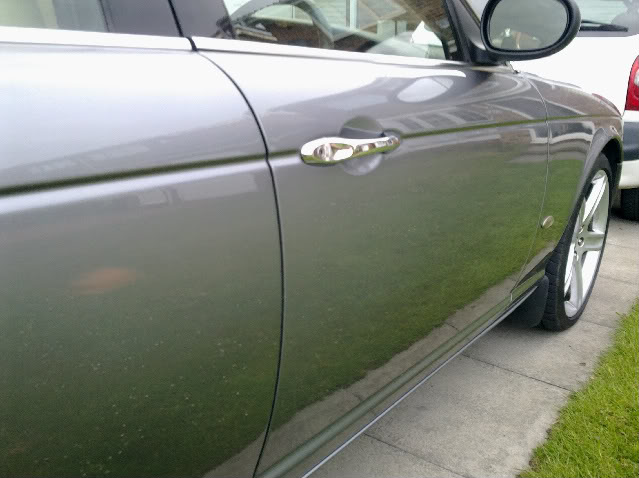

Somemore pics.....
Attachment 171919
Attachment 171920
Attachment 171921
Attachment 171922
Attachment 171923
Attachment 171924
Attachment 171925
Attachment 171926

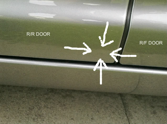

1 Attachment(s)
The bootlid is fine.The corrosion was in this area and was actioned before before any paint breakthrough which would then have voided the warranty I as I understand it.
Attachment 171896
Over here in UK there are quite a few reports of corrosion.
Mines going back next week for authorisation hopefully on more work as there is a very slight area of bubbling started ½ way down the rear screen just beside and under the seal which is easier to feel than see.
