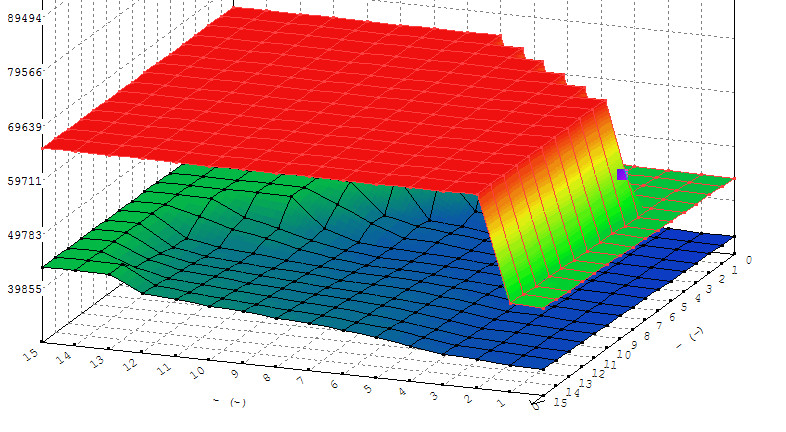

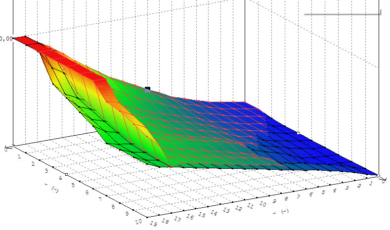

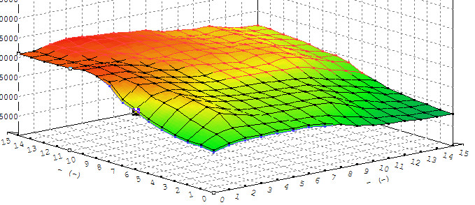

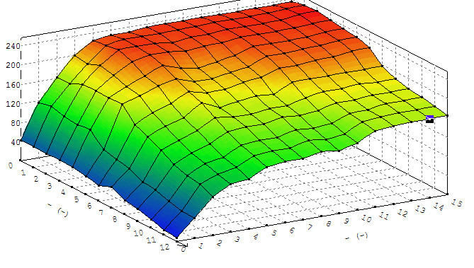

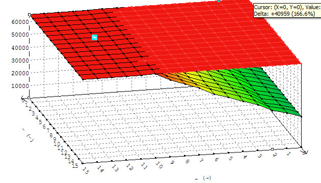

Alright, now we are getting somewhere... this is for the 2003-2005 STR/XJR/XKR, trying to implement as many of the improvements from the later model tunes as possible.
Short list:
Air fuel ratio 11.5:1 at WOT
(instead of 10.5:1, also part load and idle mixture adjusted)
Bit more spark advance
(but nothing too crazy)
Revised throttle map above ~1/3 throttle
(now you get 100% throttle when the pedal is at 100%, BUT from idle to ~1/3 it's kept close to stock so you can still drive gently around town)
DSC intervention torque request. Now greatly reduced at low rpms & half-throttle, instead of the awful power cut when you get wheelspin off the line with the DSC switched on at more than half throttle, it mostly uses the rear brakes instead, with only a mild cut in power, makes the cars without LSD much nicer to drive off the line or in low speed standing-start corners. In the graph you can see the stock map with the revised one overlaid. The DSC will still function as normal from idle to low rpm if you are faced with very slippery conditions.
Torque limitation. Well yeah, it's gone... basically no more holding back. It'll go as far as the cams and Heaton will let it now...
A few other little details but this is the guts of it.
Essentially this is the same as his revised tune for the 2006 onward STR and XJR, but obviously without the VVT changes, because there isn't any VVT to adjust...
