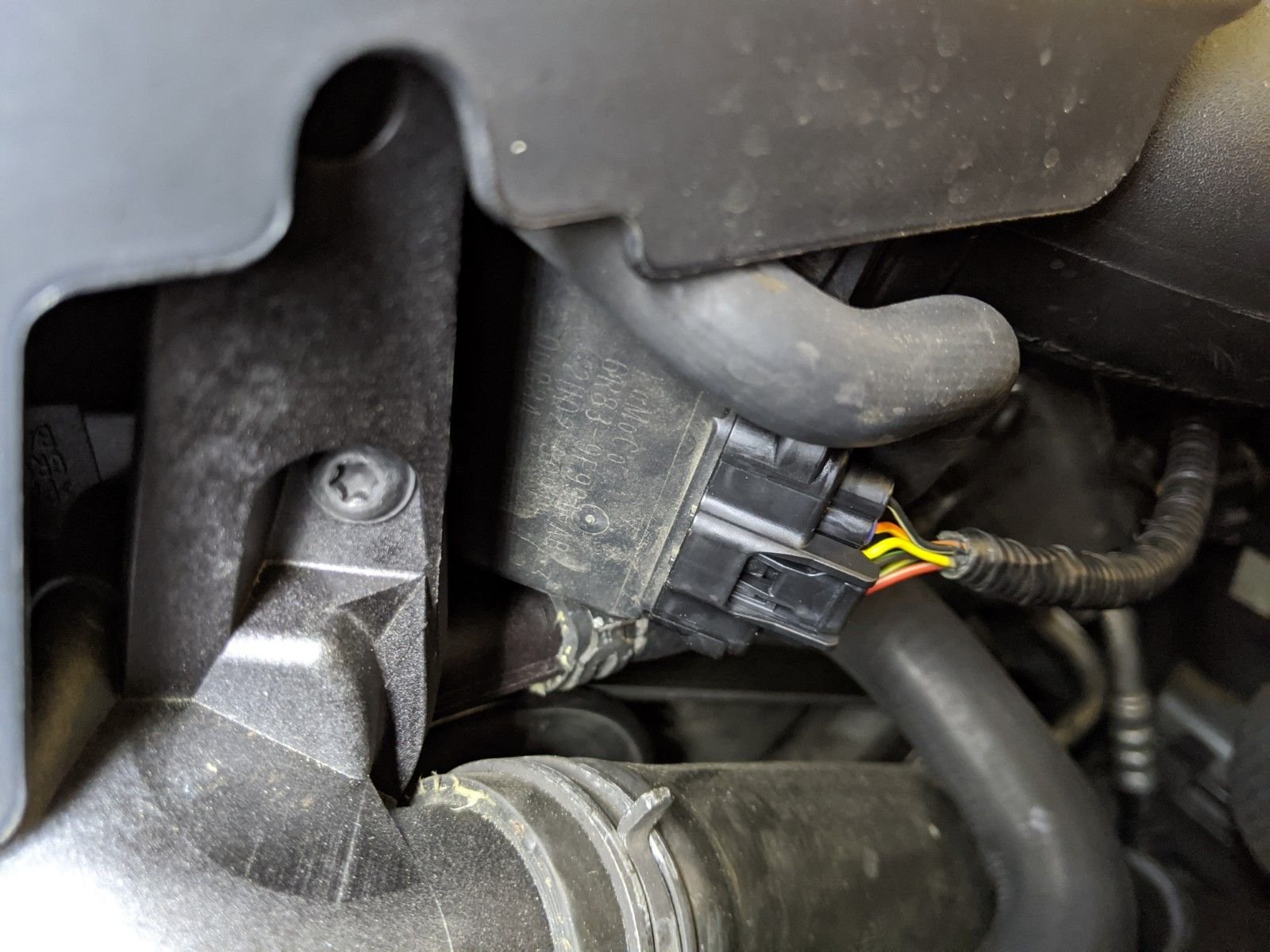

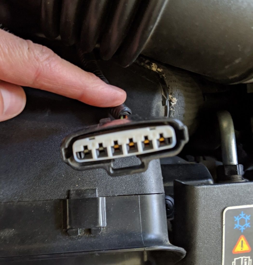

Wanted to share this with everyone. I found the replacement connector for the later design throttle body models (single 6 pin TB). It's actually a Toyota part 90980-11858. I was able to find this on Amazon for about $14, but you can Google it and find other sources as well. My original had started to fall apart, the lock tab broke off last time I serviced the throttle body. I did not use the new crimp ends that came with the new connector, I simply depinned the old connector and installed those contacts in the new housing. The Jag actually uses gold plated contacts for the 4 TPS pins.
Replacing the fuel injector connectors next. They are a common design EV6 red, type B, available from many sources online.
Hope this helps someone in the future.
