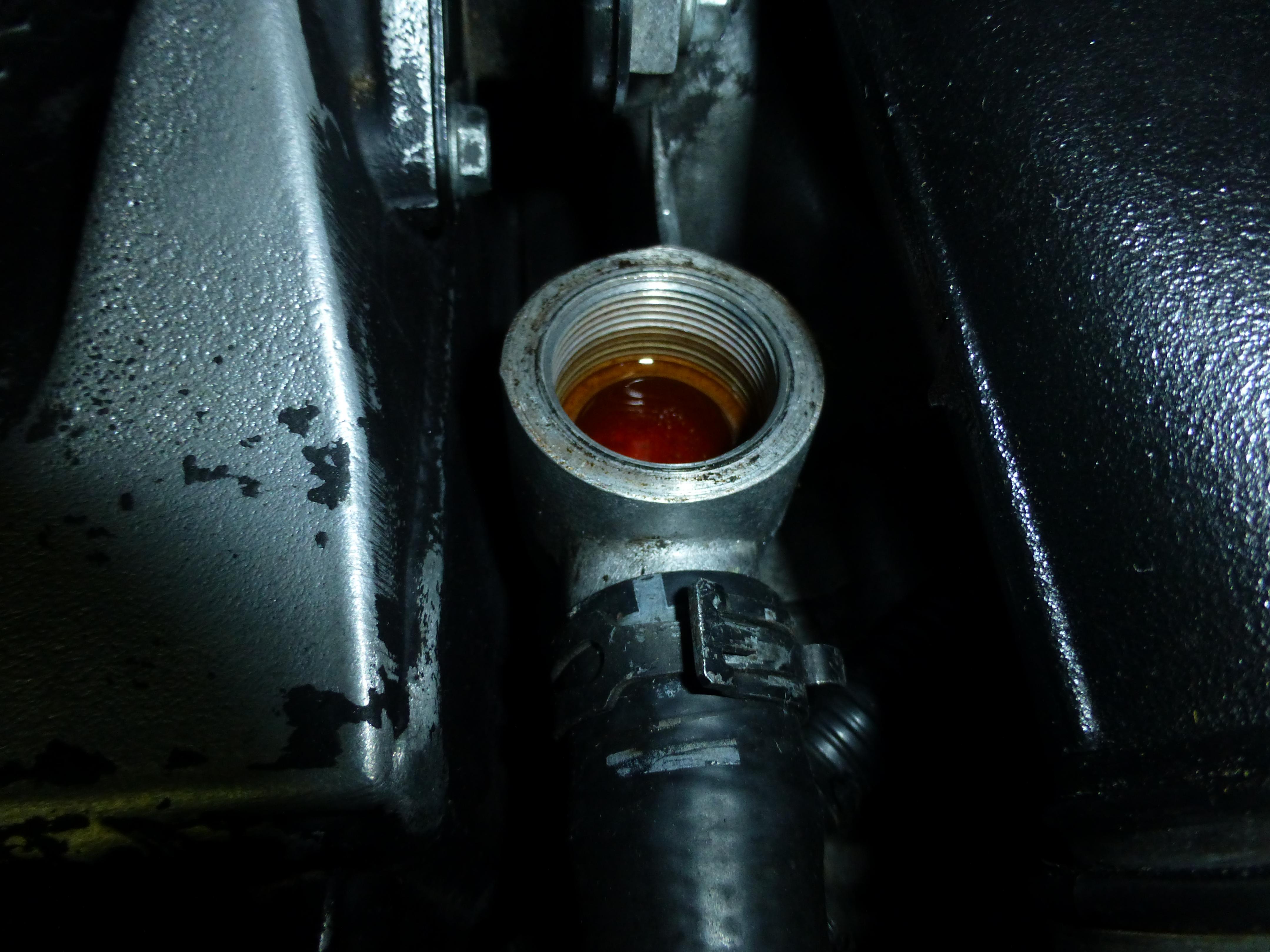

Just ordered two washers from McMaster. Will have to cut to size no big deal.
Just had a look at my seal more closely. The black flexible washer is supposed to fit inside the slightly larger metal washer. Mine was outside and therefore not sealing. It is slightly damaged.
Incidently the coolant level was where it is supposed to be in the filler tube. Thats filling the coolant thru the reservoir cap only during topping up with the car on the flat.
The slight leak probably helped in the process.

Old 07-29-2016, 10:02 AM
Join Date: Feb 2014
Location: Crossroads of America
Posts: 19,389
Received 12,734 Likes on 6,378 Posts
jackra_1,
That sounds like the black flexible part was probably originally bonded to the inner rim of the metal washer. Search the McMaster-Carr site for "Sealing Washers" and you'll find that type, including metric versions. Maybe you'll be able to find a match.
Cheers,
Don
jackra_1 (07-29-2016)

Even correctly positioned I still get a leak so will order the combination
washer as well from Mcmaster.
