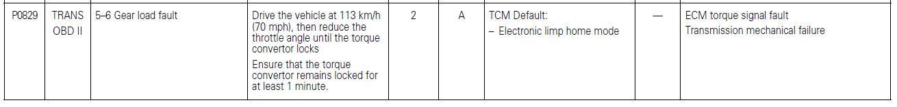

Don B Aug 26, 2015 06:41 PM
1 Attachment(s)
Hi Isoruku,
Sorry to hear about your transmission issues.
According to the DTC Summaries manual, which I am attaching, the P0829 code can mean one of two things:
1. ECM torque signal fault
2. Transmission mechanical failure
So my first question would be, how did the dealer determine that your code was not triggered by an ECM (Engine Control Module) torque signal fault, since that is listed as the first suspected cause of P0829?
For proper shift management, the Transmission Control Module (TCM) relies on many signals from several other modules. This information is received by the TCM in both analog and digital forms via the main transmission electrical connector, which is protected by a cylindrical plastic sleeve that is known to develop oil leaks.
Since reported electrical issues are far more common than mechanical issues, I would personally recommend that you have your mechanic check the transmission connector for oil contamination that could interfere with the electrical signals received by the TCM. You mention that Beckers changed the transmission fluid and (pan?) gasket in April, but did they replace the sleeve? And if so, did they get it fully seated?
Have you checked the fluid level in the transmission to confirm it is correct?
I also have to wonder if P0829 was the only DTC present, or if there may have been others stored, such as any U codes that might indicate problems with the CAN (Controller Area Network) communications. Did the dealer happen to mention any other codes???
If it were me, I would not accept the diagnosis that your transmission is "finished" without more diagnosis.
Please keep us informed!
Cheers,
Don
