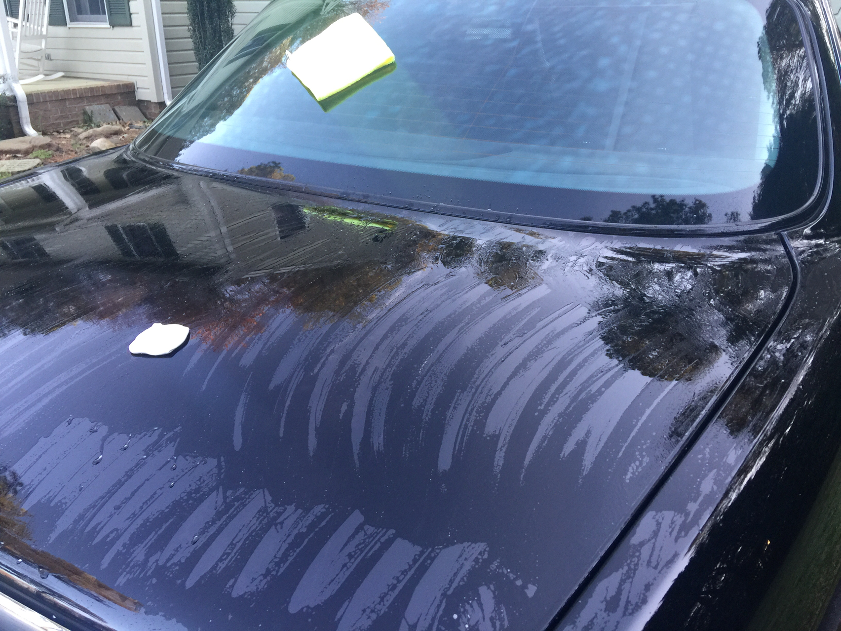

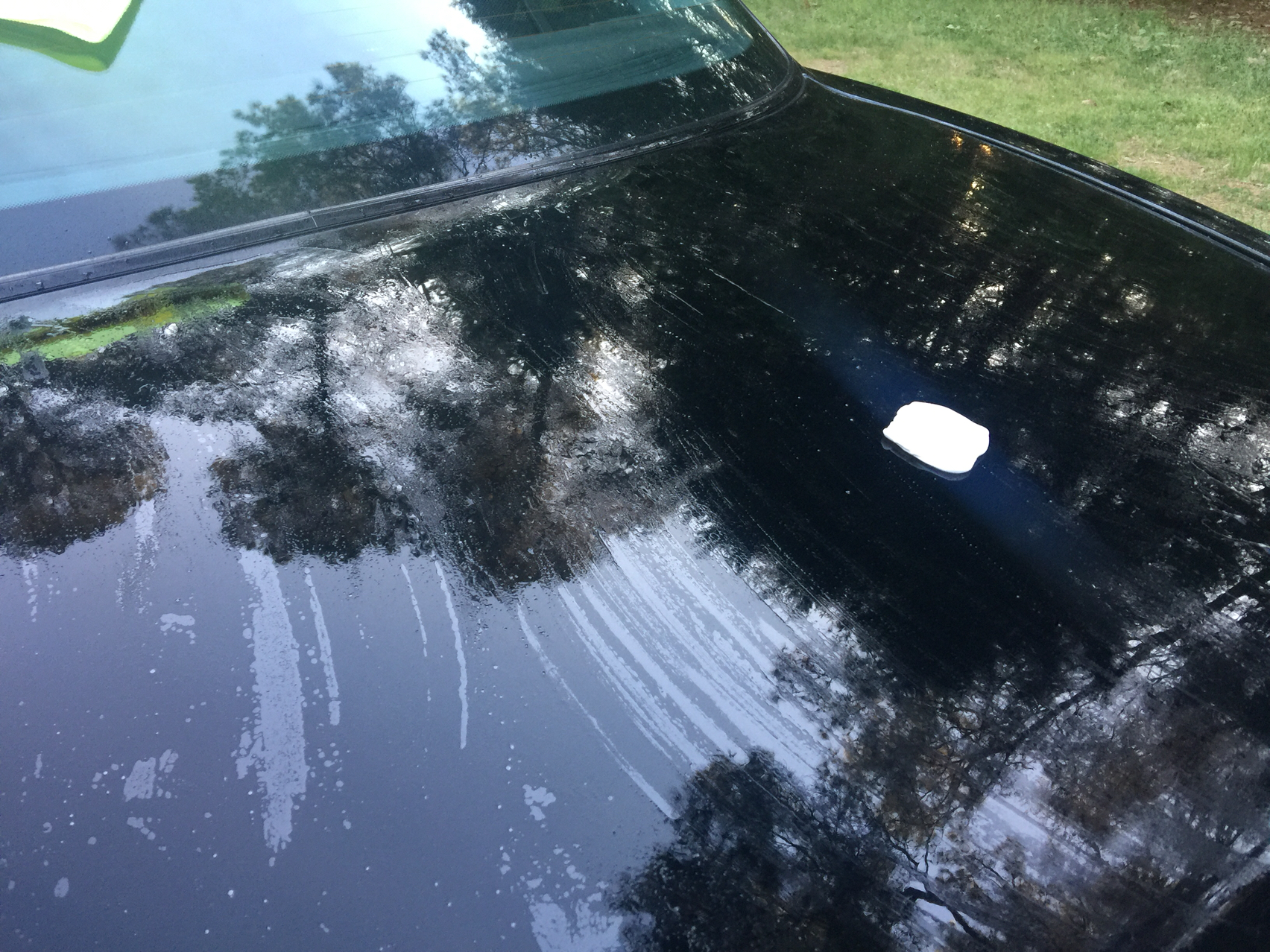

Clay bar and wash
Thanks
Mag
Attached Thumbnails What did you do to your X350/X358 today?-photo404.jpg   What did you do to your X350/X358 today?-photo817.jpg
