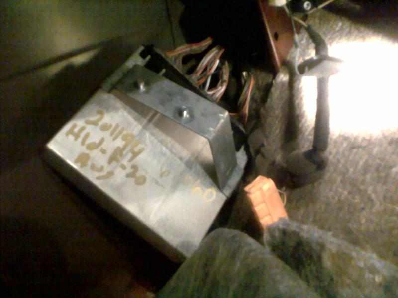

I am having same issue. I can get in the learning mode but when I press the lock button I cannot get the confirmation beep that it was accepted. Ive verified that everything matches up with the 433 freq as well. I also replaced batteries. There is an orange thing disconnected (see link below) but I cannot figure out where it would go as there are no vacant spots anywhere near by. Any ideas if this orange thing not being plugged in somewhere is causing my issue? Thanks

Don't think it's the orange 'thingy' that's your problem.
How have you verified that everything 'matches up with the 433 freq'? Pity the photo didn't show the other side of the SLCM with the info' on it. Does it state 433?
Also, how positive are you that the remote is 433? How have you verified this?

Did you check under the hood on the passenger side? as it turns out not only was my SLCM unplugged(for whatever reason) but behind the passenger side headlight there is another piece to the puzzle that was also disconnected. it was the alarm speaker and probably necessary to be plugged in for the alarm to work. check there and make sure everything is plugged in correctly.

The last 3 digits of the FCC number are 433 on the otherside. At this point Im not 100% sure the remote is 433. Ive read that one cannot go just by the print on the chip in side. I think they all say 433. Then I read you can "look north east" of that print and determine by 100 or 101, but of course mine says 113. Im also missing the battery cover. The antenna in the rear window is 315 but from what I read that doesnt matter. Does anyone know from the 113 what freq my remote by be?
