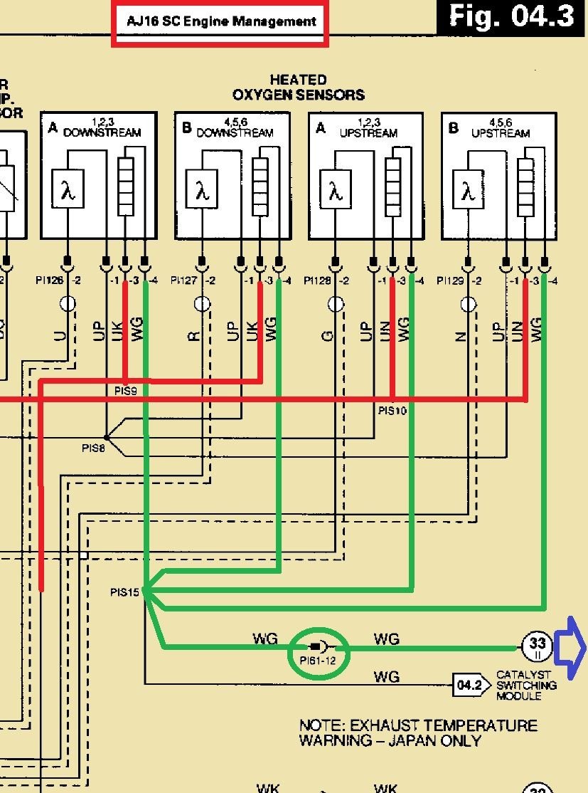

There is 1 fuse for all 4 sensors to heat them to read correctly , fuse 10 , 12 , 14 , or 16 as only 1 , right engine bay fuse box , notice the papa indy 61 connector position 12 as the white / green wire , the blue arrow points to the fuse , there is a TSB on this connector corroding because of it's position behind headlight that lets rain pass through headlight surrounds
