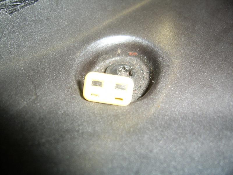

Looking at that plug again and I saw the problem. It is a 4 terminal plug, OK, we only use 2 terminals, so there is a whitish plastic thingy in there to fill the void of the other 2 terminals not used. OK in principle, but, that plastic thingy is NOT a sealing piece, and the open section of the unused holes are facing UP.
I dribbled oil on the top face, and then unplugged the thing, and had oil inside the lower section, AHA found it. Washed all that again with carby cleaner, and applied a blob of RTV to the 2 open slots, and 2 others I deemed could allow ingress. Basically sealed the top section totally with RTV. Replugged it. Dribbled oil again, NOTHING inside the lower section, dry as I wanted.
Some photos I took to try and assist are included, so I hope they work, and are clear, as I am NO photographer.
