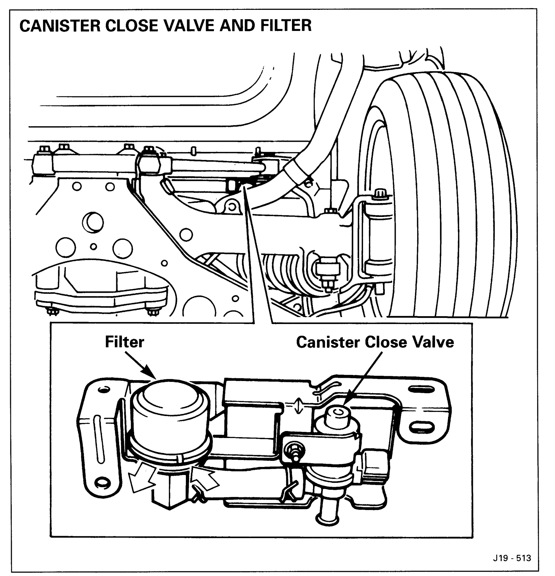

Mine was missing the vacuum hose from under the intake manifold ( cylinder 2 or 3 ) tp the EVAP valve located under the air filter box
there are 2 water lines for and aft for the throttle body throat to keep carb ice from forming
you can make the EVAP valve click with a 9 volt battery and blow into the hose to know it is closing
The valve should be closed at idle and engine off
Do you have one vapor square canister on the left in front of the rear wheel or 2 vapor canisters one on each side ?
There are 2 versions of vapor recovery.during X300 production you being in California may have the 2 canister version not having a simple Rochester valve
This will be in the beginning of the AJ16 section of the Jaguar 801s doc , around page 80 or so
