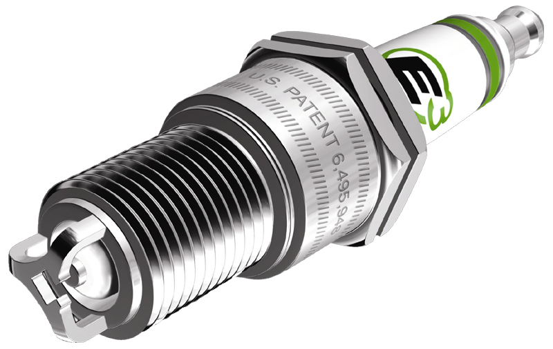

Update:
I returned both set of plugs and purchased the E3 diamond spark plugs, car ran like a charm. I guess my jag has expensive tastes. Car stalling problems are no longer there, which makes me think I needed different set of plugs. Will update if stalling problem comes back up. Thank you all for the help.

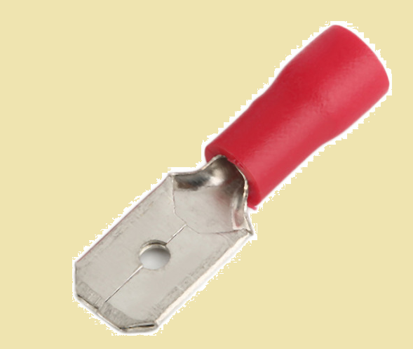

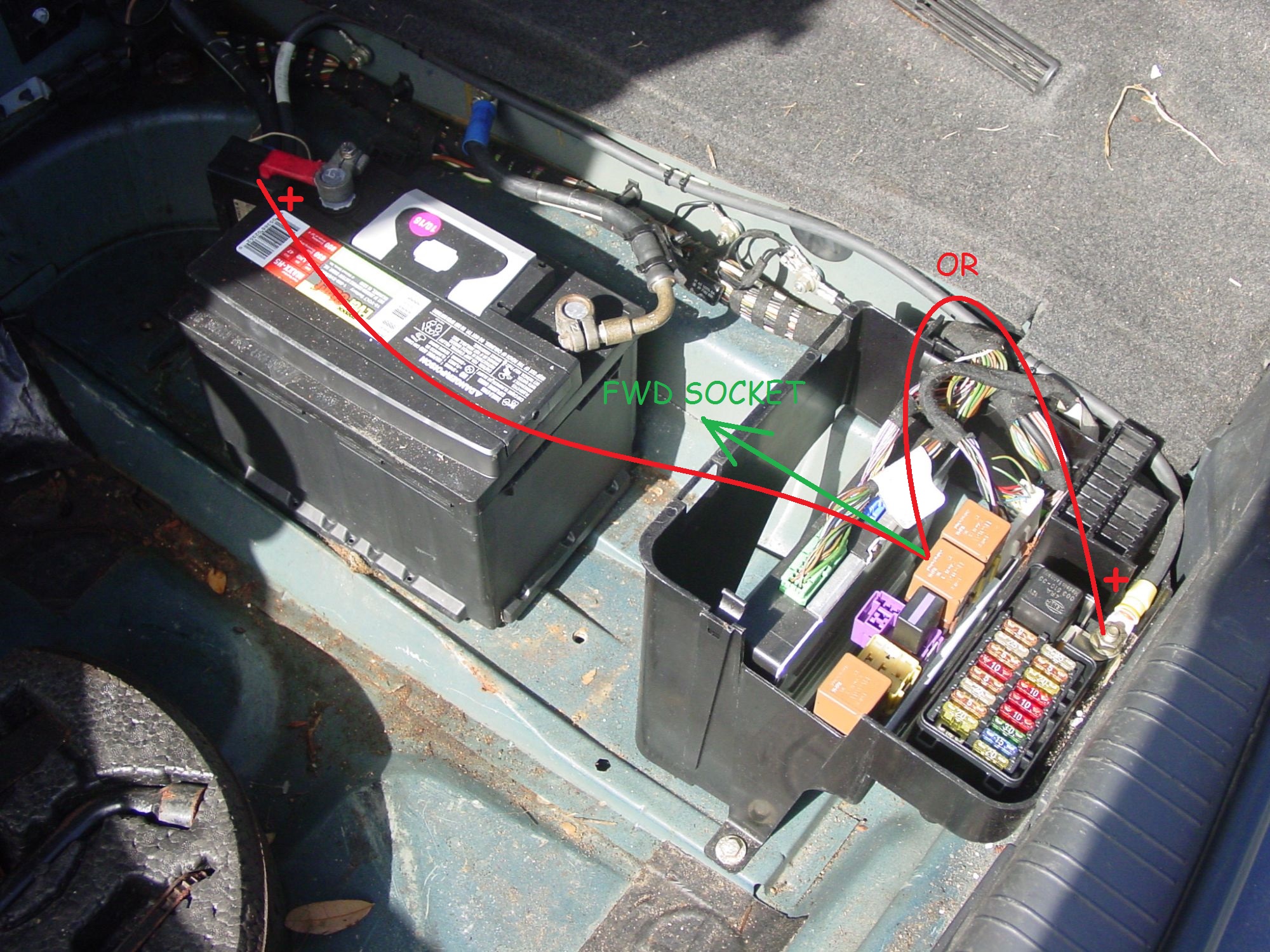

Is the battery charged up to the full 12.77 volts with a external meter before starting ? Have you tried starting and running the car with jumper cables still attached and once the jumper cables are removed what happens ? You can jumper it from the front engine bay . The true voltage may be too low and causing ECU to not turn fuel pump back on after initial key to on only 3-5 sec fuel rail charge / primer where the pump turns back off by design . The ECU turns it back on once it sees rotation from the crankshaft sensor .
With the following method you can hotwire the pump to stay on eliminating the ECU control :
With the fuel pump relay you're looking for the 3rd click back to on ( from the crankshaft sensor ) . Since you have the first 2 ( sometimes ) that charge / prime the fuel rail the control circuit is intact ( sometimes ) coming out of the engine ECU . You must have relay click for power to the pump . If you want to hotwire the fuel pump to stay on at all times you can put power into the relay socket that goes straight to the pump taking the control out of the picture so you can focus on a running engine's regulation . Take a blade connector with some heavy gauge wire from the forward most slot in the relay socket to the battery positive or the relay box terminal post positive . Use the clip as a switch so you don't arc the relay socket . Will be hot at all times so don't forget to remove the clip on shutdown .
Attached Thumbnails Car stalls on startup-jag_fuses_-fuel-pump-jumper.jpg   Car stalls on startup-x300-blade-untitled.png
