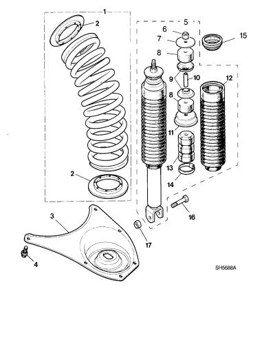

Did the aftermarket fronts come with the bump stop, etc that is shown in the diagram under the dust shield?
And BTW, that's a heck of a deal on the "lifetime warantee", thanks for posting that. Wish I had known when I bought the rears. It would be interesting to try to see how that warantee holds up when they wear out!
And BTW, that's a heck of a deal on the "lifetime warranty", thanks for posting that. Wish I had known when I bought the rears. It would be interesting to try to see how that warranty holds up when they wear out!
