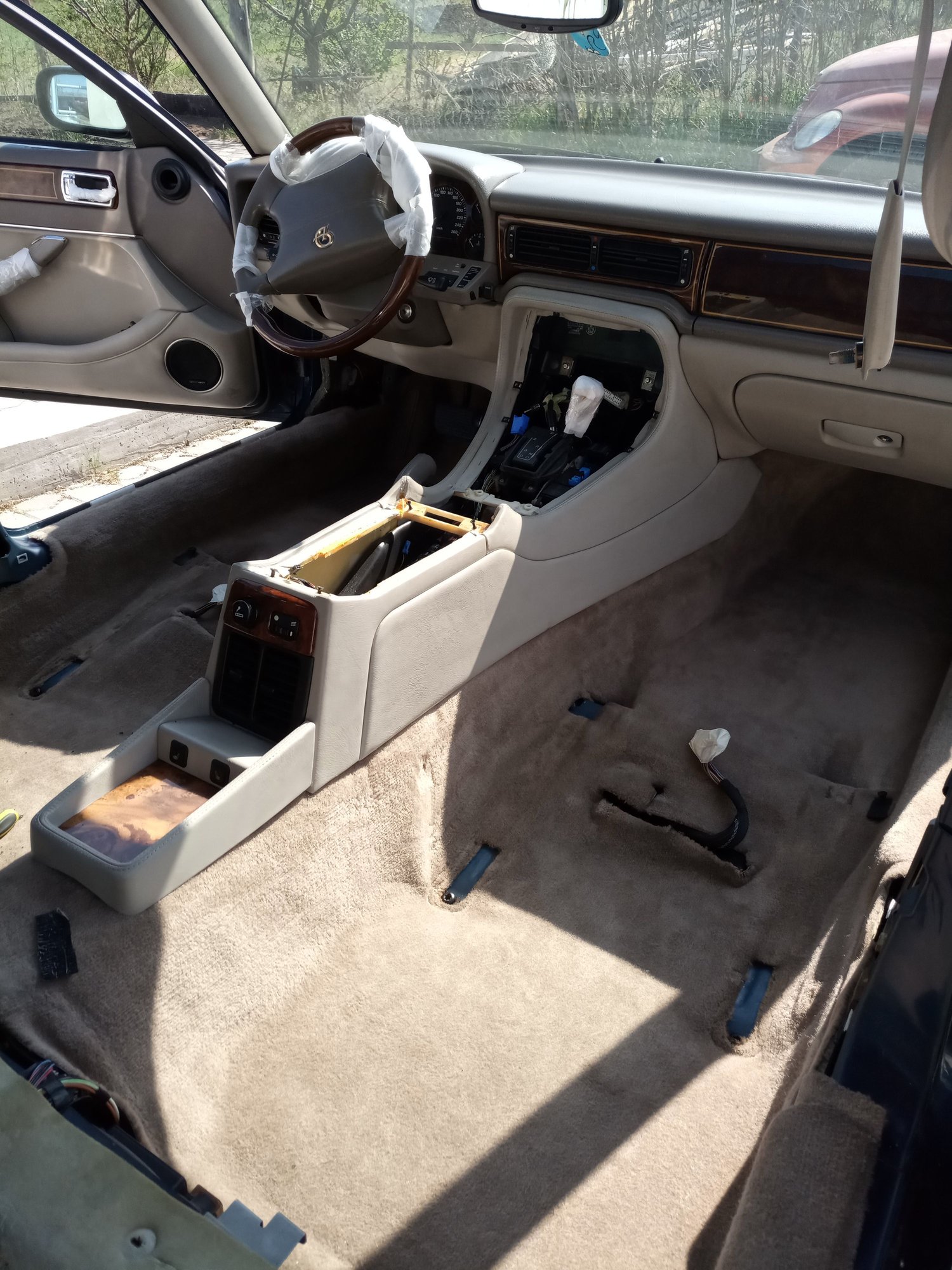

Does anyone know how to remove the Center console of an 97 xj6 Daimler LWB.
I didnt find it anywhere in the manuals. I already have the dash, armrest, radio ect. out.
But can't seem so find any screws or anything for the Center console.
Thanks

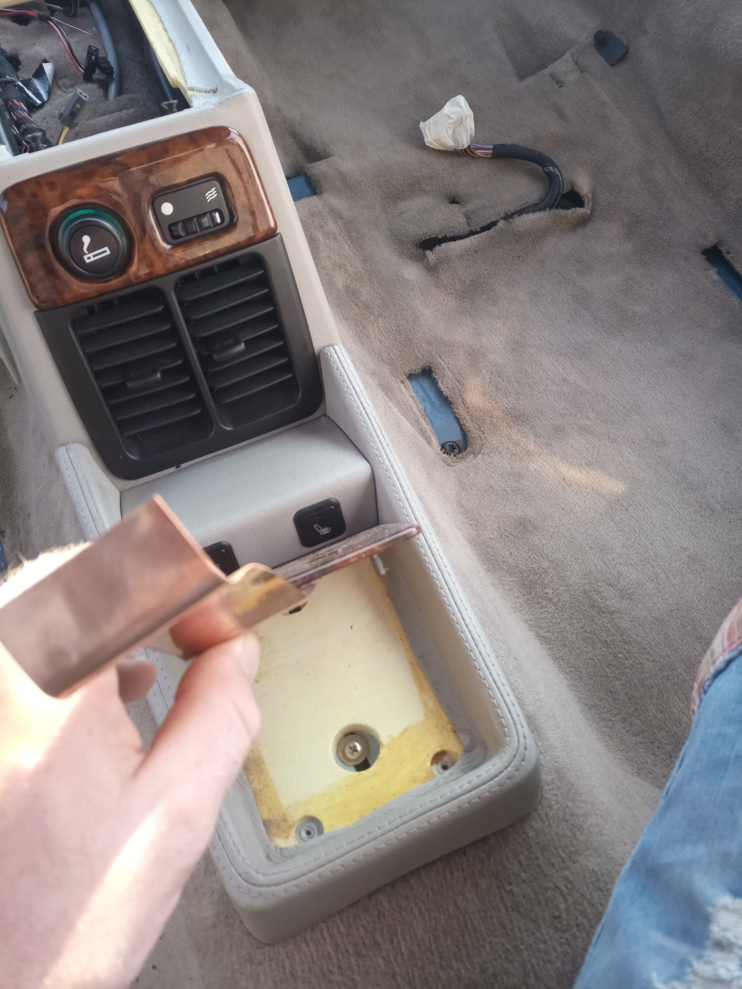

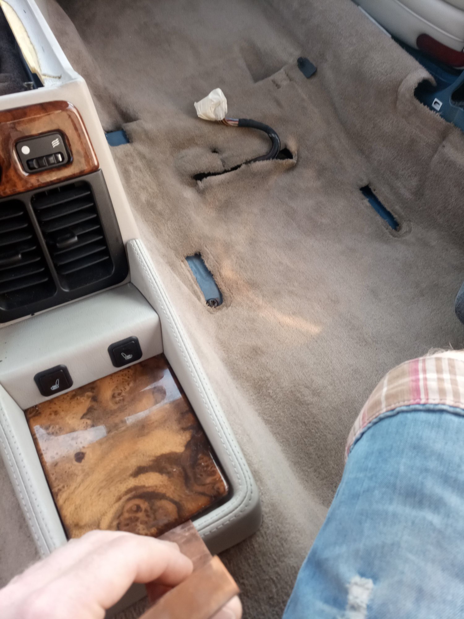

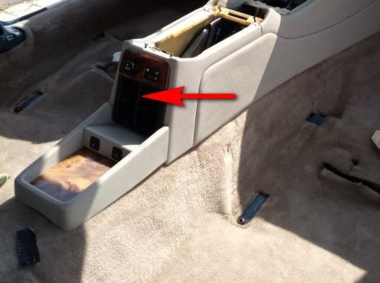

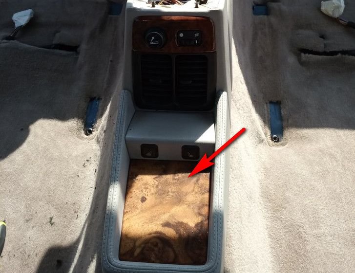

1. Remove this veneer panel in the rear section. Use a hook tool to lift and pull away. There are 2 screws underneath this for the rear section.
2. Remove the rear Air Vent Panel. Screw behind there.

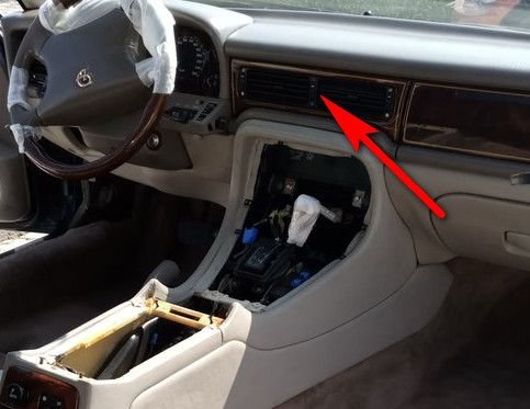

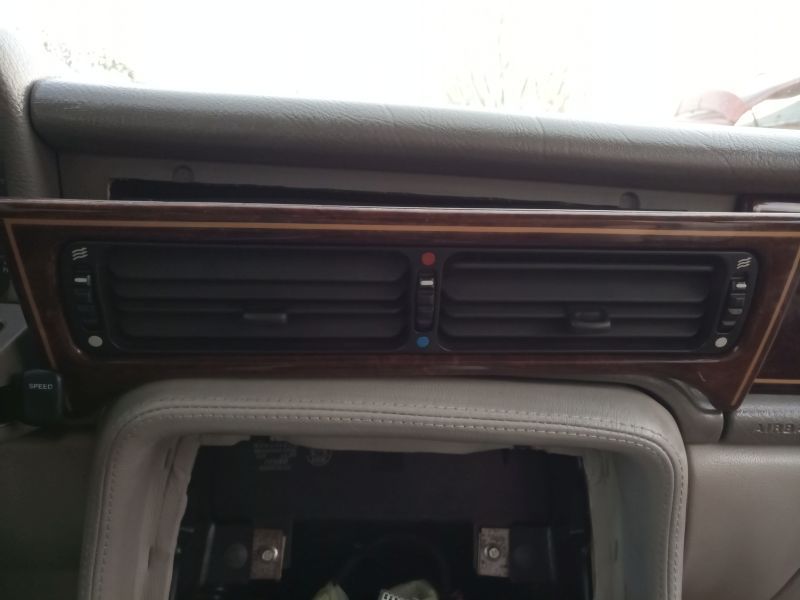

3. Remove the front centre Air Vents and Veneer panel. It's all one piece and just pulls off. There are 2 screws behind there for the top of the console.

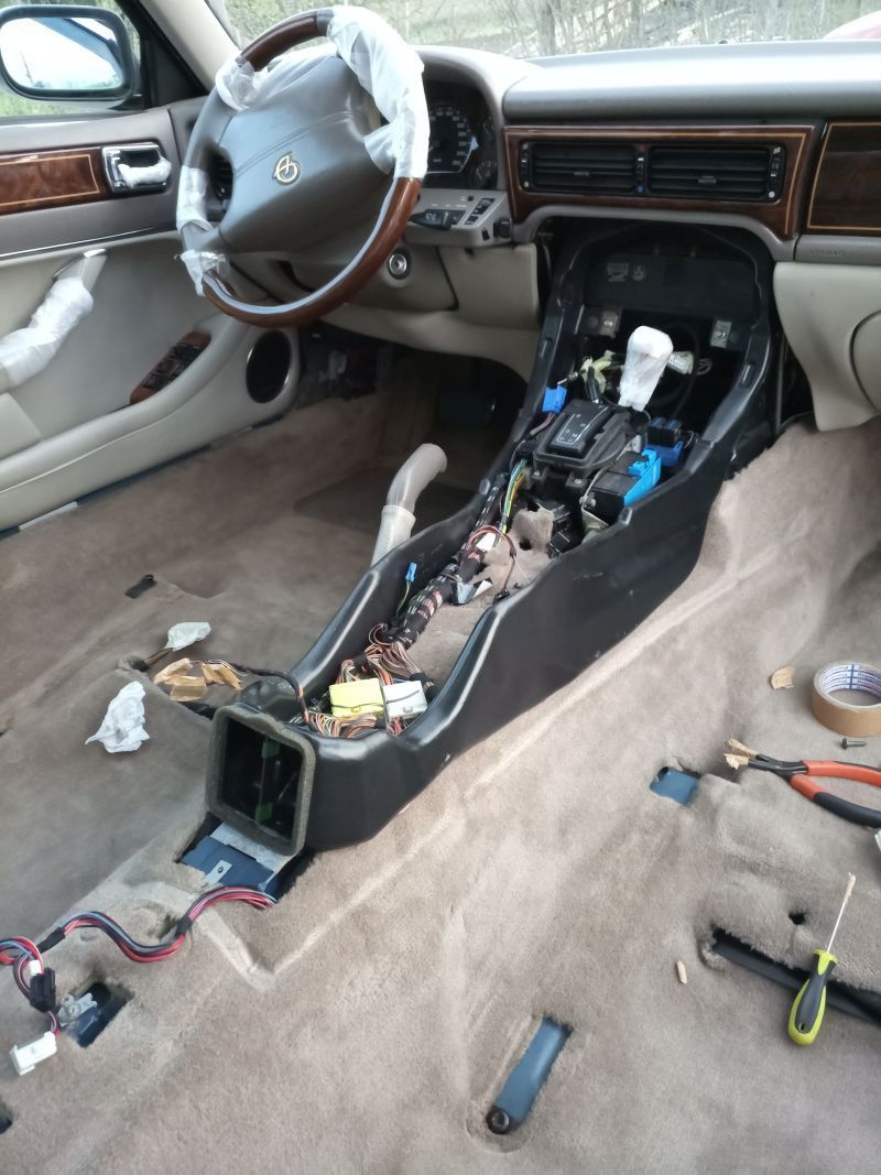

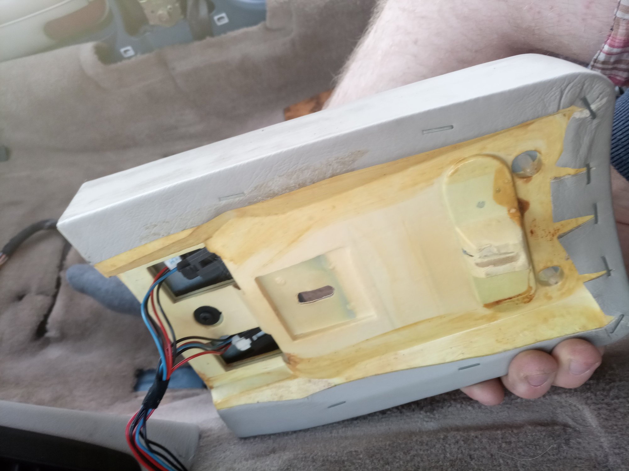

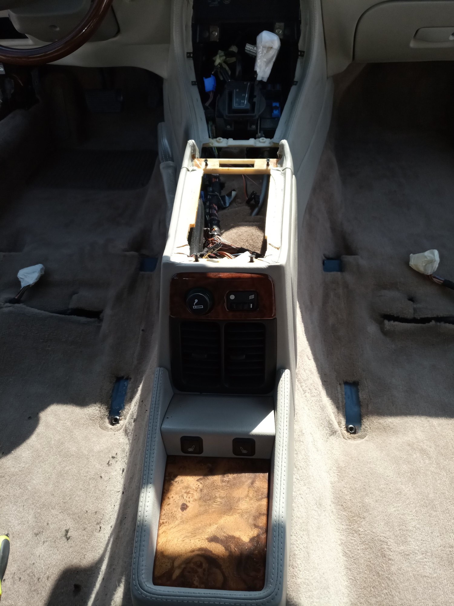

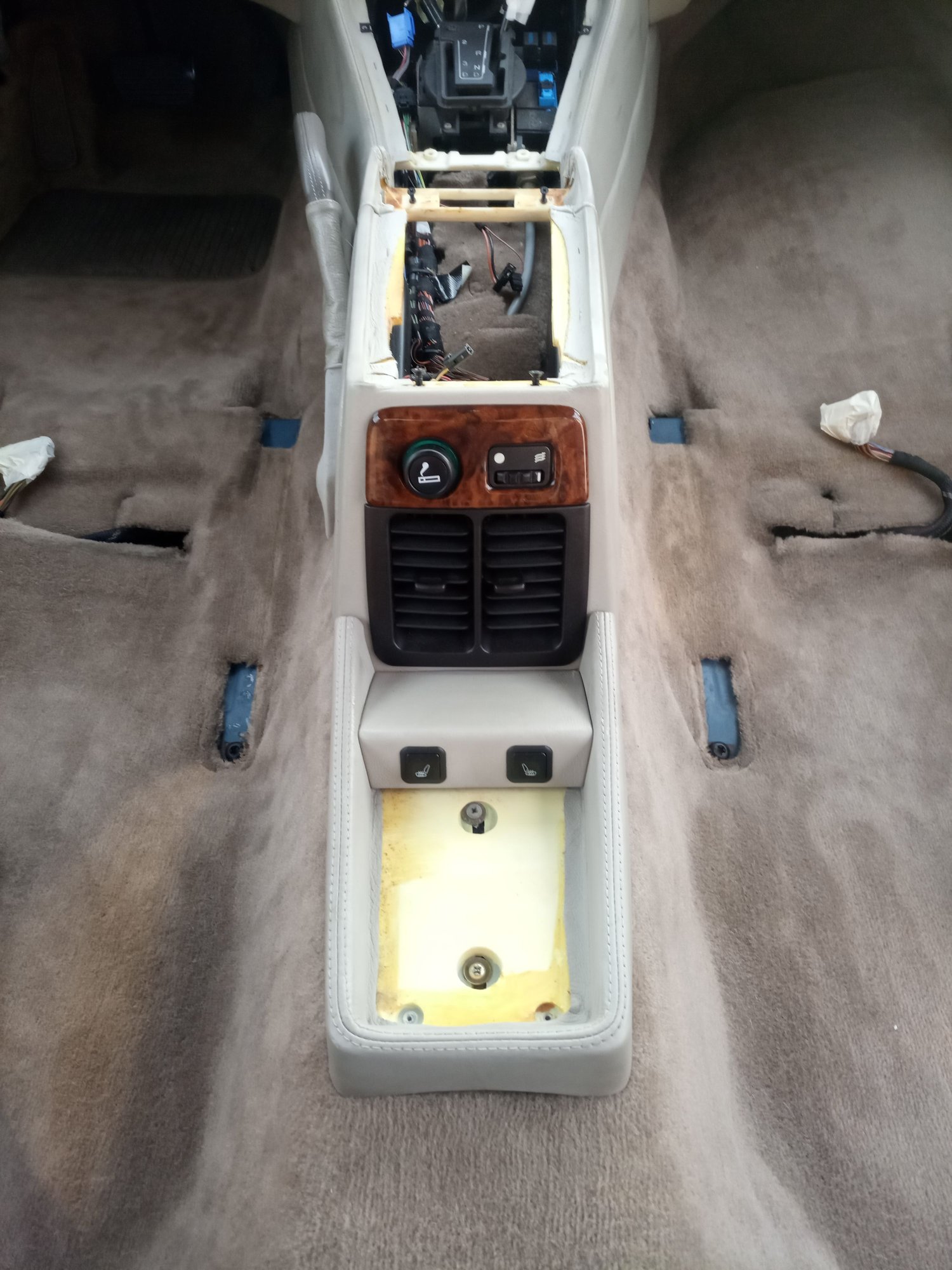

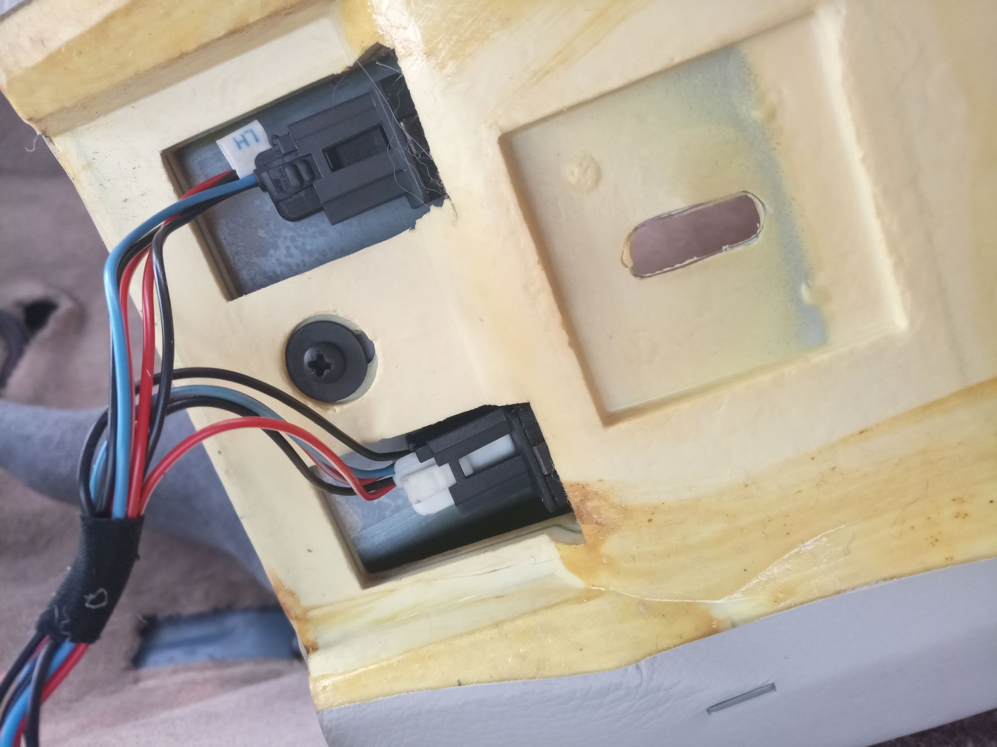

Default Just because good to see how, from Brendan istructions, here is the solution
lift it up carefully
unscrew these 2 screw
unplug them
unplug them from inside, and pull it out
unscrew
pull it out, and under unscrew 2 screw
Finito! Thank you Brendan!
