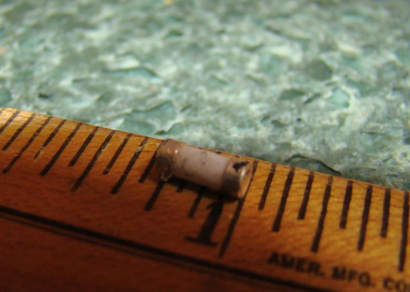

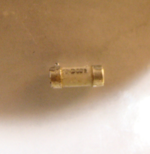

I finally figured out how to attach a picture. Is this a fuse? X500 I believe on the ECU circuit board
Attached Thumbnails DIY Modification to Improve Performance and Fuel Economy of AJ16 and AJ6 Engines-dsc03206.jpg   DIY Modification to Improve Performance and Fuel Economy of AJ16 and AJ6 Engines-dsc03202.jpg
