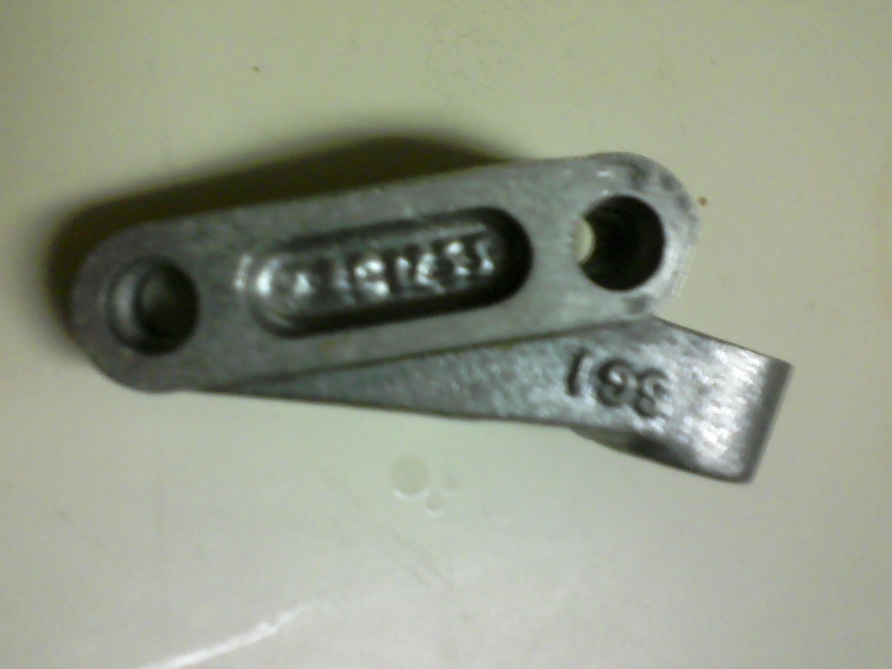

I have one original "leaded" bracket from a 3.6 litre. I used to work at Henlys of Chester back in 1989 and converted my uncle's car to unleaded and he told me I could keep the old bracket. I found it the other day when I was looking through my old tool box. It is in perfect condition as the car was very new when converted. If anyone is interested, I will accept the highest offer received by Feb 22nd.
The part number looks to be either CAC1253 or CBC1253. There is another marking of SG1.
I live in the USA now but if you need more info, please email me.
Many thanks - quite fascinating. Am curious as I thought that all these cars were for unleaded petrol - leaded fouls the lambda sensors. Am I wrong here and were some cars made for markets that had only leaded gas? Do you know what the difference is with a standard bracket?
