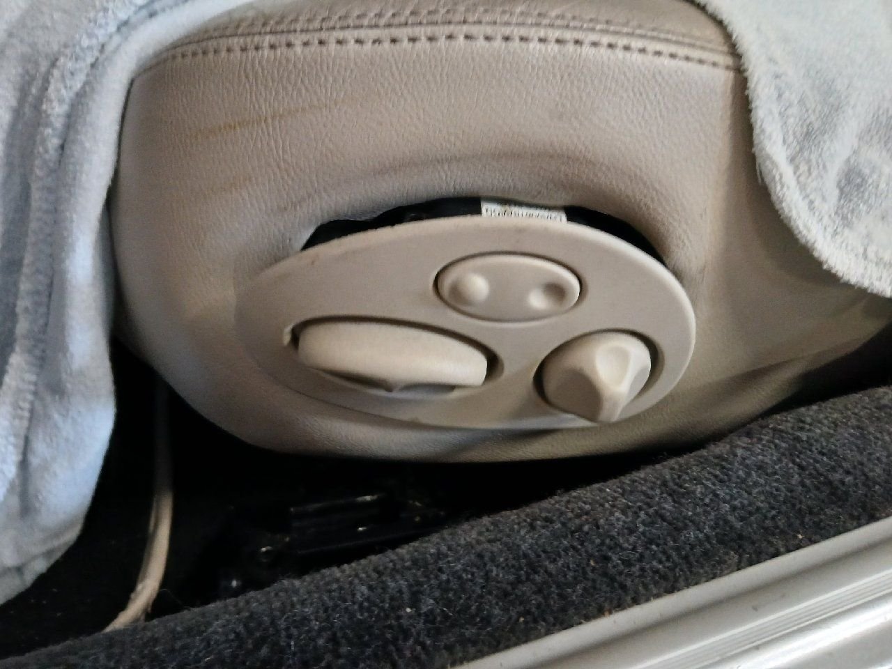

Recently purchased this car. The switch panel was hanging loose, something in the black plastic that holds it in is broken. I considered using sealer to glue it in place. But here's the thing. All switches work except seat forward. Strangely that works when I press the whole panel hard into the seat. I can't get the forward to work unless panel is pressed hard into the seat.
Something inside the switch? Is that fixable for a non-electronic-wizard?

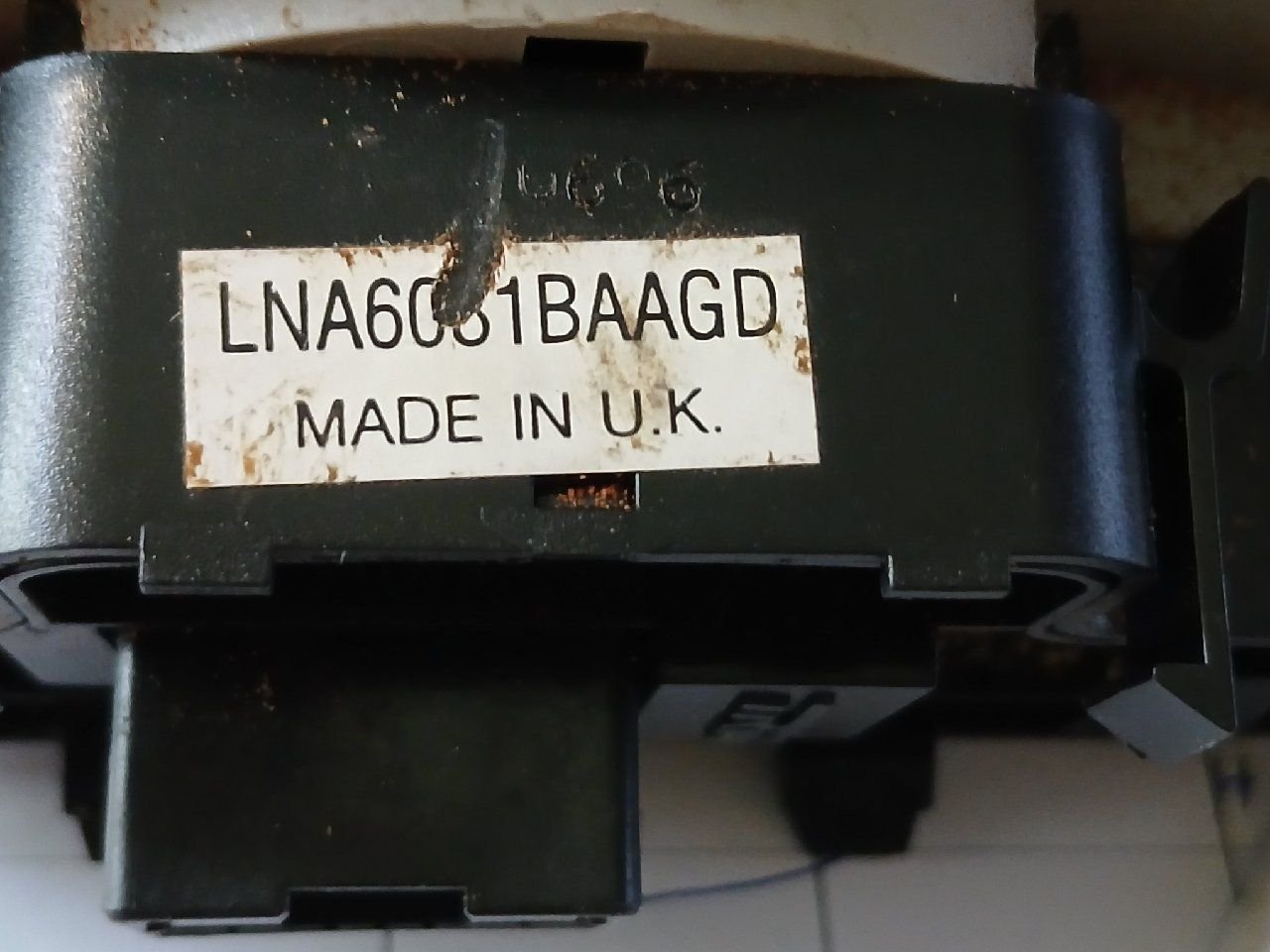

I considered a new switch. If everything then works and it sits where it should on the seat, worth buying. But there are so many part#s on these, so will they work on mine? Is color part of the part#? Mine looks like LNA6061BAAGD. What is the name of the color in Jaguar terms?
Yes. The last three characters AGD is the colour. The colour name for AGD is Oatmeal.
