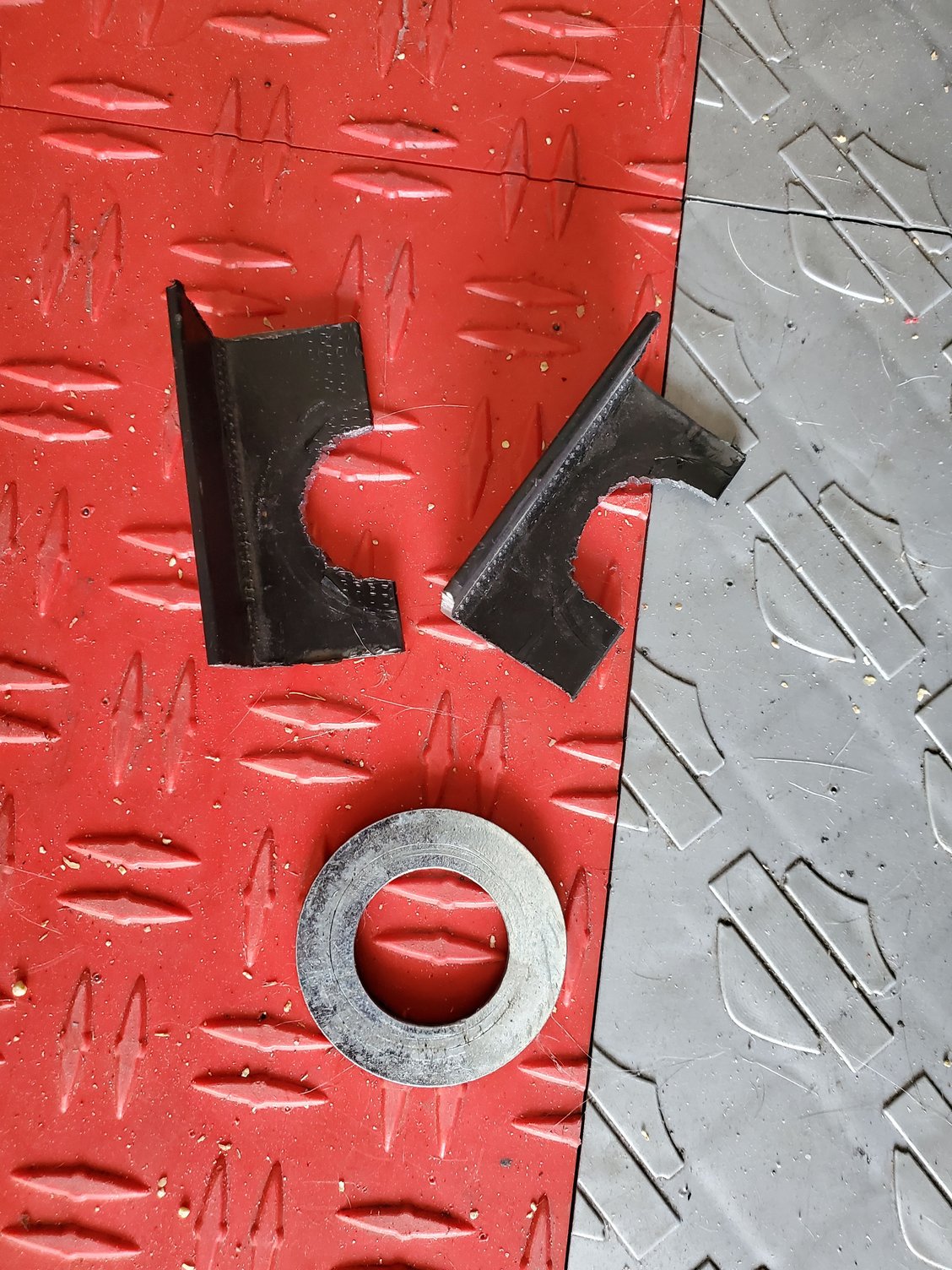

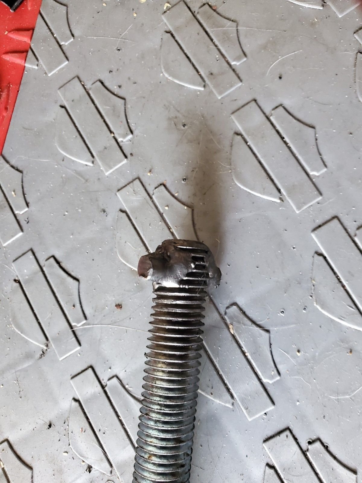

I just finished replacing the front control arm bushings,ball joints and inner & outer bearings and seals. Not a terrible job to do, looks worse than it is. First off , the Jaguar tool #JD115 is around $600. I made mine using some examples on the thread "JD115 front spring compressor". As far as the bushings are concerned, I pressed mine in and out using a Harbor Freight 20ton press, $250, and all the big sockets in my tool chest....You'll need a grinder too, for the front lower bushing as it has a shoulder that covers the surface you'll use to press out the old one. Also its easier to cut off the extra rubber off both the lower bushings so as to get a better purchase. The uppers are a bit tricky pressing back in as you have to make a plate to engage the bushing at the pressing surface. I made mine using a piece of bed frame. Next, its easier to press the arm onto the lower bushing by using a bored out flat washer to support the bushing. Once you look at all your bushings it'll become clear. You can look at the pictures on the various suppliers websites also.
Now for the spring compressor. I used a length 3/4" threaded rod from Home Depot, along with a coupling nut and some washers, a 5/16-3" grade 8 bolt. I started by double nutting the threaded rod then center punching the nut and drilling it 5/16" about an inch from the end. I then welded in the 1 3/8' long shank. With that being done I got the biggest hitch ball Harbor Freight had and bored a 3/4" hole in it and cut it in half. Then I welded two pieces of rebar to the coupler nut. I also ground two flats to either side of the end. These help in determining where the pins are when the tool is inserted
Taking it all apart is always easier than putting back together. Once you get to the point where you're ready to use the tool, A WORD OF CAUTION!!! The spring is under extreme tension. Use a lot of grease on the threads and between the thrust washers. It is possible for the threaded rod to turn out of the sub frame and launch. (You ask how I know that) That being said, should you feel any resistance while turning the coupler use a wrench on the flats to insure that it doesn't unseat. When initial installation of the tool I lock nutted the coupler so that the turning bars were inline with the pin at the top and makes for easier handling.
Of course I didn't take any pictures of the procedure otherwise I'd still be out there....Sorry But i did take pictures of the tool
compressor tool, after completion of job (no sense showing a tool that doesn't work) awl is for aligning bottom plate and tube w/ grip is for some leverage
details of the assembly
pin is at an angle so it looks shorter than it really is
besides the bunch of sockets I used, I needed to make these to facilitate the pressing
