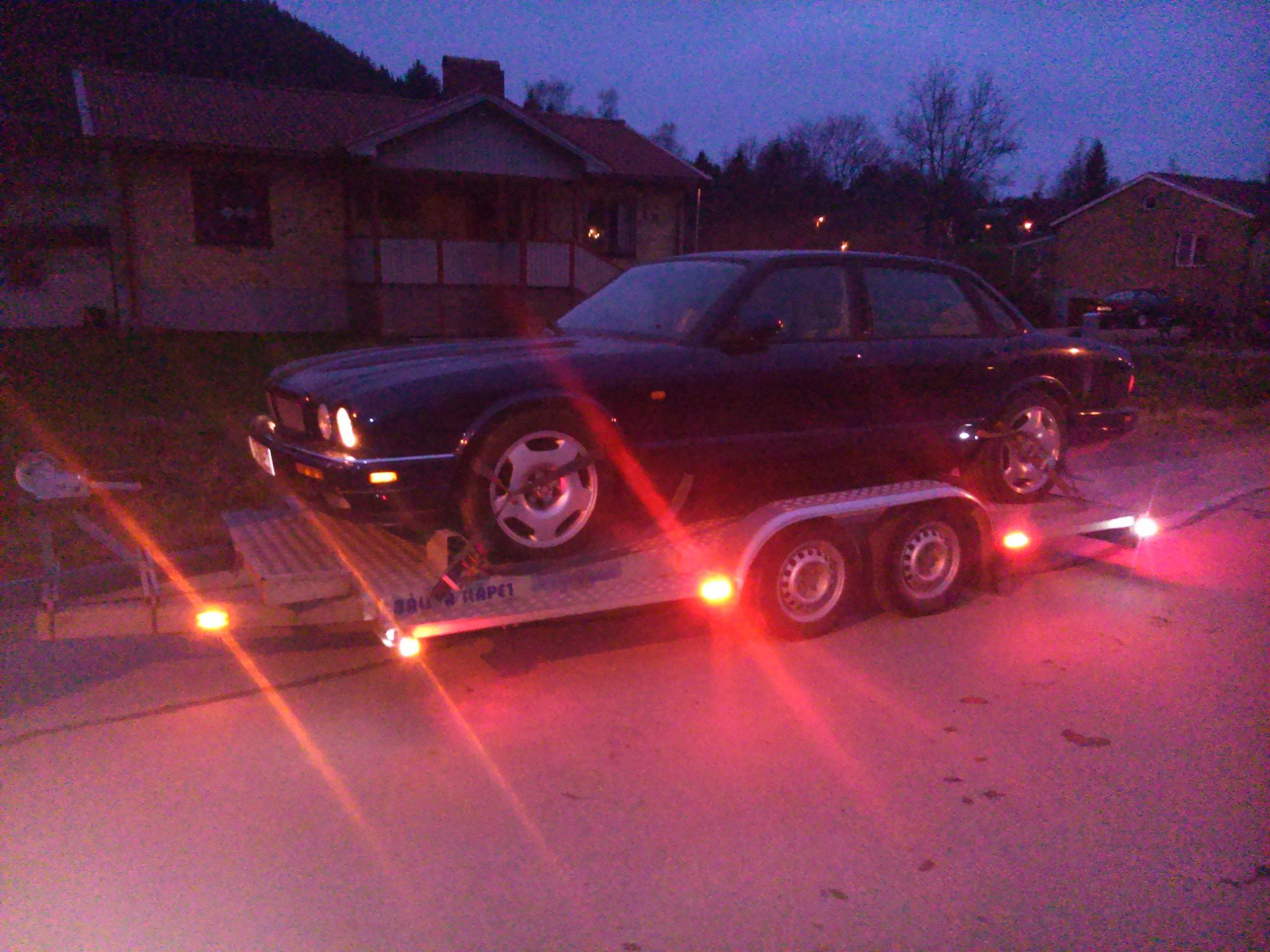

Hello Jag lovers. I'm a long-time forum lurker turned new forum member. About five years ago i bought a manual transmission XJR6. As you probably know they are quite rare , I have been told only 279 cars were made. So it took a fair bit of hunting before i found my car. Then 2 years later, I got wind of someone in Stockholm thinking about building a drift-car out of another manual transmission black on black XJR6. Naturally i could not just stand by while some snot-nosed kid thrashed a unicorn like this to death so i bought it. This car is not beyond saving but it needs a fair bit of love. Paintwork is real bad, some light rust, cracked exhaust manifolds, and pretty much everything under the bonnet made of rubber locks like it will have to be changed. So will all of the bushings in the suspension.
this is a picture i took polishing the "turd". and too think that they were going to slaughter it on the drift track!!
