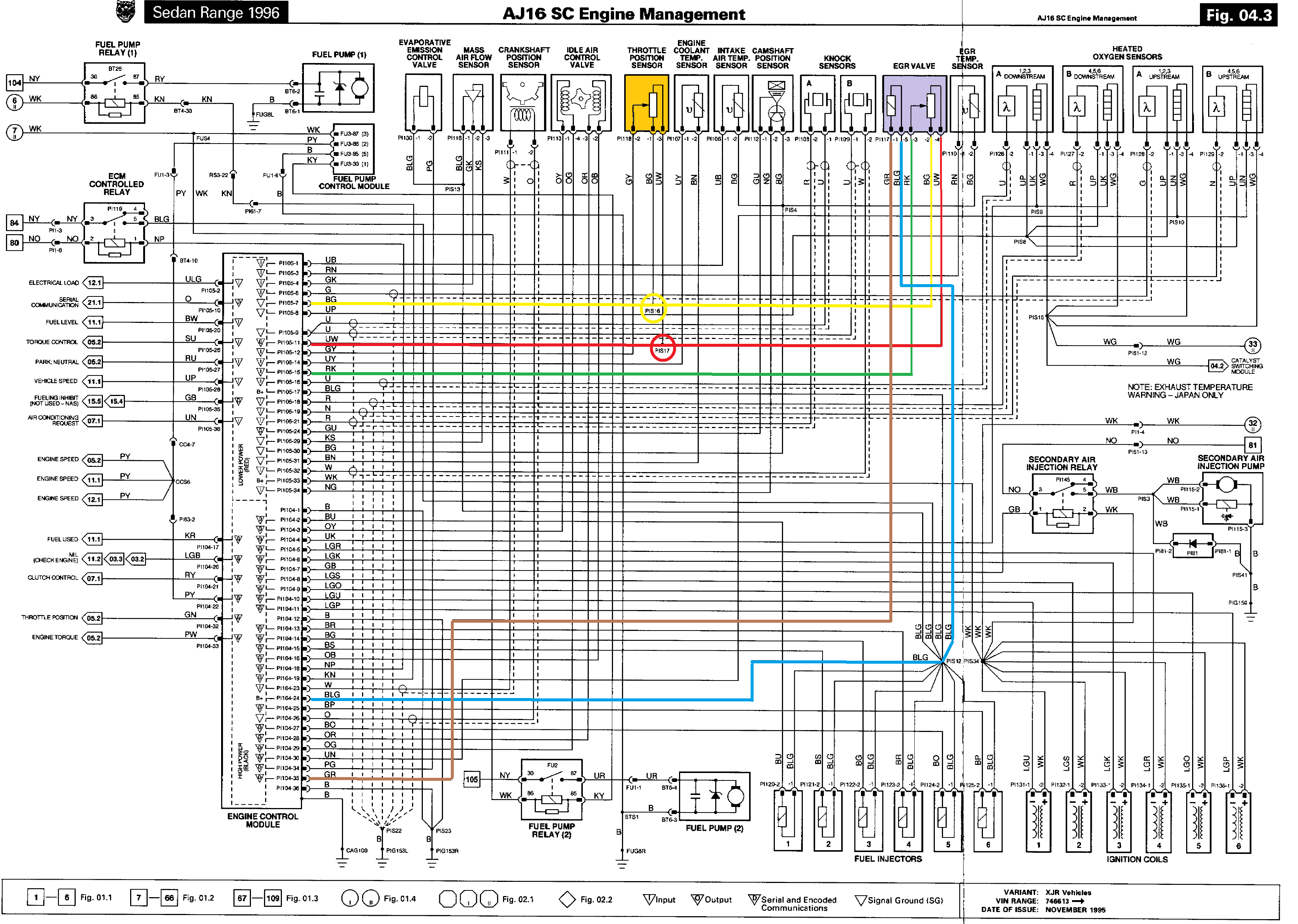

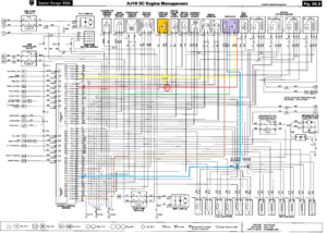

Proper connector hookup to the correct connector is important and may be a source of problems although I have not experienced it myself . On the AJ16 engine the #1 cylinder is the forward most position ( opposite of the AJ6 ? ) . So the B1S1 ( bank 1 sensor 1 ) is on that pipe forward of the forward Cat . B1S2 is aft . On the ECU side of the connectors they have the same wire colors with exception of the one important return signal wire to the ECU .
B1S1 Green
B2S1 Brown
B1S2 Blue
B2S2 Red
Not to be confused with the term orientation as this is a requirement to have the Jaguar shop " match " the changed sensors with the ECU under certain ( unknown to me ) conditions . Some readers may already know this but this information is for others that are new to this . Hope this helps some people . Clean your sensor shield grounds locted on the left upper engine firewall that has multiple wire terminals .
Attached Thumbnails New Codes (95 XJ6)-x300-o2-heaters.png   New Codes (95 XJ6)-x300-egr-sc-untitled.png
