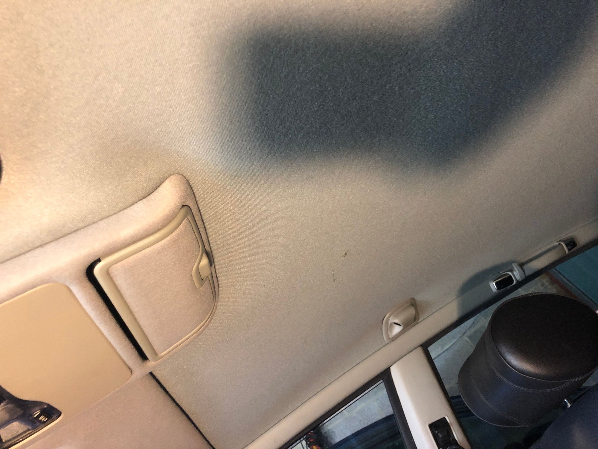

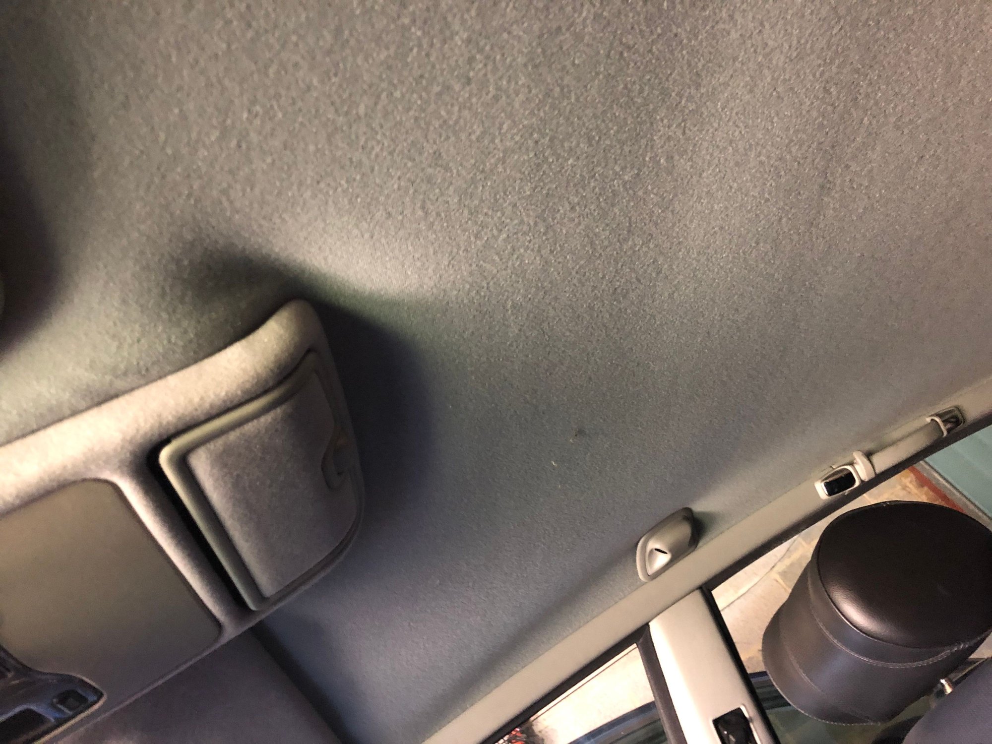

Now I'm not so sure, what colour my headlining is, in some lights I'd say grey, but in others oatmeal.
Is there a code on the car somewhere?
If it's any help, it's an XJR in Spruce Green with Charcoal leather.

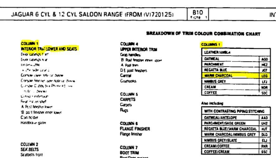

A discussion from January where I learned of the two colors of headliner fabric:
Headliner Fabric Color
A "Warm Charcoal" or black leather interior (code LEG) will have a "Nimbus Grey" headliner (code LFJ). Maybe this will help.

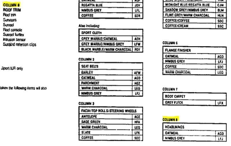

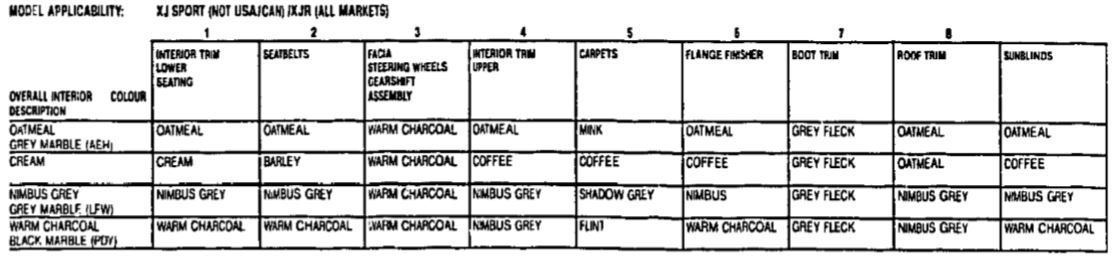

Ah yes, interesting.
It's difficult telling whether it's a grey or an oatmeal; with flash on it looks oatmeal, with flash off grey.
So the PDF would suggest I have Nimbus Grey, since I've an XJR with Charcoal leather. Have I interpreted the chart correctly? Is that enough to go on to be sure I've got Nimbus Grey headlining?

Yes... I was editing my above post to include the correct code of LFJ for "Nimbus Grey" fabric. Hard to tell the two apart unless side-by-side I think.

Parts listing shows LEG leather as Warm Charcoal with roof trim in Nimbus Grey.
Copied from the pdf parts listing - see the attached (if not too big to post - not showing in Current Attachments)
Page 8 Trim Chart
Page 10 Breakdown Of Trim Combination Chart
I got Martrim to send samples to confirm the colour match before ordering.
