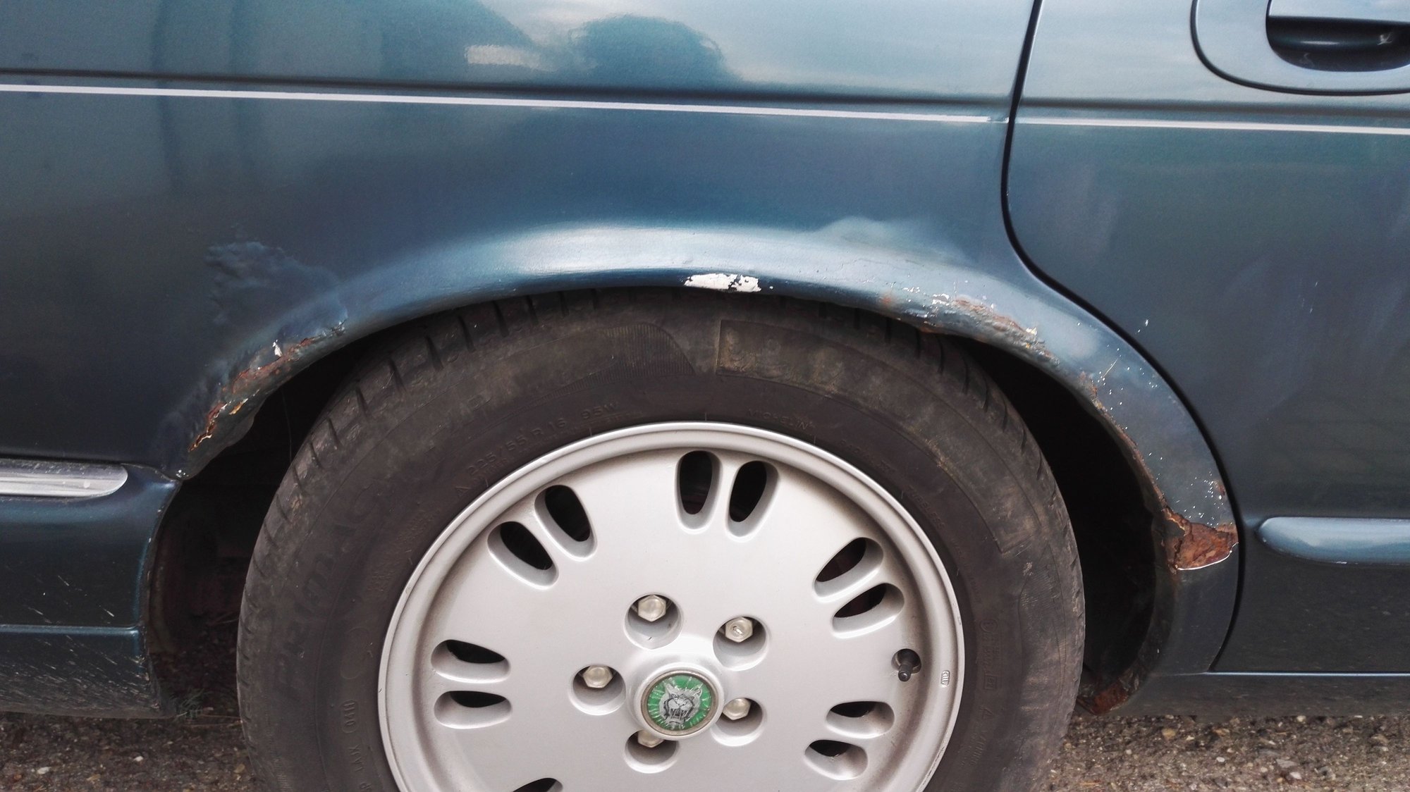

The initial situation

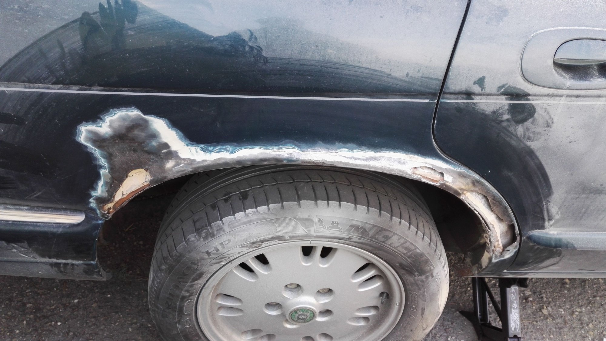

Rust being removed - Nice holes

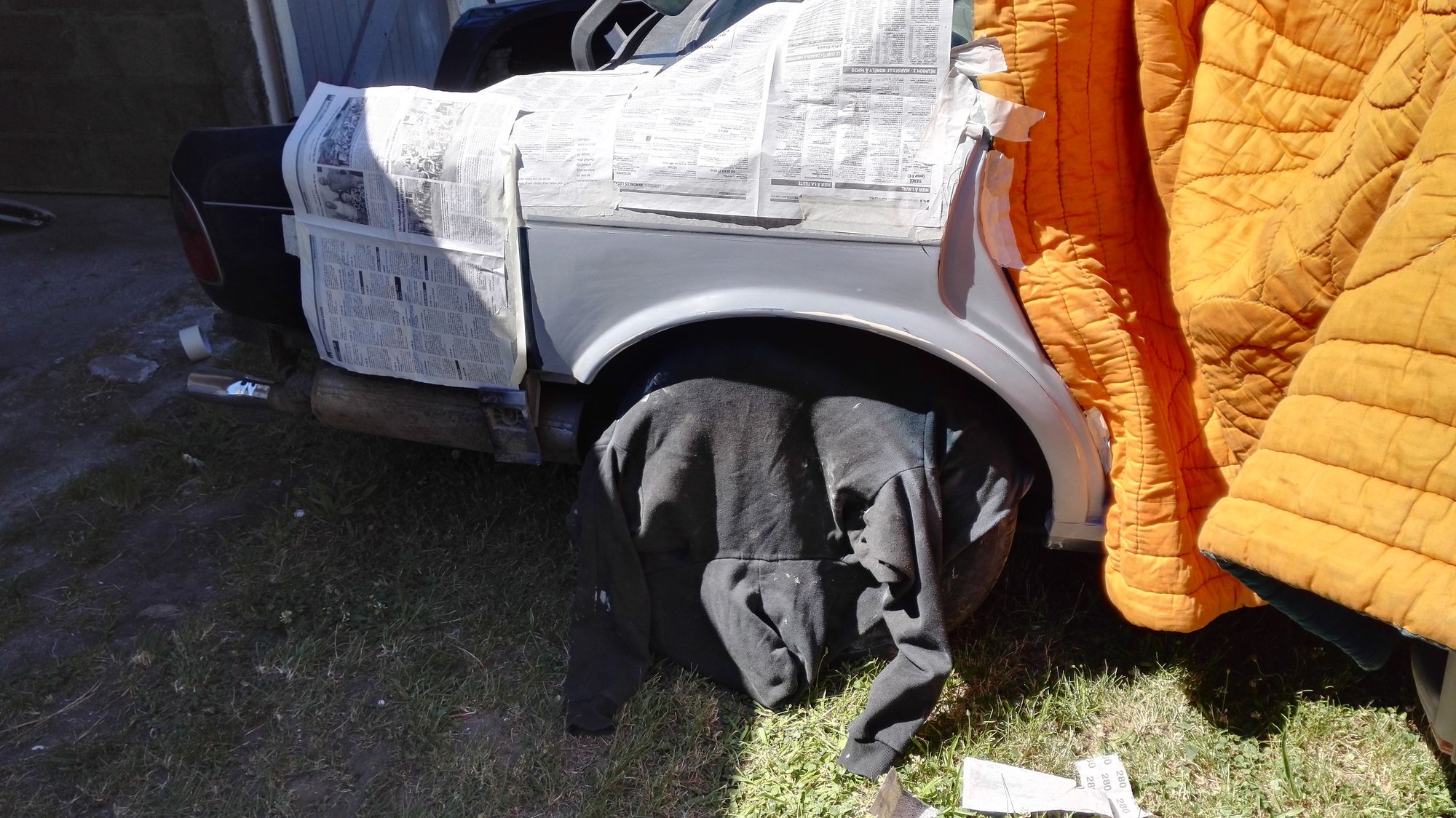

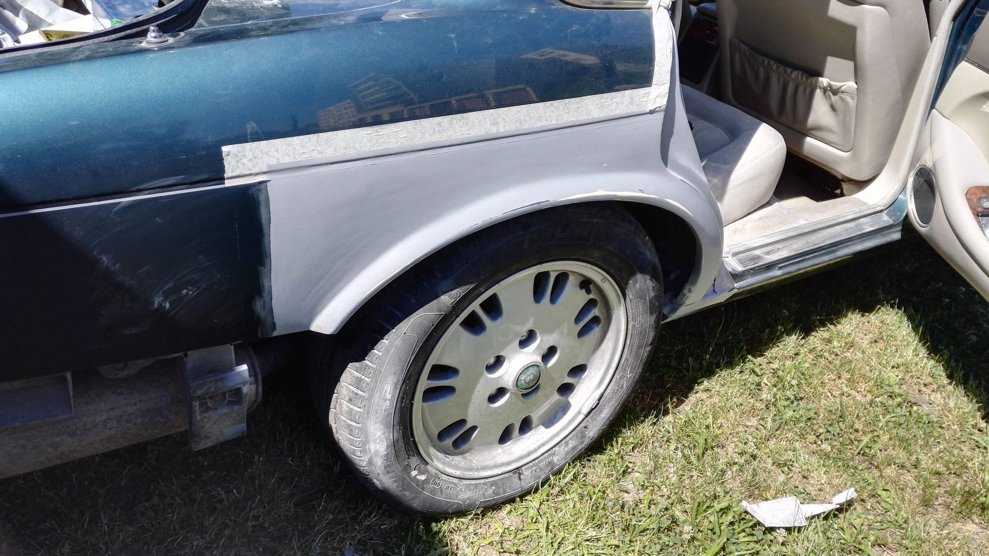

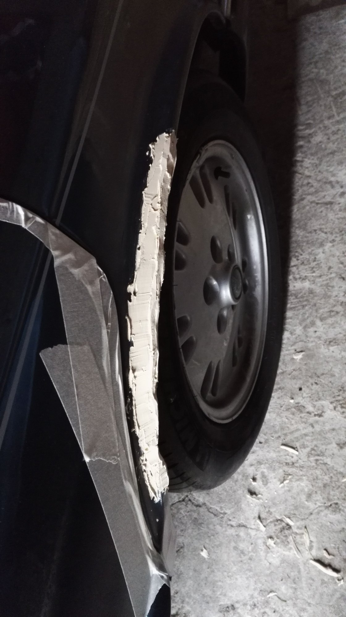

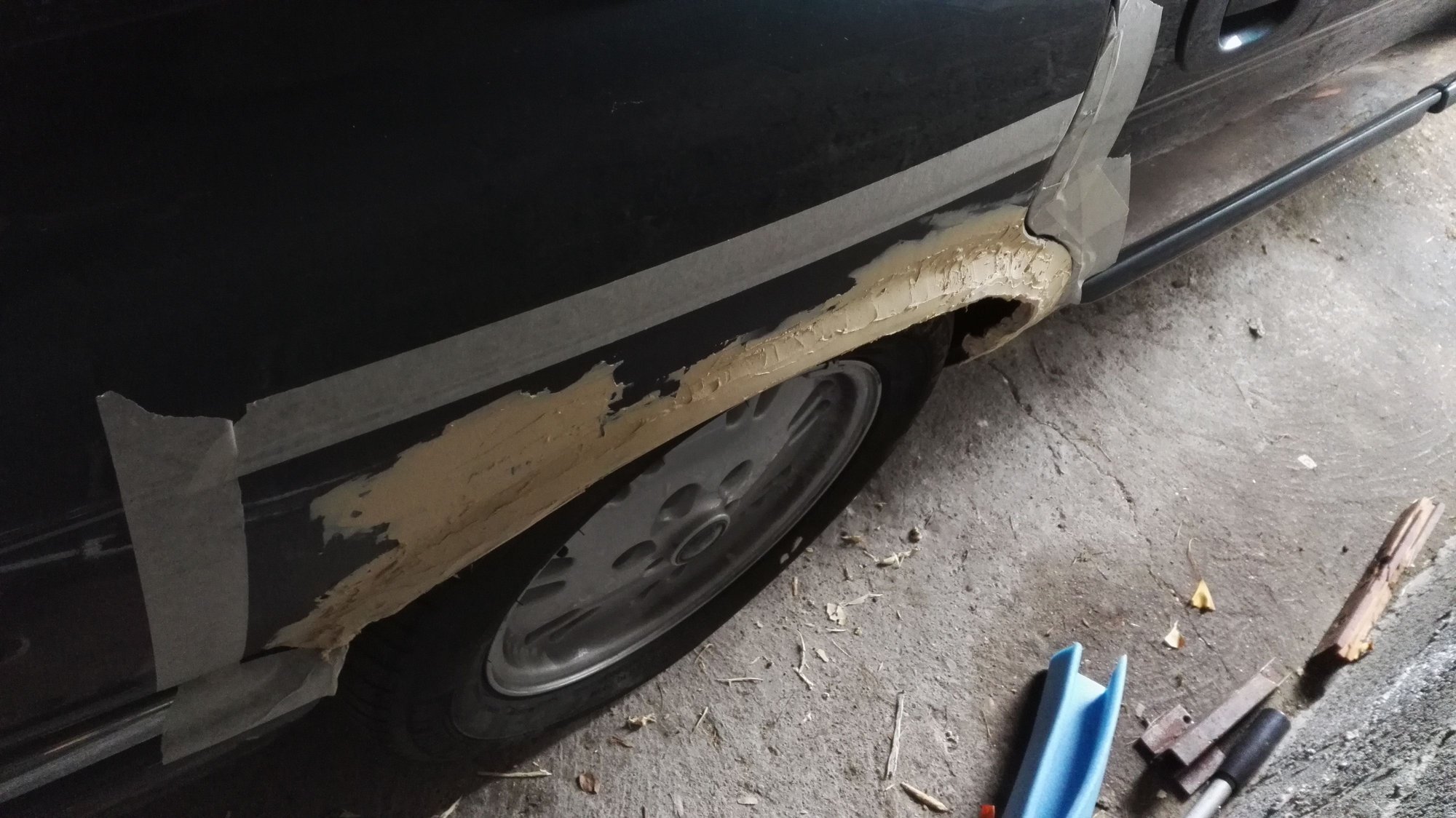

First skim of filler - Not very nice
Then sanding and sanding again, filler and filler again

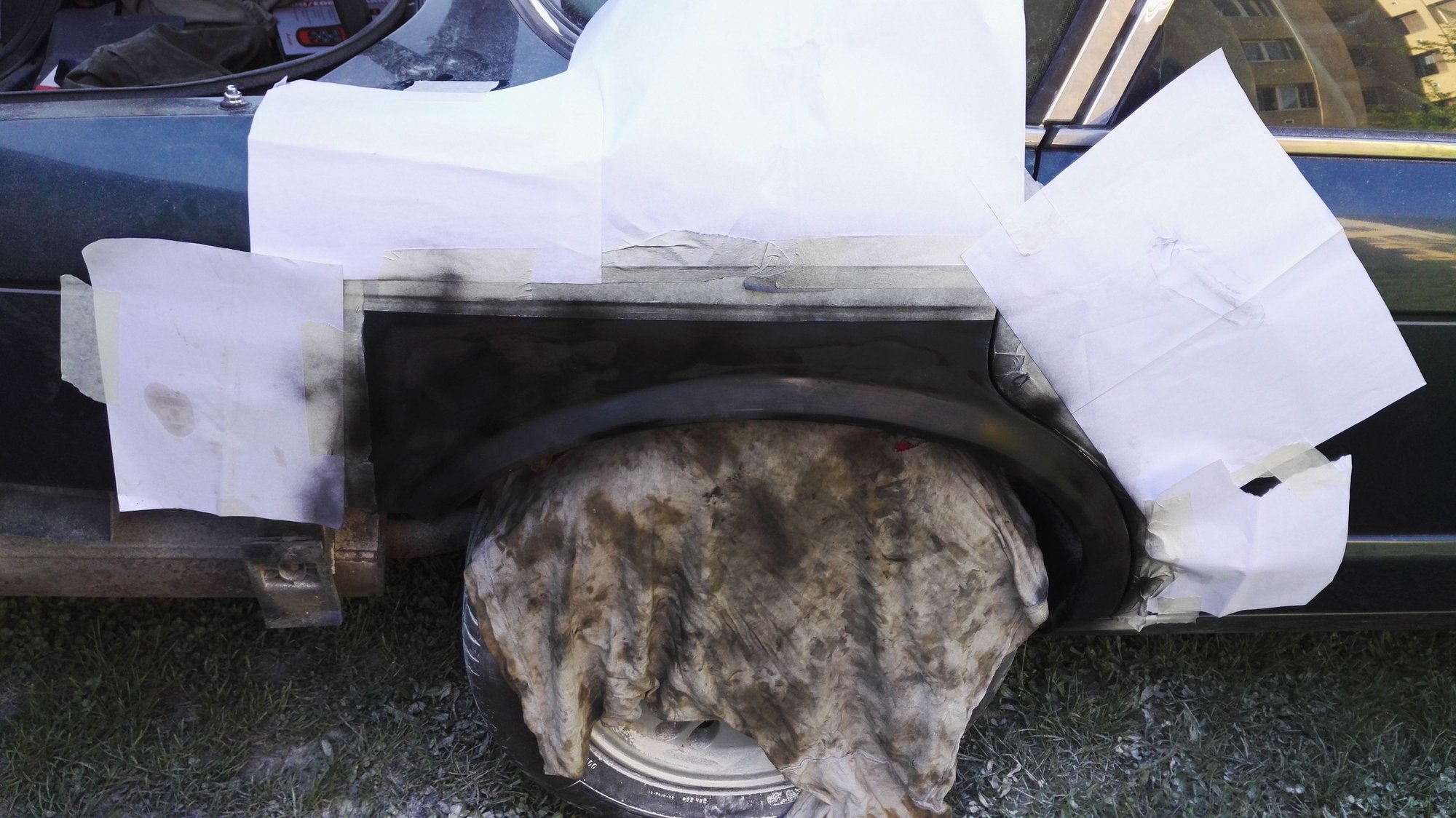

Primer ! And then wet sanding again

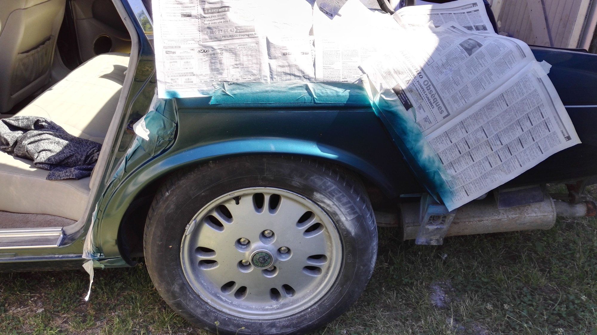

And finally paint and varnish !
I used 2 cans of paint and 1 of varnish. Wet sanded between each layer.
