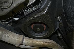

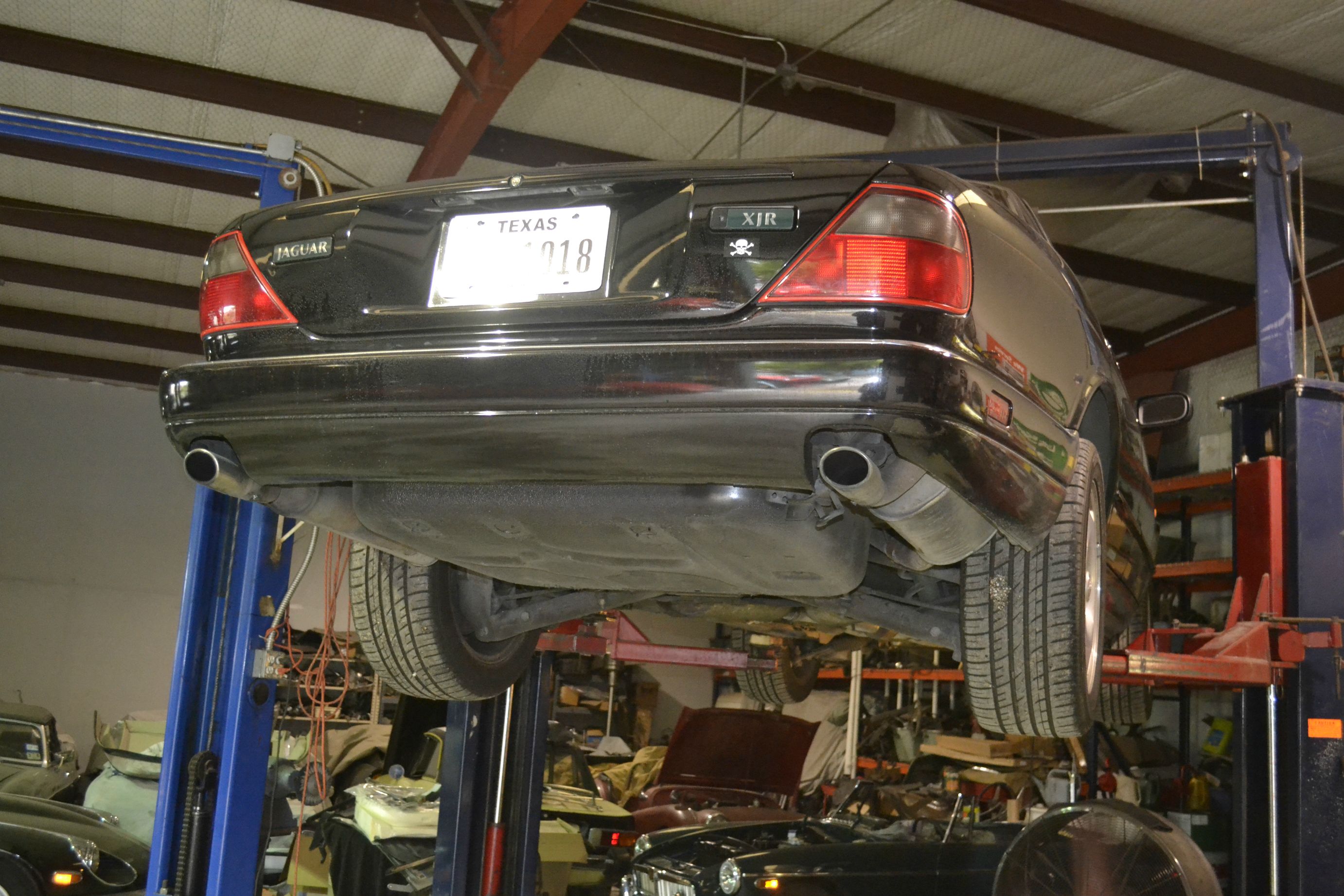

Took the XJR to my friend's shop (shameless plug: Sports Car Warehouse) and replaced the drive shaft carrier bearing and expansion joint. Problem solved.
Next for replacement transmission mount and missing exhaust mount.
Carrier bearing before replacement
Bad transmission mount

My car among some older British relatives!
