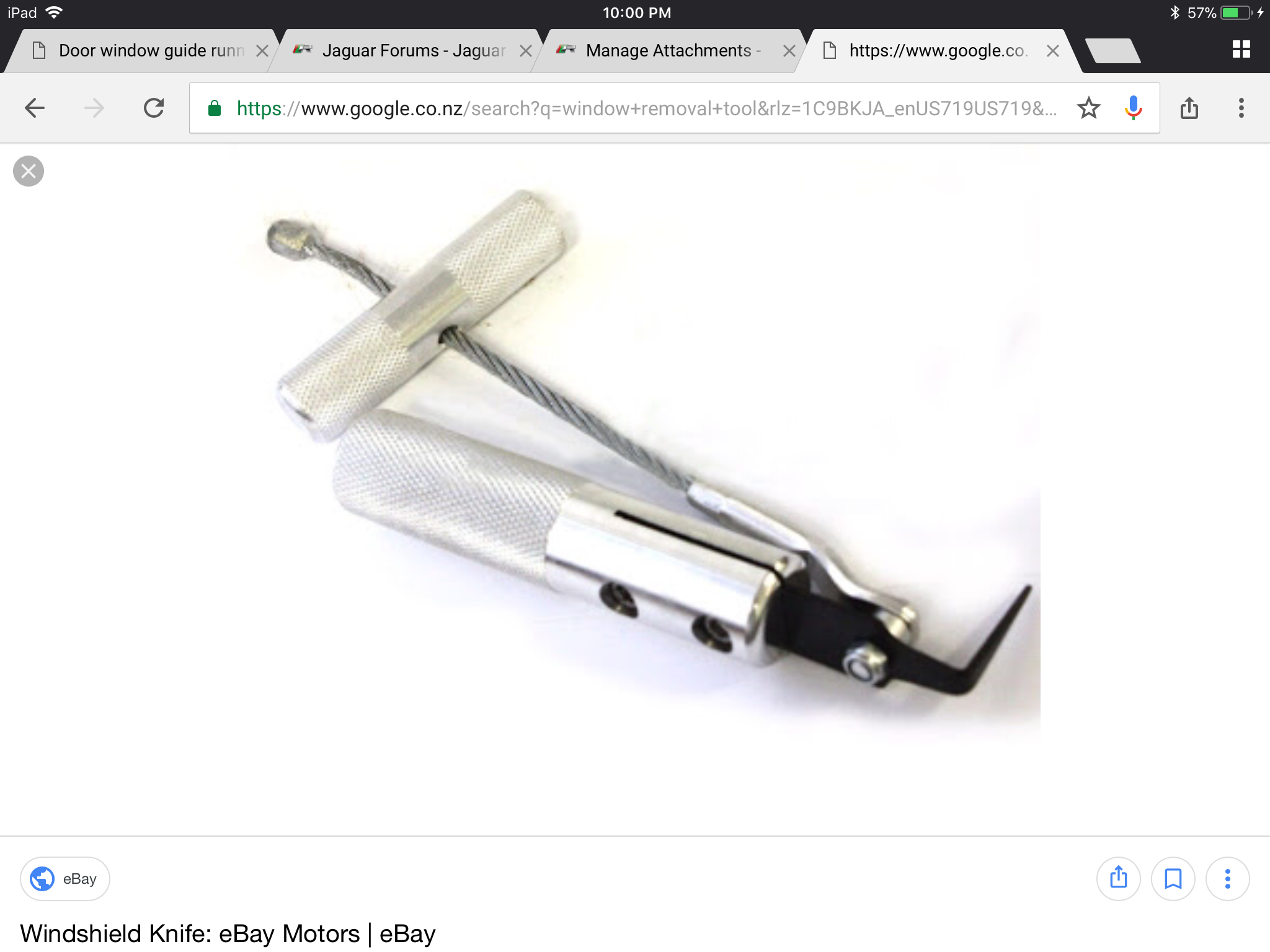

I removed the trim and window on a ‘40 using a hooked blade
Rust under window frame/seal-438e273b-7f80-4958-a6a2-b25d3093552b.png
Easy enough to do. This gives you clear access to the area to repair, then just get a mobile screen guy to replace the screen.
