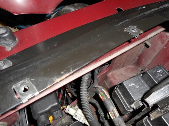

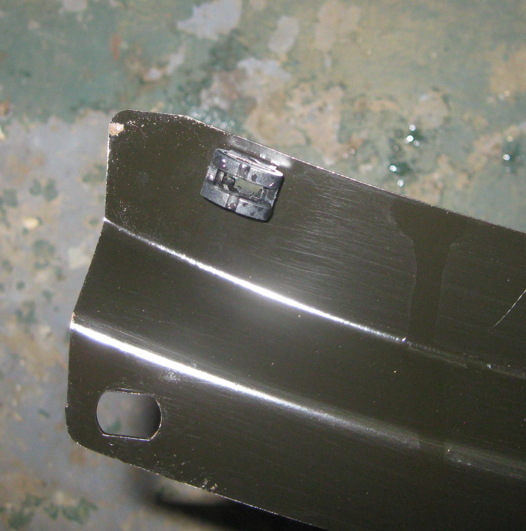

Question What do you call this locking "T" clip? Part number maybe?
Another quiz for the community
... seriously, I am missing a few of these screw "T" clips that hold a variety of panels secure in the engine compartment.
I have several of the "T" male portions, but am missing a few of the female receivers that clip into square holes.
So I am wondering what these are really called, and if someone may know the part # for the set, or both the male and female part if they aren't a set.

Whew, they are available, but they are pricey.
The male part isn't toooo bad, a little over $1 each, but still expensive considering.
The female "nut" is really expensive, from $7 -$10 each depending.
Think I'll be scrounging some junk yards first

Well, funny thing.... while replacing the bushings for my radiator and condenser, and had the undertray off...... I was poking around various wiring, etc and what pops out and drops on my head but one of the female 'receiver' clips. It was super dirty, as it clearly had been caught up in there for some time after getting knocked out, but it was still good. So I clipped it back in and it was good to go!
So I saved $11 and now I'm just down one

Not willing to pay that much money for the 5 of 6 lost quarter-turn-nuts I thought about an alternative. The square hole measure 9x9mm (sorry, I am a metric guy). Searching around in the net I found this kind of nuts, in German called "Käfigmutter", leo.org translates them "cage nut" or "captive nut". In M4 the size is exactly 9x9mm.
10 STÜCK Käfigmuttern Edelstahl A2 M4 0 3 0 9mm FÜR Loch 5 3 Cage Nuts | eBay
Today I tried the nut on the left side, it fits perfectly. I just need a M4 black screw now with suitable washer and it is fine (for me):
For the picture I just took the original washer and a standard M4 screw.

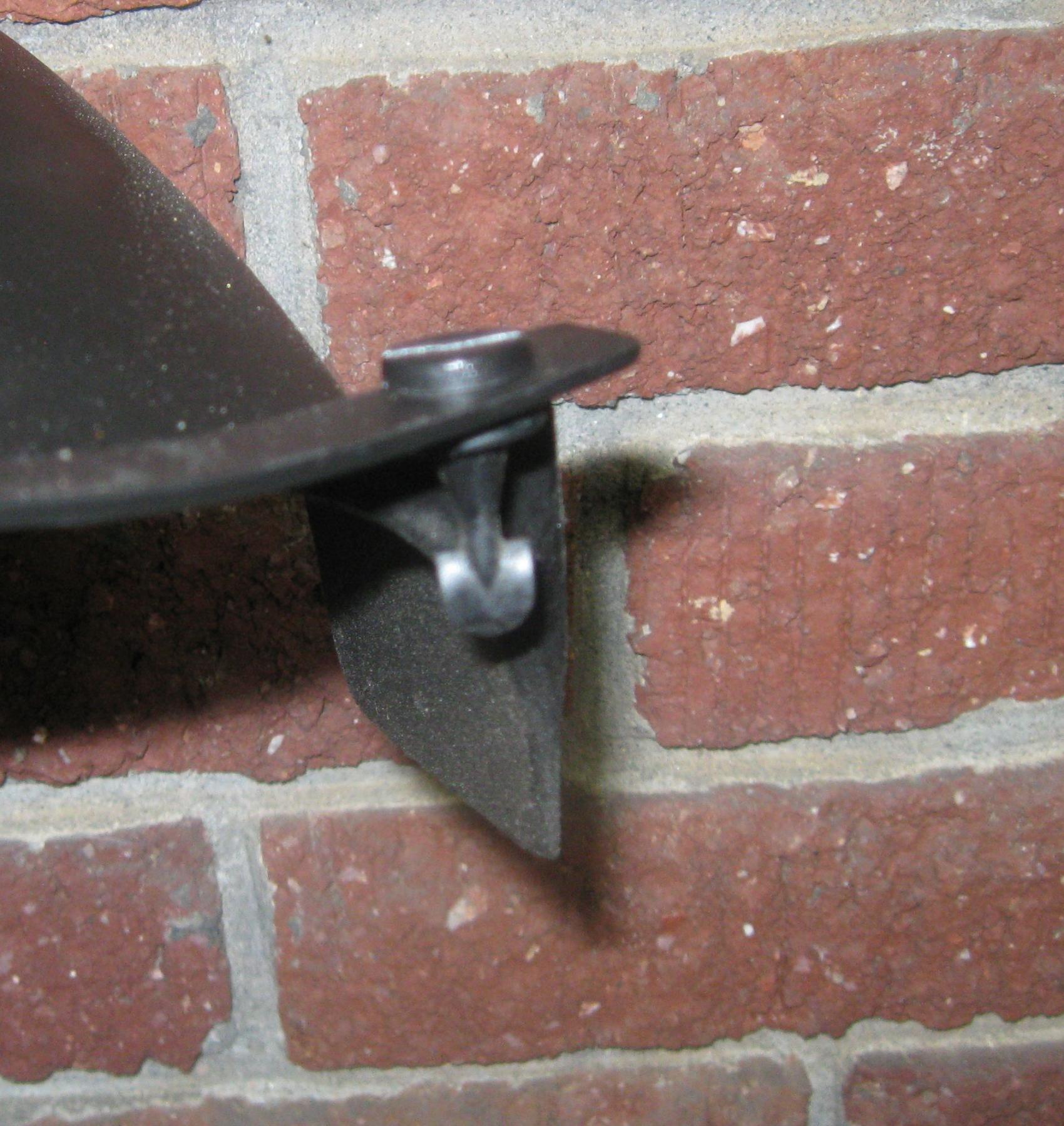

My quick & easy solution to this matter was done by me some years back, using a couple of speednuts which slide over the panel & then have 2 black mushroom heads self tappers installed. Easy to remove & no more broken plastic clips. Pictures attached.
