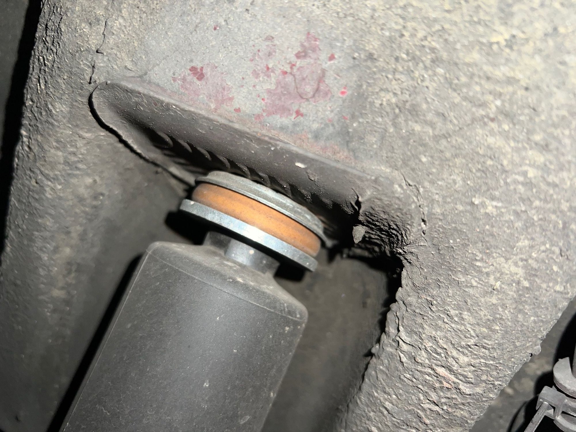

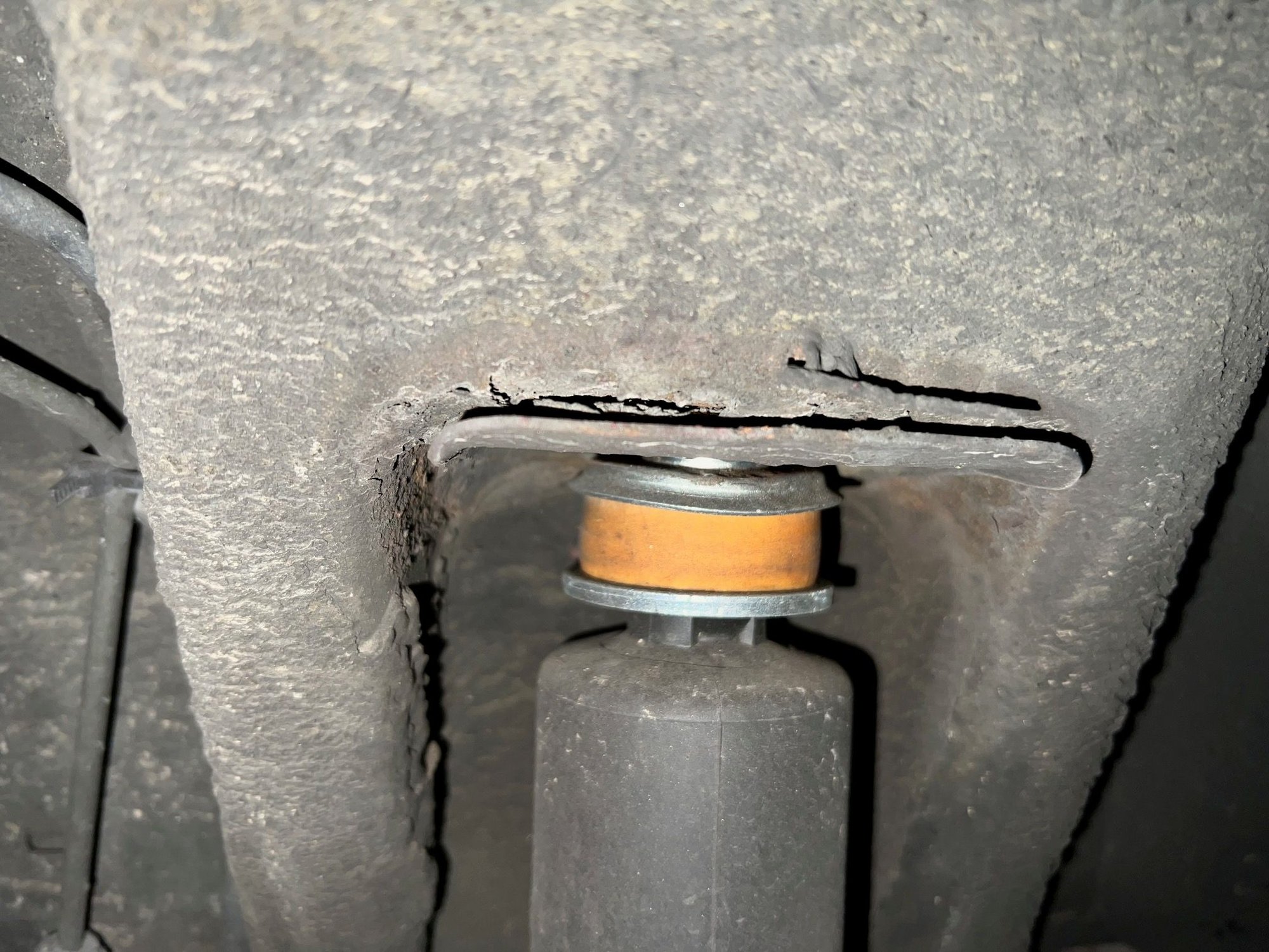

So I put new 24-018616 Bilstein Shock Absorbers (Bilstein B4 OE Replacement Shocks Set for 1990-1997 Jaguar XJ6 RWD) on about a year ago and I have also put on the monobrace with new bushings. I used the bushings that came with the shocks ...attached. The only thing that I can think of is the Vmounts but not 100% sure where they are and how to check if they need to be replaced

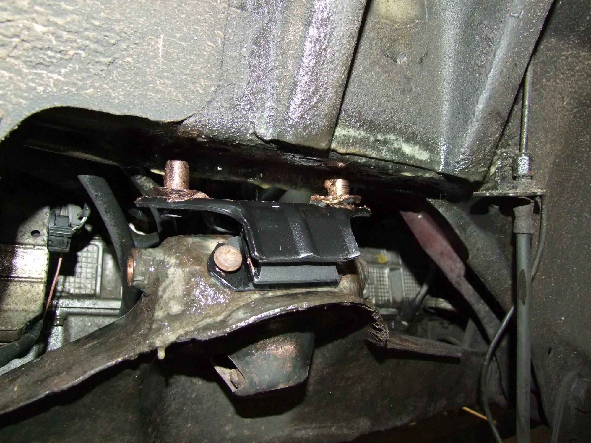

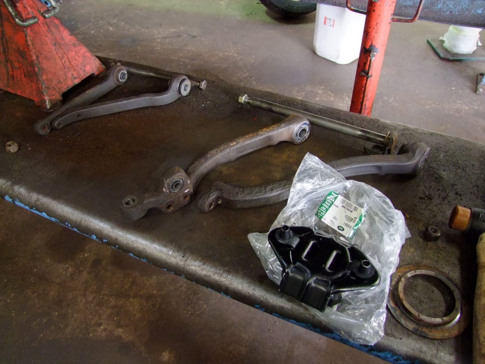

These might be what you mean

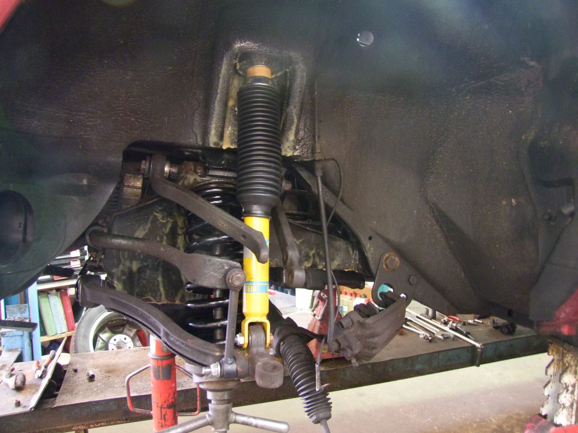

And are you sure about the shocks, mine look like this (uncompressed).

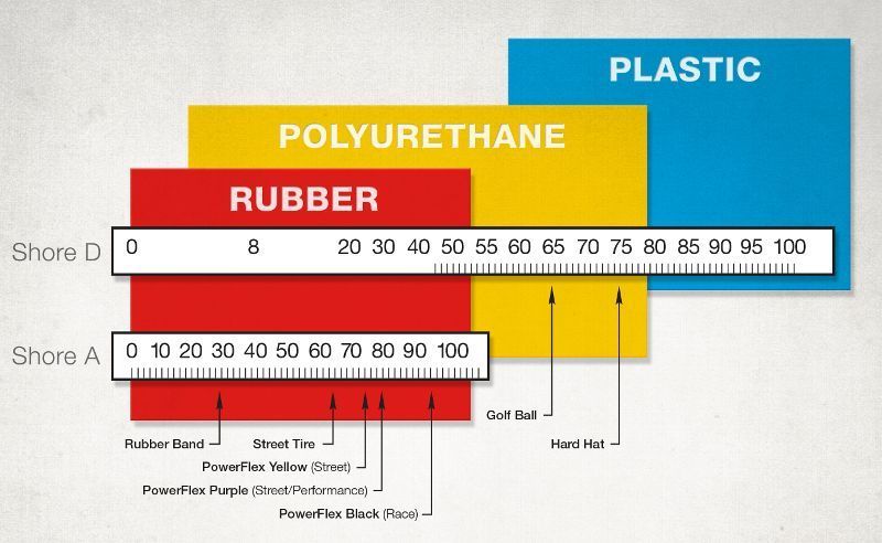

The shocks for the X300 series / range come in 2 stiffnesses, B4 and B6 for the stiffer riding supercharged and V - 12
The all-around suspension bushing densities is different between the models are different is well and measured as Shore A
Red (65A) / Yellow (70A) / Purple (80A) / Black (95A)
The terminology gets mixed up between the information sources
You can actually pour your own bushings with materials on E bay
The bushing access can be thought of in 3 levels A , B , and C with C being all of them including the engine mount
So you have to pick your target bushing and get the rest of them on that level while you have it apart

This from a old Bilstein publication

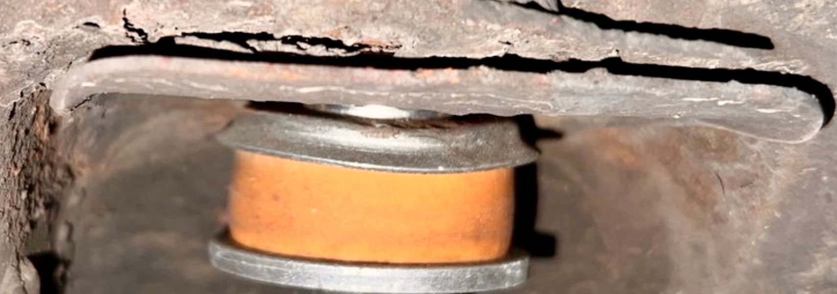

Looks like the correct part number, but yours doesn’t look seated/fitted correctly. There is a big gap on yours compared to mine.
In fact, I hate to say, but the top mount looks like it has rusted away a bit and the whole shock can move up and down…

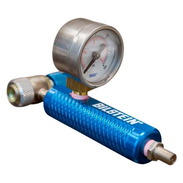

Your unloaded servicing air pressure is 180 - 200 PSI
The shock is under air pressure to start with so precautions must be observed

I would be inclined to ignore the vee mounts in the first instance. They can mess up how the car feels to drive for sure, but they don’t really play any meaningful part in bump absorption. Ditto the engine mounts.

it sure looks like the last bushing has not been tightened propertly (in addition to the mount looking rusty/delaminated), so that is going to make a racket over bumps - if you have the tubular spacer inserted as it should, you can just tighten the top nut down as far as it goes - the spacer stops you from overcompressing the bushings.
