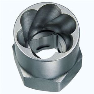

at Auto Zone in KC area , some in Florida
https://www.irwin.com/tools/screw-bo...olt-extractors
There are taller and thicker ones on the store shelf but they may be too thick

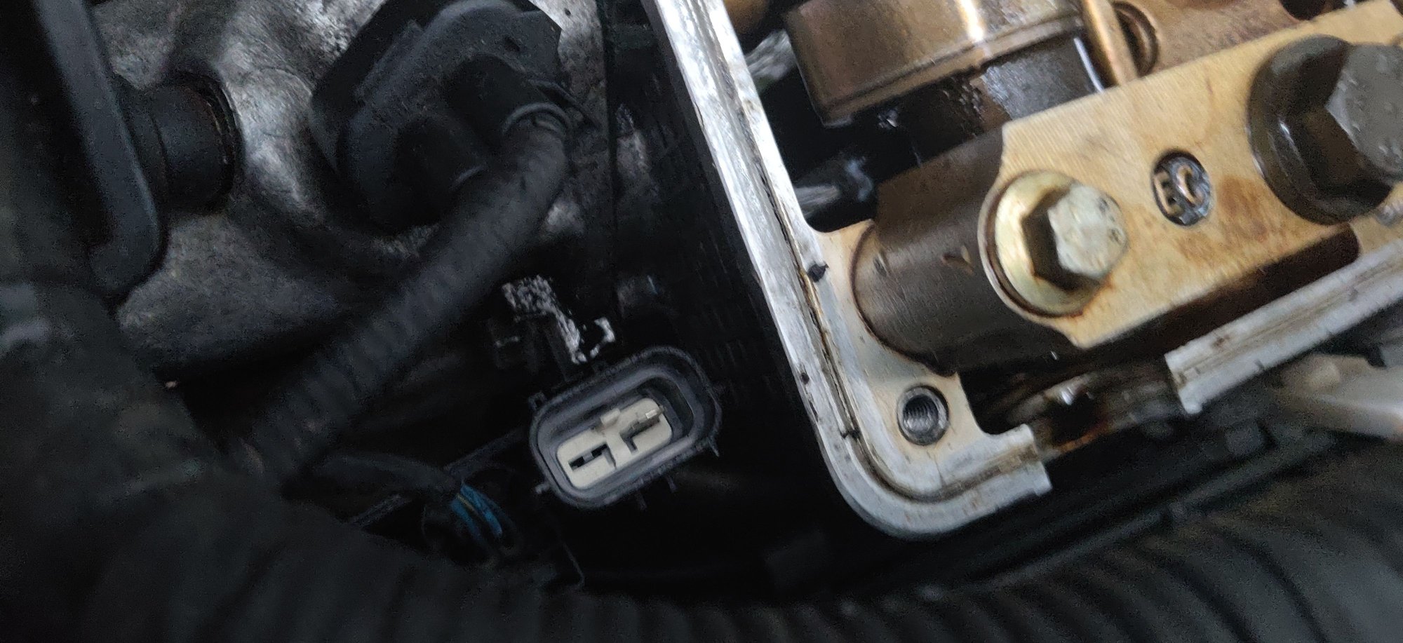

This one is in-between intake runner 3 and 4
This one is the last bolt on the intake closest to the firewall

On the left rear the non supercharger version is clear of obstructions . There is a coolant pipe below the head / engine block split
The 2 prong connector is to the starter solenoid and is on a bracket that in some cases relocated in the " Lamba Mod " that moves the 2 /4 prong O2 sensor connectors
Do not cross connect the O2 connectors on re installation
t
The top pic is from the center between cylinder 3 and 4 where the EGR valve and EGR temp sensor sit
I thought the superchargered version did not have a EGR
There was a change in head gasket part #s to resolve a issue , yours being a early 95
http://www.jagrepair.com/images/TSB/...%20Leakage.pdf

PS The extractor shown above by Parker 2 will remove (or snap off) any fastening known to man, and a set of them is a must for anyone who works on older cars. Dont be planning on reusing the nut/bolt afterwards though...
