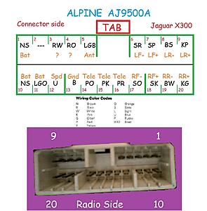

I'd like to remove the stock radio/cassette system on my just bought Jaguar and put a modern aftermarket one. Any model can work ?
Any hints on how to attach the new radio (wire schema) ?

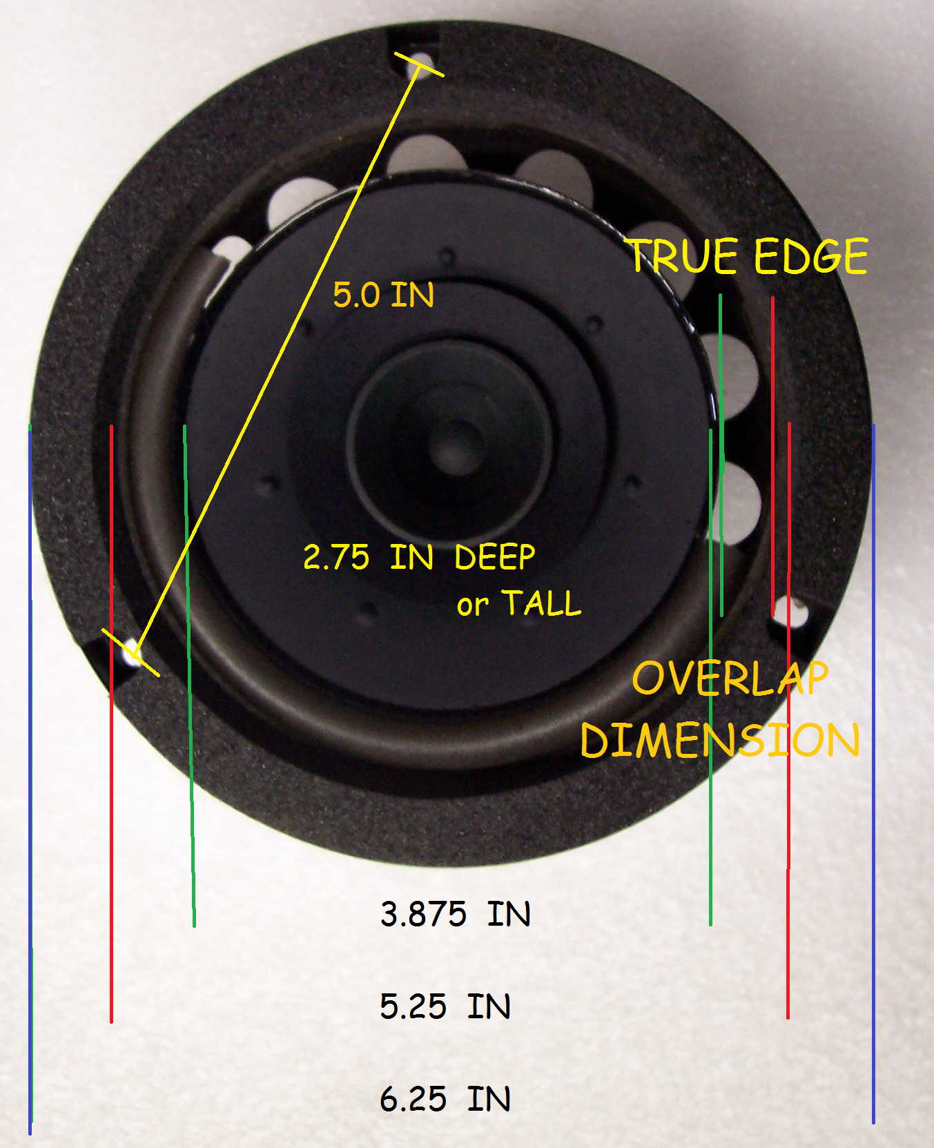

Look to see if you have the 8 speaker wires missing . If you do then you have the premium setup as the speaker wires come out of the trunk from a external final power amplifier .
Speaker Repair Video
http://www.jagrepair.com/images/Auto.../jagxj1996.pdf
Attached Thumbnails xj6 X300 radio-jaguar-x300-alpine-aj9500a-untitledvvvvv.jpg   xj6 X300 radio-jaguar-speaker-dim-untitled.png

The original speakers rot and look like in the pic and sound lousy .
