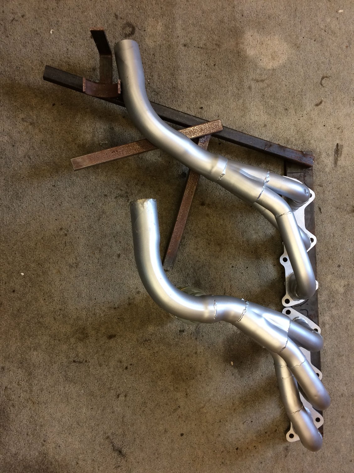

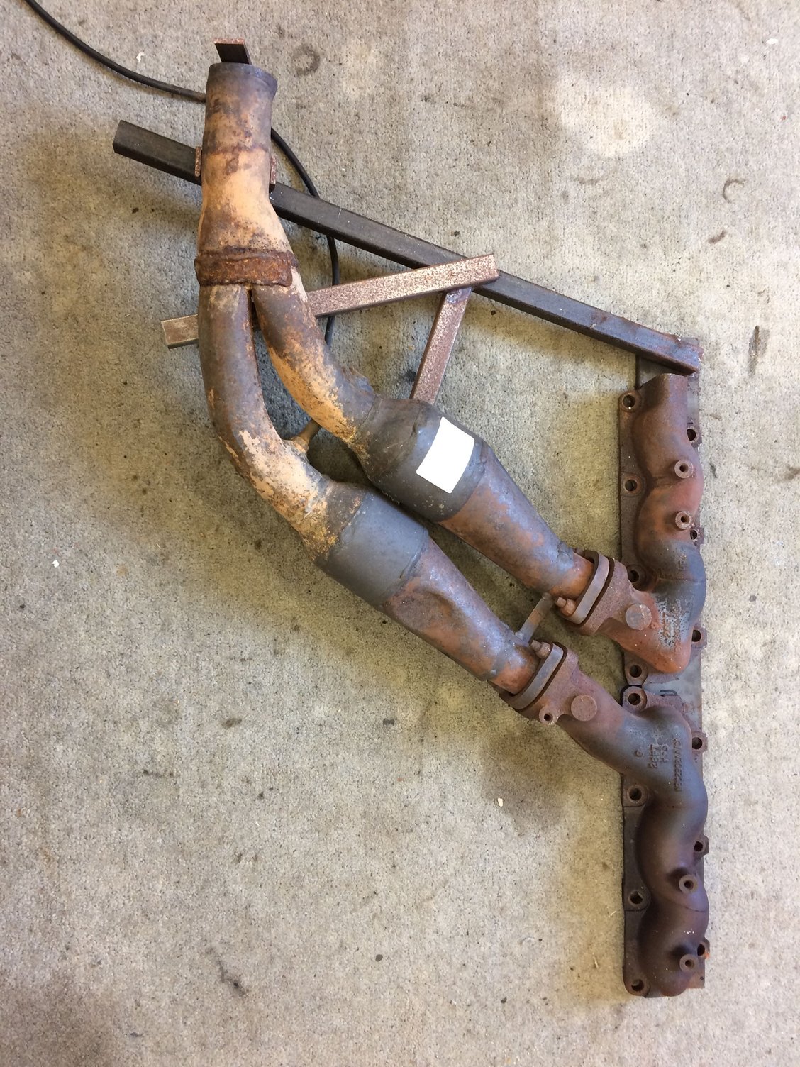

X300 exhaust manifolds and downpipes on homemade jig
Fabricated exhaust manifolds on X300 exhaust manifold and downpipe jig
I bought the fabricated exhaust manifolds advertised on ebay. I intend to fit proper oxygen sensor bosses into both "banks" of 3 cylinders, and join the two branches together to a single pipe that will then connect to a standard underfloor system. This will either be with a slip fit or olive joint. I had a jig made to fit a standard set of manifolds and downpipes, so it should be possible to complete the modifications , knowing that the end result will fit directly into an X300. Anyone interested in the finishes assembly should contact me directly.

Andy, do they match your pipe dimensions? Are you thinking of making a run of extractors?

No, this pair of fabricated manifolds do not match my own pipe dimensions. I'm just planning on getting these parts to a point where they can be fitted directly onto a standard under floor catalyst. I will add two oxygen sensor bosses, so that the standard sensors can be fitted. I would just need to know whether the user required an olive or "slip fit joint", before finishing the modifications.
