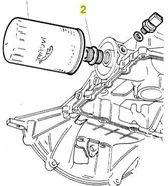

As already mentioned, the oil pressure sensor is mounted by the oil filter. It's shown in the upper right corner of this diagram:
Sensor failure is not uncommon, but sometimes the problem is just oil contamination of the electrical connector, so it's worth detaching the connector and flushing both the harness connector and sensor connector with zero-residue electronic spray cleaner such as CRC Electronic Cleaner. Allow to dry or use compressed air before reassembling.
Another less common but possible cause of your symptoms is damage to the sensor wiring. Rodents love warm engine bays and love to chew on plastic and rubber wire insulation.
You can connect a physical oil pressure gauge at the oil pressure switch port, although access is limited.
