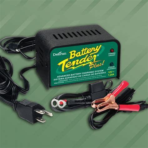

Many folks here know from my responses that I highly recommend a Battery Tender (that is company). There are other types, its your choice who you pick. The tender, as stated, keeps your battery at optimum level so after sitting for 2 weeks or 2 months, you hop in your ride and she fires up immediately. I have 2 vehicles (Jag and Vette) I use tenders on and can attest to the reliability of the product. My restore project Corvette sits for months before I start it and it fires on command. Corvettes are probably the, if not one of the, worst vehicles on batteries. So if your job has you travelling, like mine, for excess amounts of time or you just don't drive it that much, get a tender on it.

I learned a lot from this primer on batteries. Is there is favored battery tender for our XJ8 batteries. I am driving my car once a week and Id like to keep it topped up.

I drive mine once every week or two over the summer & never need a charger on it. By three weeks it's reluctant to start though.So I wouldn't bother with a battery tender if you're using it weekly.

Hey Hooli, (dang, that post is almost 10 yrs old and battery tech has improved) ..your correct, a Jag a least weekly driven should be fine and now with AGM batteries (which I got about 4 yrs ago) the length of the charge is kept longer, I've gone 3 weeks and it was fine.
As these AGM's age, I haven't seen any specific posts, but on my work vehicle, when that AGM has given up the ghost it's somewhat immediate. This all in turn depends on how the owner has maintained their battery, wiring and grounds and what weather conditions they face and if they store it for the winter. At the time of the original writing I had a basic Die Hard which was 7 yrs old and I maintained it another 5 yrs using a tender. I myself used to travel extensively and for long periods, up to 3 months, so a tender was necessary in my particular situation. I have an older Corvette I use a tender on as well since it is in project mode and Corvette's can be a battery siphon.

Hey Len, long time brotha...
I use Battery Tender units (I have 3), they are standard and AGM battery compatible. The tender, as said, is not needed unless your gal is sitting for a bit...with the AGM I'd say I wouldn't apply it unless it's not going to be driven over 3 weeks or driven only about once every 3 weeks. This will prevent cell damage. The Battery Tender will come on red and overnight slowly trickle charge to green at 13.4v. It will cycle, allowing the battery to drain down to about 12.6v (power drawn from items such as the security system, clock, radio memory, etc.) and trickle charge again.
Here's an old post on my setup in a conversation with WaterDragon wanting one for his mother, start with Post #31.... https://www.jaguarforums.com/forum/x...-240156/page2/
I've never used the clamps, both my vehicles are setup with the removable split plug where the other half stays secured on the battery.
