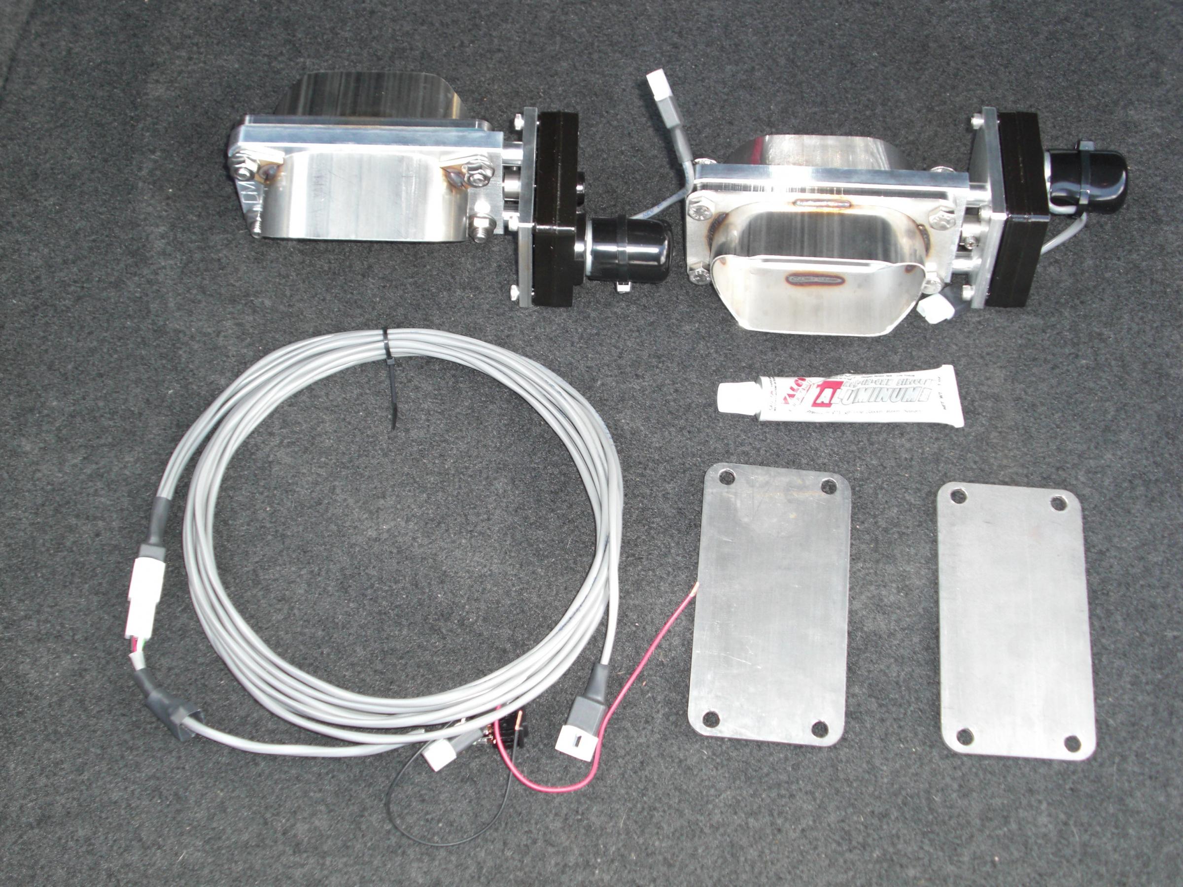

Best mod I have ever done to any car, ever.
Search for "electric exhaust cut outs" for more info.

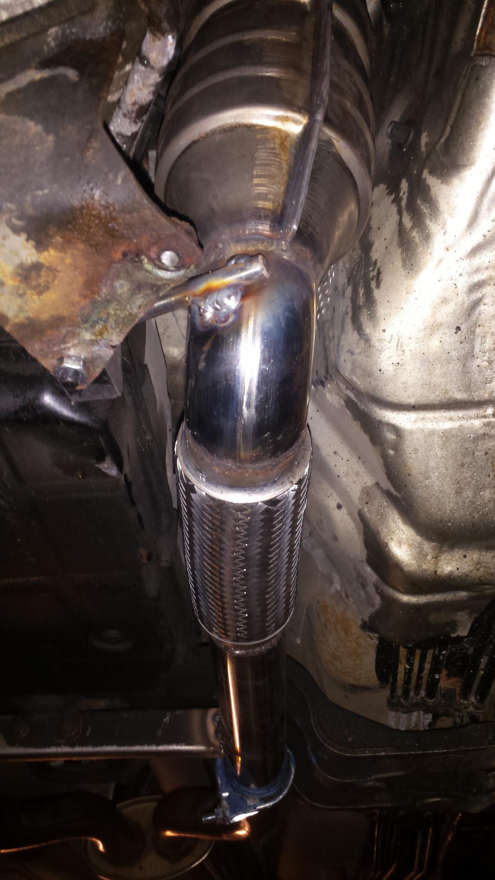

Ok, Sports Cats are fitted and I'm pleased with the results, seems a more positive pull from the car now. I've uploaded 2 videos, the first shows my speedo 50-90MPH in 7 seconds, the second video shows the same speeds but a second quicker. It actually now takes 5 second to pull from 50-90mph but for some reason the video buffering adds another second to both videos. My old Cats must have been in poor condition.
One thing which I'm not sure if it's anything to worry about, the chap that fitted them advised me the left-hand exhaust bank had a lot more black soot in it than the right-hand side which was near enough clean. Now 1200 miles ago my right-hand bank suffered from HGF so the water could have perhaps cleaned that side, but it was a while ago now, what do you guys think?

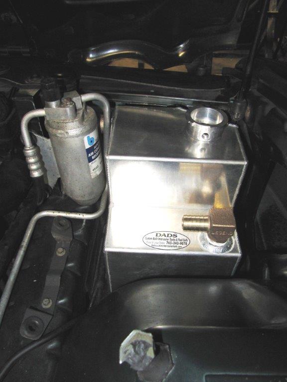

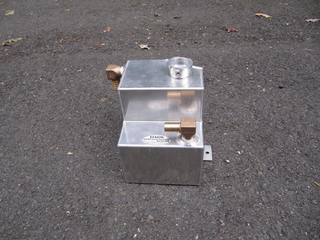

If you are going to do an upper or lower pulley add a reservoir tank to the intercooler circuit to reduce heat soak.
Attached Thumbnails Calling exhaust and cat mod owners-img_2594.jpg   Calling exhaust and cat mod owners-img_2599.jpg   Calling exhaust and cat mod owners-img_2602.jpg   Calling exhaust and cat mod owners-img_2603.jpg

Whats the ticket on that Tank?
Old Jan 18, 2014 | 05:07 AM
  #33
rocklandjag's Avatar
Joined: Nov 2009
Posts: 753
Likes: 220
From: New York state
I had it made by Dad's Tanks from my drawings. I moved the filler for the washer tank up in front of the A/C dryer. The tank is plumbed into the intercooler circuit at the pump. Holds 6.5 quarts of coolant to provide additionally cooling capacity and delay heat soak. Pump is stock
