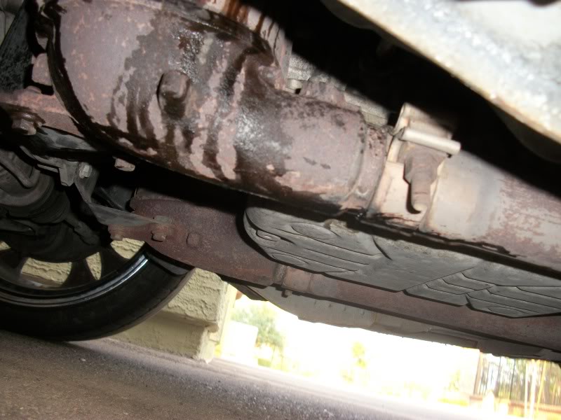

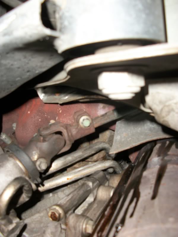

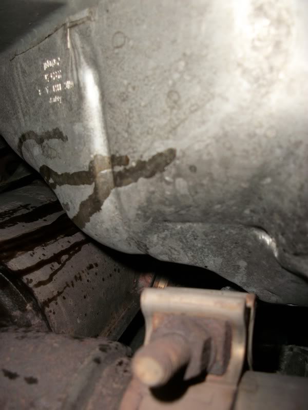

HEY GUYS CAN YOU HELP ME DIAGNOSE WHAT IS LEAKING COOLANT IN MY CAR. I AM AT 91K MILES AND BEFORE I TAKE IT IN I WANT TO KNOW WHAT TO EXPECT. THE LEAK IS COMING FROM BEHIND THE DRIVERS SIDE WHEEL AND IN THE MIDDLE OF THE CAR. WILL ATTACH PICS. STARTED HAPPENING RECENTLY AS I HAVE BEEN USING THE AC A LOT WITH 110 PLUS TEMPERATURES IN AZ. ONE THING TO NOTE AS WELL IS AFTER I TURN THE CAR OFF A FAN SOUNDS LIKE IT RUNS FOR A GOOD 5 MINUTES, BUT MAYBE THAT IS NORMAL OPERATION FOR THESE TEMPERATURES WE ARE FACING..THANKS IN ADVANCE!

The fan running a minute or even two is not unusual but 5 minutes is. Are you keeping the coolant topped up with the leak?
The best way to find a coolant leak is to 'rent' a pressure test set from any of several auto parts stores that do that sort of thing. Working on a cold engine is a lot easier than when it is hot and leaking.
The coolant reservoir is famous for leaks as is the Norma connector on the hose to the climate control system.

THEN pump up the pressure with the test kit and see what else leaks. Both the reservoir and Norma connection leak in the same spot onto the top of the cat converter.

thanks for the info...sooo in the first pic i provided it shows coolant leaking onto the cat converter? thats what that is?

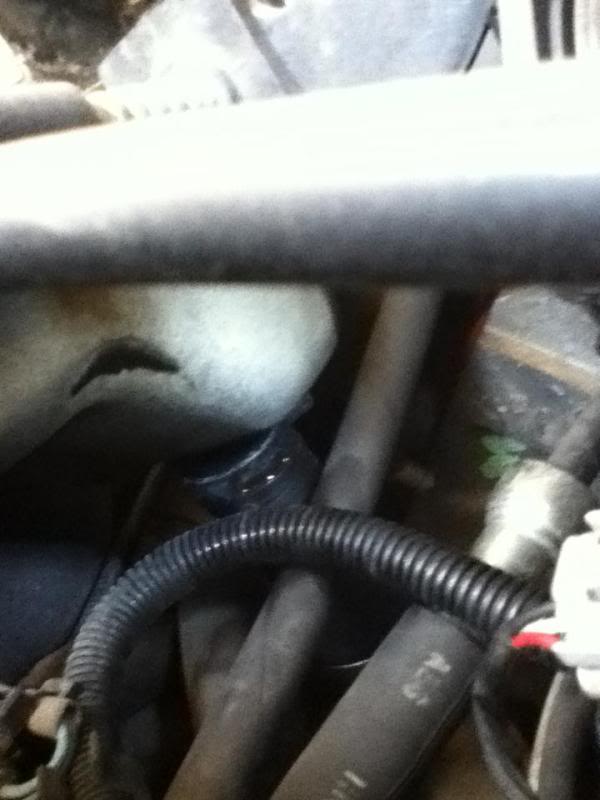

removed the cover to the expansion tank and the hose and clip coming out from the bottom of it do show signs of being wet with coolant. not a huge amount of wetness for what i see dripping when i turn my car off, but it is there. should the clamp be replaced and the hose?

The plastic cover in the middle ... behind the engine at the firewall ... held on by one of the plastic push in things. Once you remove it .....You can see the hoses and the tank/connections.
Any number of connections could be leaking -- you may get lucky and it could be one of the clamps.
The drain on the front is another story -- you will have to remove the plug and inspect ....... and the coolant will obviously come out.

inspected that area yeldogt and in the post above yours i posted a pic...to me it looks like it is the expansion tank hose or that clip that holds the expansion tank hose on..that is the only spot i saw wetness, but i am far from an expert. i did already replace the expansion tank hose less than 2 years ago...no clue if they did the clip...will have to take her in either way to get it fixed..thanks for the help

I'm not seeing the tank in the picture? Maybe the flash is making it look a different color?
It is a bit difficult to see where a particular leak is coming from in that area - so many things can leak. Especially if any of it has been disturbed.
In my experience the original hose clamps rarely leak unless they have been removed or played with .... so it is normally a cracked tank or the plug in connection. The small plastic coolant tubes can also crack at the connection point at the tank and drip down around the tank making you think that that the tank is leaking. The tanks do crack so it could be the tank. Also -- when they replaced the hose to the tank did they just fix that hose or did they replace the whole hose assembly? Did a Jaguar dealer do this? If they installed a bunch of new hose lamps -- i would check to make sure all are installed correctly -- don't just start tightening them -- you want them snug -- don't overdo it.
You can try to dry it all off and then place some paper towels in that area to see if you can determine a leak -- careful to not set them on fire. The pressure test will quickly show you the problem area
