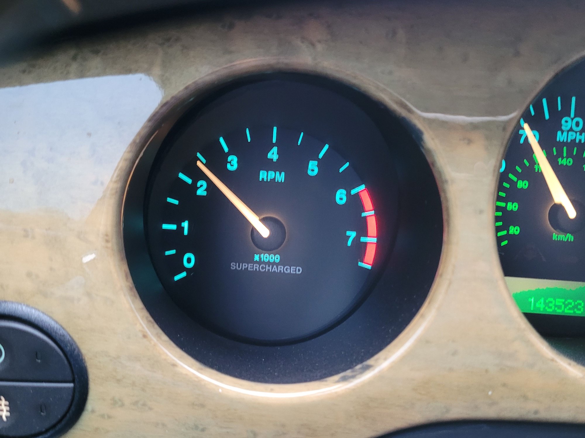

2001 XJR, no modifications. At a steady 70 mph my tach s showing just shy of 2500rpm...call it 2450-ish?
